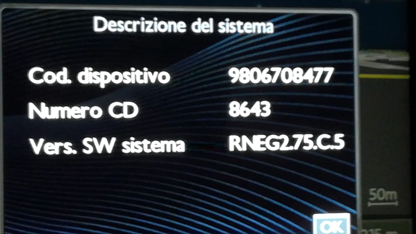

EDIT:
We found an old photo of the software Can you suggest anything?

Is there any chance that by reinstalling the firmware in the photo, the car won't need to be reconfigured?

Ok, so the version you have is V2.75 and that I believe is an original factory-installed version, so not available.
But my info suggests with this version, you can go to V2.80 without any problems, so you already have those files int he link I gave you.
How did you manage to get the image above? Do you have the display working? If so, before starting, use Part A of the Mirascript guide to backup the user data files whilst you still can.

Unlucky this photo is from 2020… when tried to updated map. Now the screen is dead.
