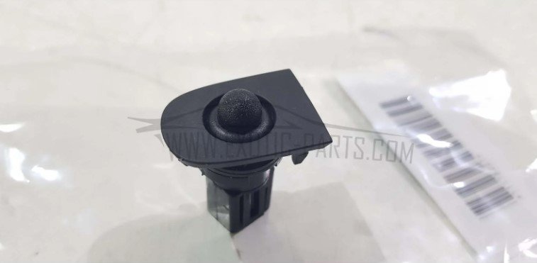

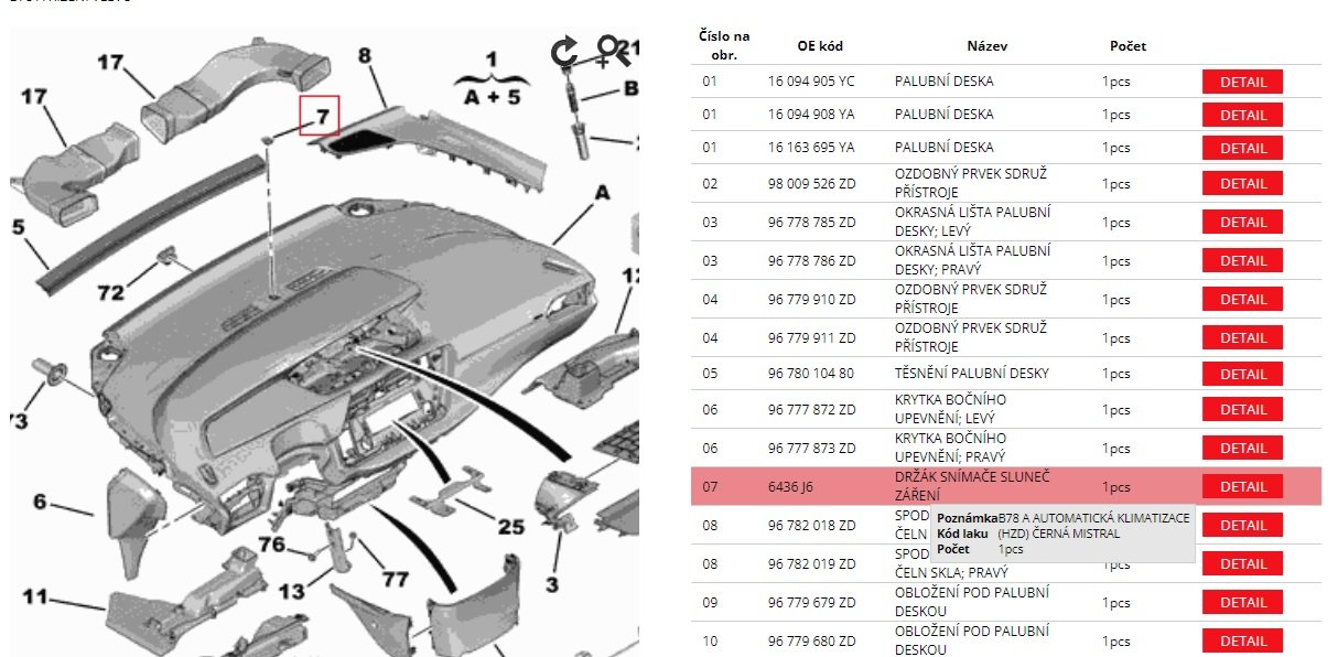

Hi, does anyone know what the light sensor on the dashboard is for?
It's that little ball behind the speedometer chapel.
I was doing an automatic headlight calibration via diagnostics yesterday and the live readings of the light conditions are taken from the cluster sensor by the mirror (with rain sensor).
I could not find the readings given by the small sensor behing speedo anywhere.
Sun sensor

I believe it's supposed to detect if the sun is shining strongly, and it turns up (down?) the A/C to make it colder to counteract the sun shining in.

Re: Sun sensor
That makes sense. Thank you.

Re: Sun sensor
Yes, it detects the angle and intensity of the sun hitting it for use in climate control systems.
