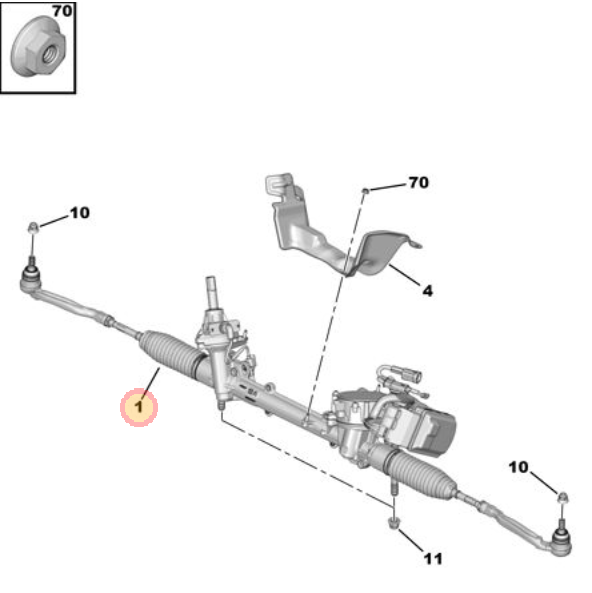

- x 6945
Re: Will a Lift Steering Rack Fit a Pre-Lift Citroën C4 Grand Picasso 2016? Persistent Steering Noise Issue
I can't help you with salvaged parts as they are all different depending on engine, model and options.
However your own rack details are as follows:
(1) Electric Steering Mechanism, part: 1635675480, £2264.88.
Bear in mind these have the ECU and electronics built into the complete rack so are sold as a complete unit and therefore you need to ensure you have the correct part number. You can at least use the right part number I've supplied to source a second hand one.
Hi Marc,
Thank you for the quick reply and the information. It’s very much appreciated.
It looks as though there are some salvaged racks from C4 Spacetourers with the same part number – so that’s good.
Hopefully I can source a decent one soon and get it installed.
Thanks again for your help.
