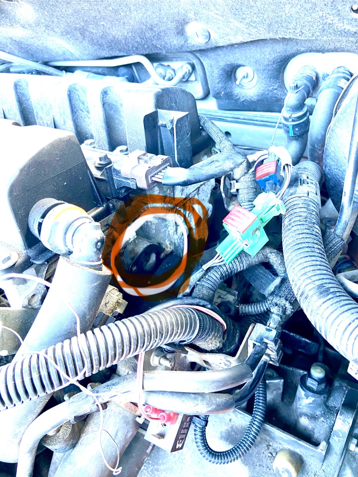

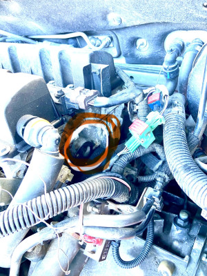

Right above the flywheel, there is a hole that has had something attached with two screws, I need help to identify what it is so I can look in the garage for it.

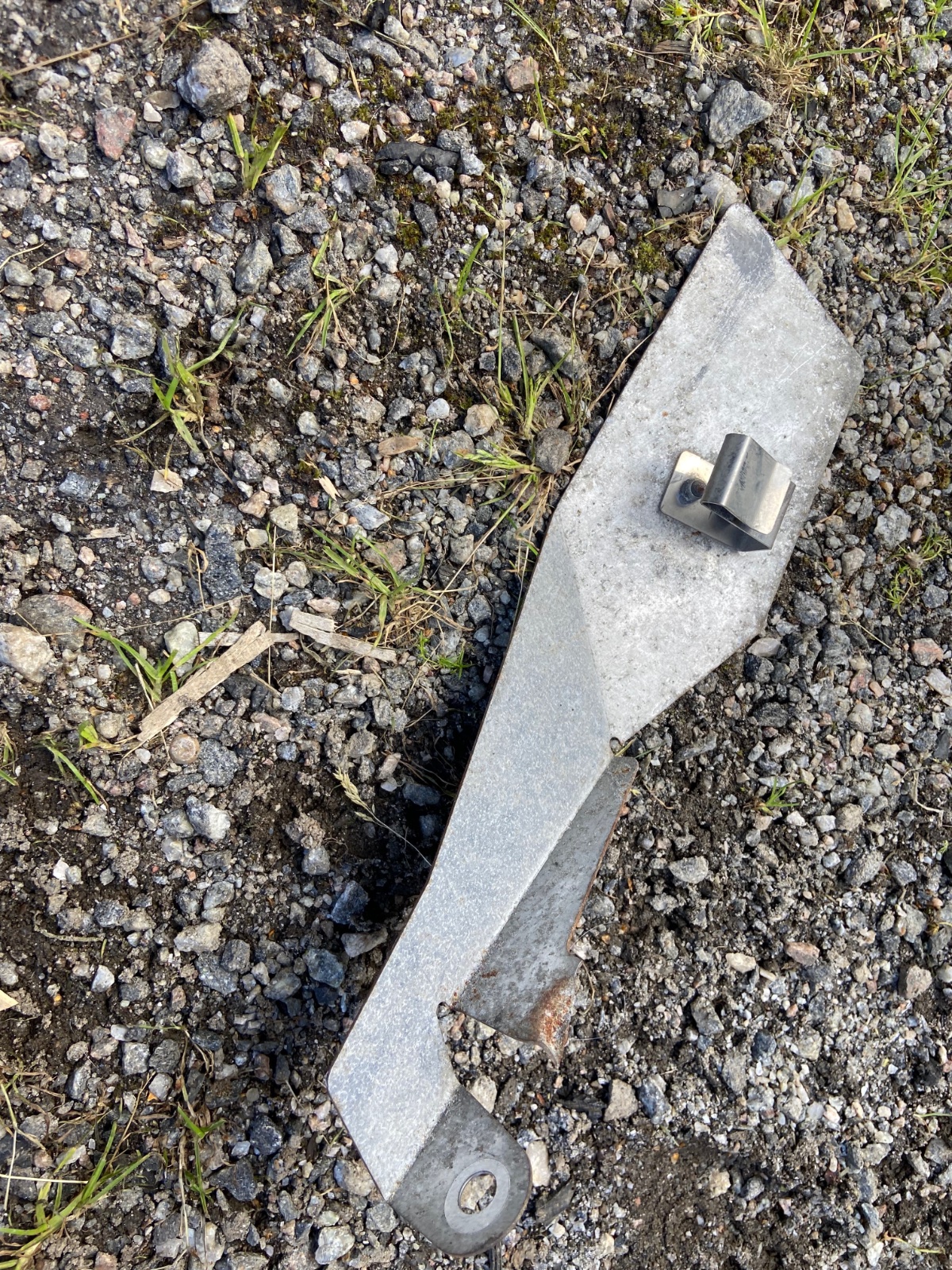

The other part is a metal sheet that looks like it is a heat shield or something, but I need help with where it should go.

The hole on the cylinder head is not used on anything on an 2.0 litre RFJ EW10A which is in the picture.
Was used for secondary air injection on Mk1 C5 and all others with RFN EW10J4 engine.

The heat shield i don't recognize. And it doesn't match anything in Citroën service.

I can't locate that part sorry, so can't help with that and you've got your answer for the other part from Citroenguy.

Forgot to ask. Is it supposed to be open or is there a lid or other that is supposed to go there and block?

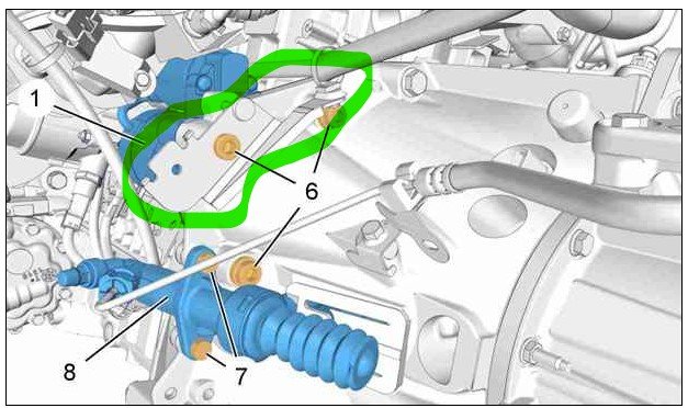

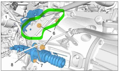

I'll go for this bracket here? held in by one of the starter fixings.

No, nothing goes there..Cittotraang wrote: 10 Aug 2024, 16:53 Forgot to ask. Is it supposed to be open or is there a lid or other that is supposed to go there and block?

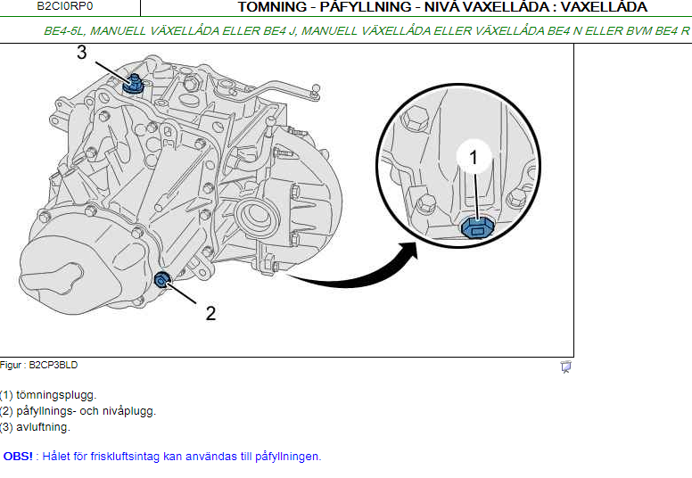

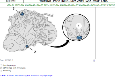

Gearbox takes 1.8L of 75W-80 GL4 oil, and no Biltema doesn't have it.
Otherwise you can always check mpmoil.se
Edit:
Fill gearbox via the fill/level plug, accessible from the wheel whell

Fill plug:
