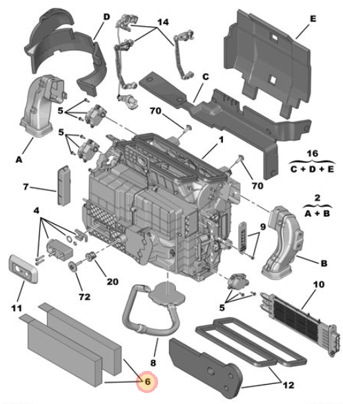

Do I understand correctly that I have to remove the battery to access the filter? I can't access it via the box on the passenger seat?GiveMeABreak wrote: 29 Jul 2024, 11:02GORAX wrote: 29 Jul 2024, 10:43 Hi,
Where exactly is the cabin filter located? I want to change him.

Re: C4 Picasso II Pollen Cabin Filter
On your vehicle the pollen filter is accessed from within the cabin: See this step by step video for a left hand drive vehicle:

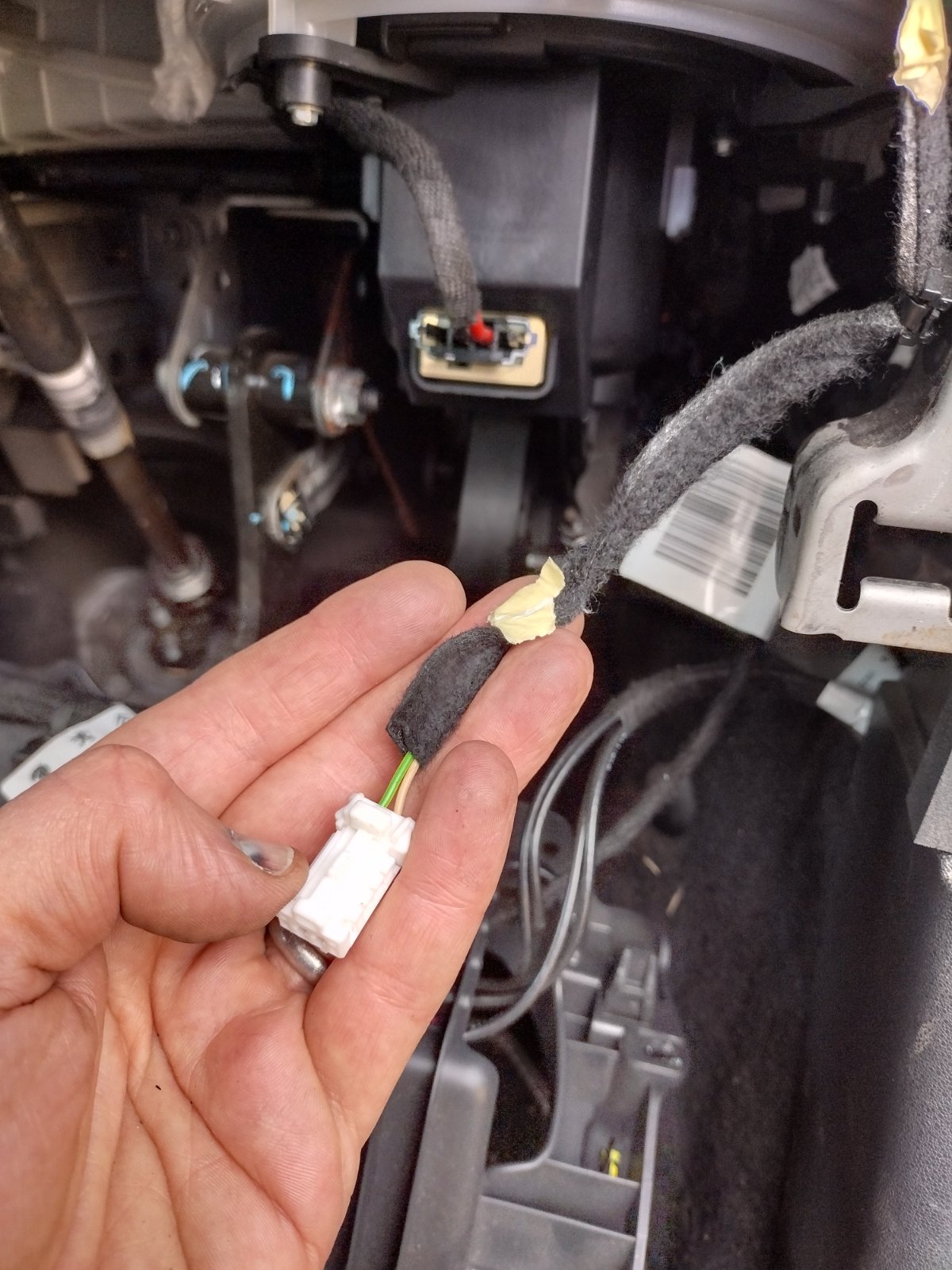

Have just done the filters on ours - in the parts thread Gorax you asked about the connector for the footwell light, so I took a picture. It may be there tucked away on the dash structure.
Thank you Richard! I have order new light and try it.
