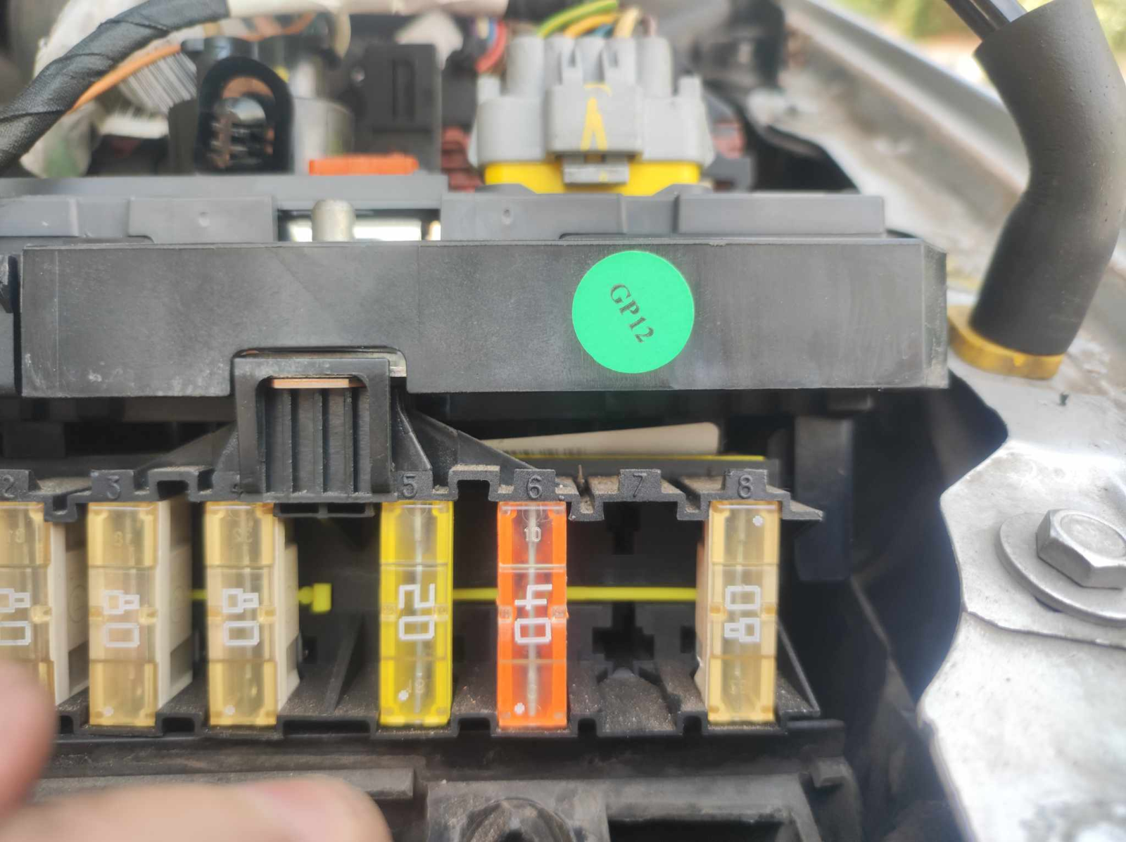

I presumed it was due to the leaking and there was not enough LDS in the tank so i tried to put 1L but nothing changed. I've checked the big fuses and none of them seems blown (see picture). Is it possible that the leaking tank stop the pump from functioning or is it another problem (hydraulic pump dead?).

Look at fuse again, pull it out.
It may break just halfway, so it looks okay but its not.
Happened to me.
Happened to me.

Best to test them if they are suspect as they can appear to be visually OK and the break is not visible.

Hi,
look at this post, please.
viewtopic.php?t=82252
I had some problems with it some time ago. There are more than one box with fuses responsible for the LDS pump.
Hope this maybe helpful

@pi14 i've seen your answer and it helped me find the fuse but i couldn't get it out completely and from the above it didn't seem blown. As the other fuse i'm going to check it tomorrow with the multimeter and i'll let you guys know. Does the green 40amp fuse looks different when it's blown or i have to take it out and look under it to see it ?

As for my case, it was done by the mechanician and I had not seen it, but....
He claimed that this fuse was not completely blown and it was conducted some electricity. There were no errors. And this was misleading making the long way to fix it. At the end the fuse was changed and suspension, with the pump of course, came back to life.
Best
Best

I have news, i tested with the multimeter the big 40AMP fuse is not blown but it seems like the green 40A fuse hidden is blown. I'm going to order new ones and i'll let you know.

It was the 40A green fuse that was blown i changed it and the car went back up. Thanks everyone for your help
