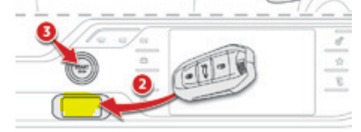

It's all in your vehicle manual:
Place the electronic key in the reader in yellow below:
Switch on the ignition by pressing START/ STOP.

Re: Keyless not work
I've tried this several times but the problem still exists. When I start it always says key not recognized.

Don't try pressing the start stop button first.
Get in the car shut the doors, then place the fob in the reader, then press the Start button. If this doesn't work then try a BSI Reset / Battery Disconnect / Reconnect Procedure
