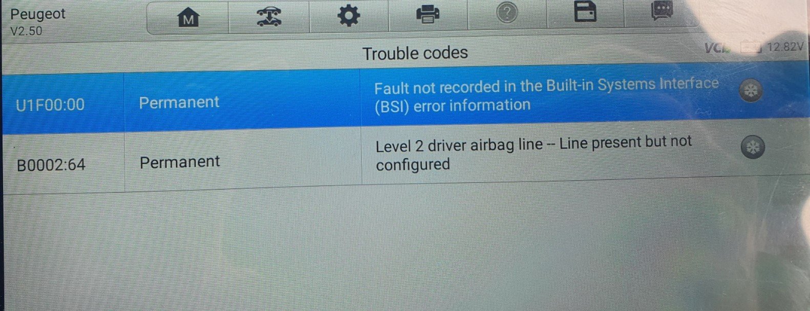

Hi I am getting an airbag fault B0002:64 Permanent Level 2 driver airbag line--Line present but not configured. comes on after I switch off and on again.
also only been present since using token on diagbox to reinstate active cruise after a crash.
Any help much appreciated
x 6963
Re: AirBag Fault B0002:64 Help Please
You can't reset these after a crash - it needs a new airbag control unit.

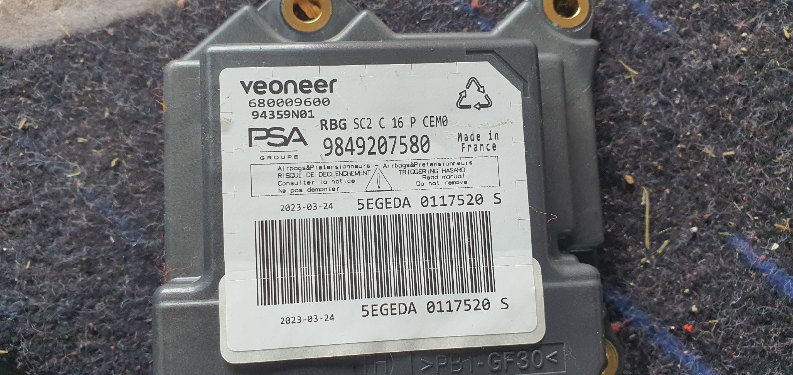

Unit is a Veoneer 9849207580 for a Mokka E Ultimate
x 6963
I don't have anything for a Mokka - and many later vehicles don't have configuration info for the Airbag unit as they're supplied pre-configured now (as they're supposed to be replaced after crash lockout).
