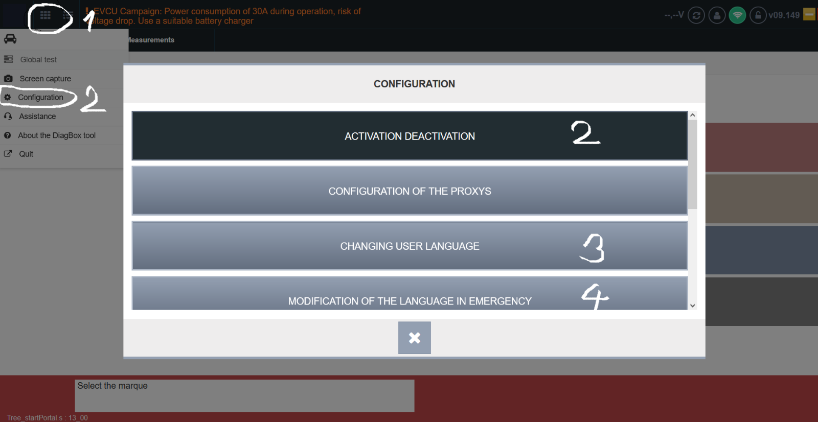

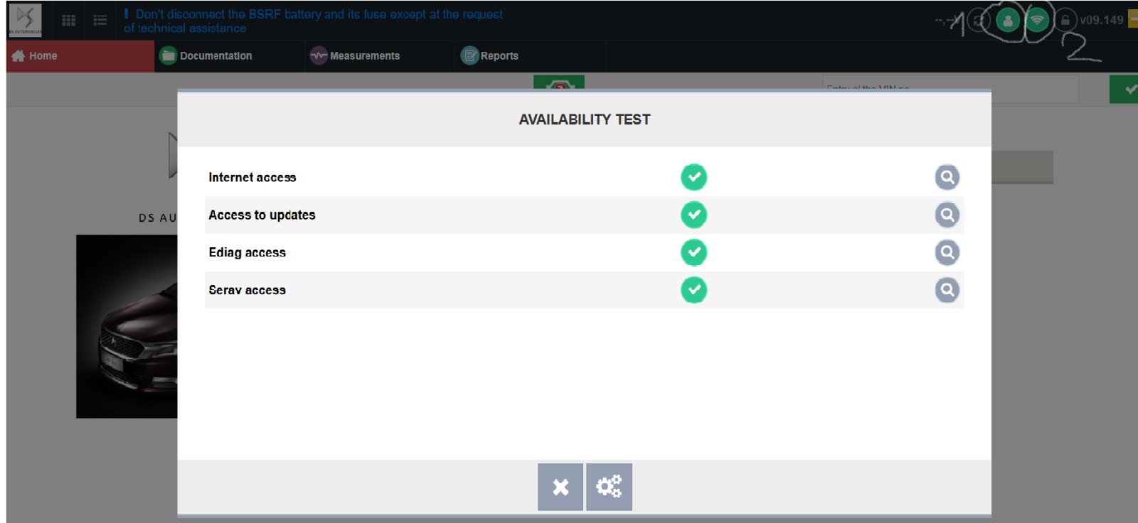

First you have to activate diagbox to work with token (using X_ _ _ _ from your PSA account) then fill out forms address etc, then change language and language in emergency for English and restart Diagbox for changes to take effect. Then login into desired brand (AN _ _ _ + password for https://public.servicebox-parts.com), and at the end click F12 to do a connection test

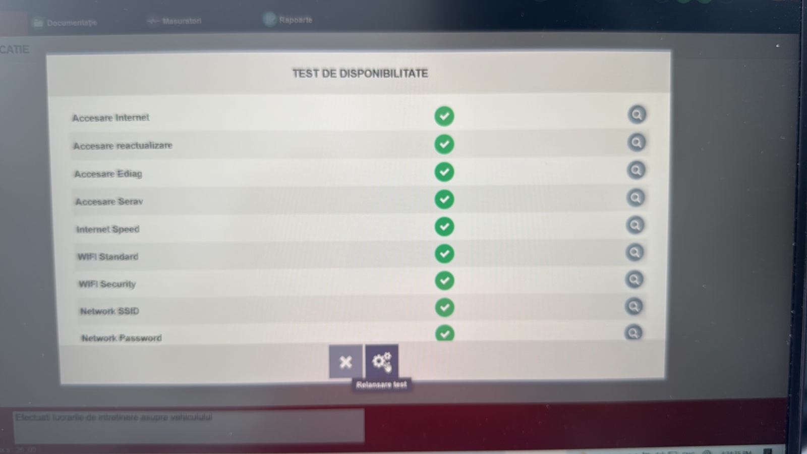

Hello, I spent about 3 weeks installing diagbox, but I always encountered the same result, after the diagnosis is over, it goes to the main menu and nothing is clicked here. When I do the connection test, the ediag and serav part remain unanswered, and the others have a check tick. First, I tried my own personal pc to install, antivirus and firewall did not allow it, I got an incomplete installation error, then I installed it by deleting the firewall without antivirus on another computer where I installed completely cleanly. After that, I saw that you finished the global test without any problems, but after it's over, nothing is clicked, I activated it with a token.
When I click on the user login panel and log in, it becomes green, thinking that I made a mistake in the password, my username IS AN... and I changed my password, it didn't happen again, I made my token code the same with the site login code (because I'm not sure which password you want) again the same result is clicked on anything. By the way, after activating the token, it seems on my service box screen that I still have not started to use it, what I may have skipped, I am grateful for any help, thanks.
