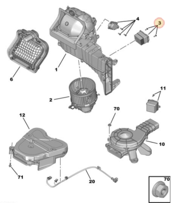

Re: Is it possible to test the cooling fan via lexia?
This part's a favourite for failing on the C5, No3 in the picture.
