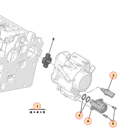

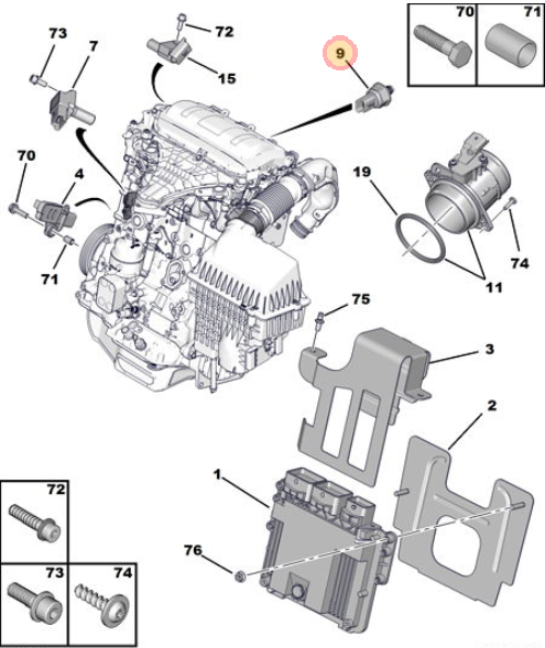

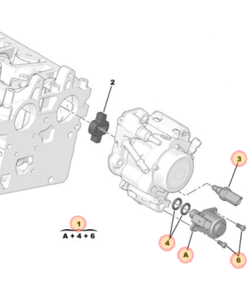

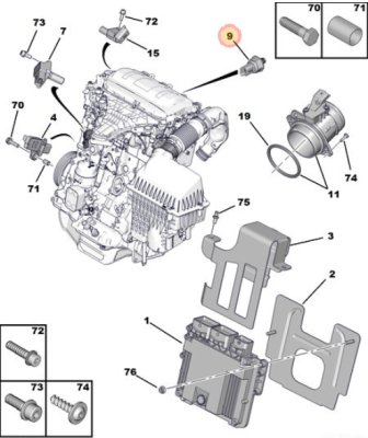

Re: Ds5 diesel hybrid 4 fuel issue
Assume you're asking for the parts
(9) Diesel HP Sensor, part: 9814383880, £73.72
(1) Fuel Pressure Regulator, part: 1638151580, £171.78
(3) Fuel Temp Sensor, part: 1920NH, £77.14
