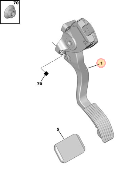

Ok, a bit complicated as these differ on both the build dates, Engine ECU fitted, left / right hand drive and then of course whether the cruise and speed limiter were fitted or not.
Having gone through the 20 options (!), the one that would appear to be for your build date, with Sagem ECU, LHD and for cruise and Limiter is part: 1601Y4, £243.17
Don't forget you will need the buffer pad (5), part: 160606, £18.74, for kick down to override the speed limiter.

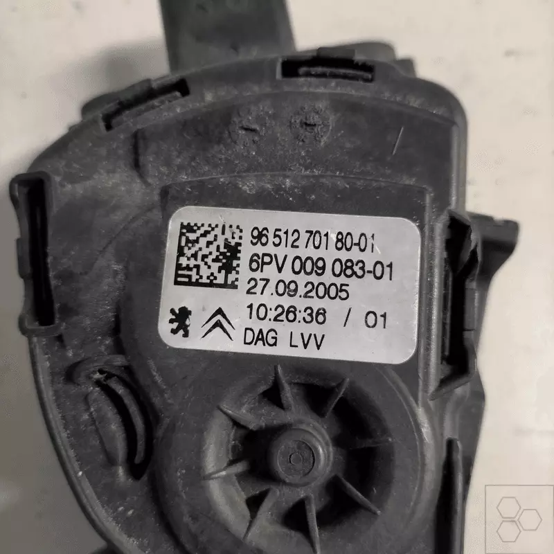

So for example, would this be the right part? The seller states it is 1601Y4.
- x 6957
Re: '06 C2 1.4l correct accelerator pedal part number
I can't help you with that, sorry as that will be the international part / manufacturer number and not the PSA designation in this case. I can only advise as to the Internal PSA part number listed.
If the seller has confirmed this, and you have told him it must match the same PSA number with the same functions, then you can try it and send it back if not working. Or you could ask him for the VIN of the vehicle it was originally from, and I could cross reference it to see if the same part number is shown.
I notice that pedal has LVV on the label, if it remember right this is the French abbreviation for Speed limiter.
That's what I've been thinking as well. I've also seen pictures of pedals with the same numbers and they clearly have the kick down switch.wheeler wrote: 28 Jun 2024, 15:54 I notice that pedal has LVV on the label, if it remember right this is the French abbreviation for Speed limiter.
