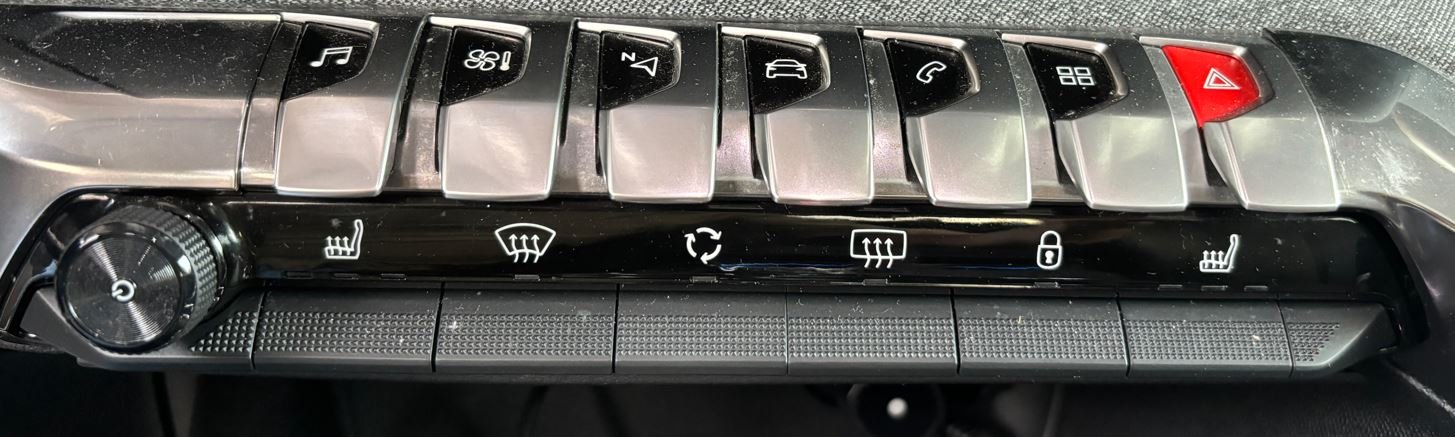

Re: Air conditioning blower fan working at full power and central switch panel not responding
Which switch panel? and which specific buttons were not working? A picture may help along with the VIN.

The central switch panel -see pic, all buttons not working (apart from the hazard warning and central locking)
In that case no, there's likely something else going on. Check the rear connections, but it really needs a diagnostic to determine if it's the control panel or something else.
