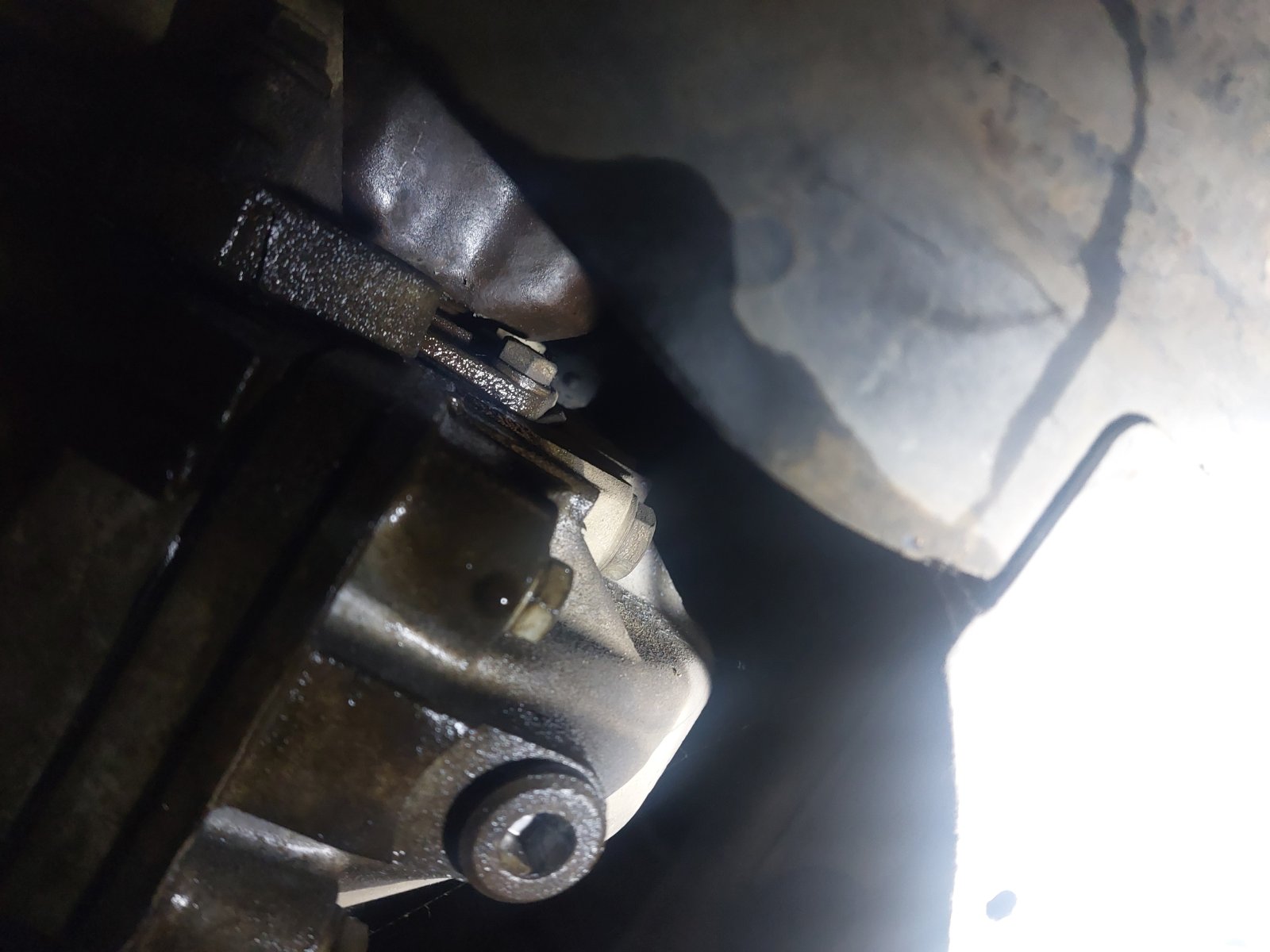

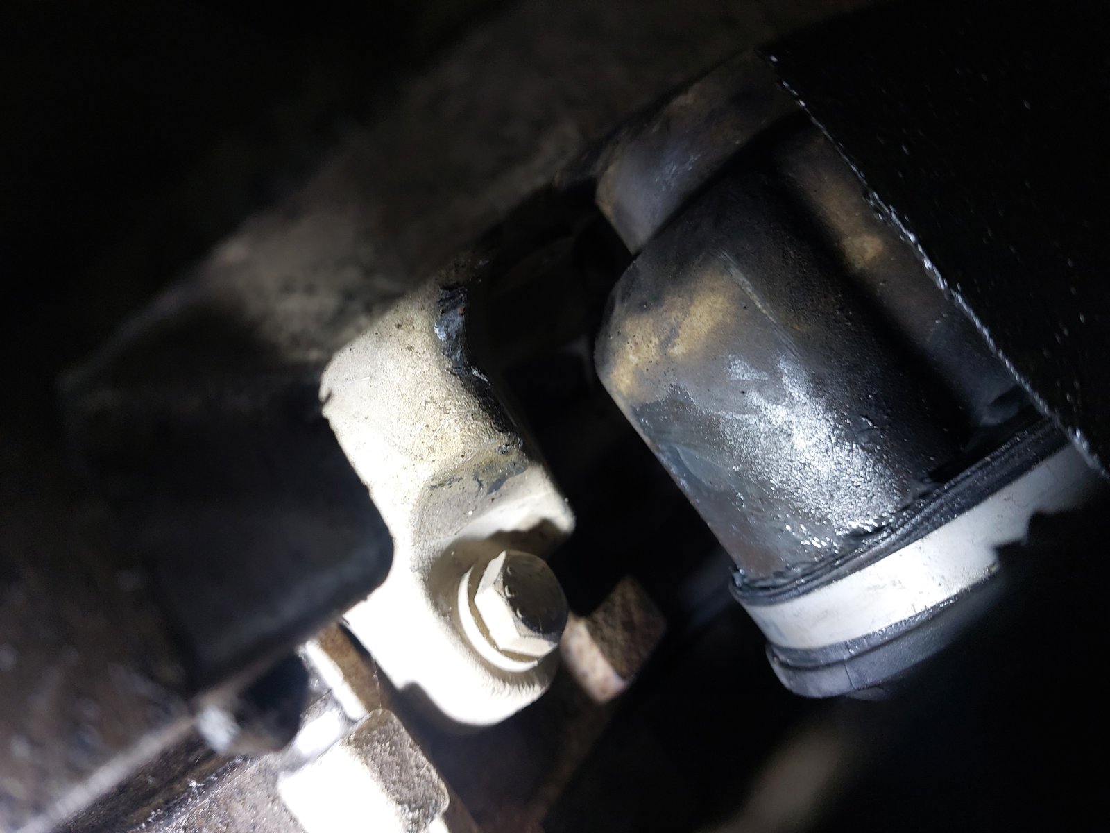

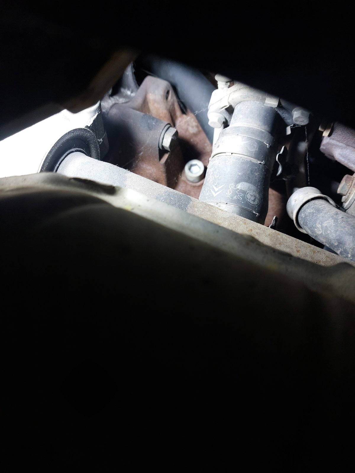

My right hand side one did separate as I couldn't get the other half out but both seem to be in. as far as I can see they are all in place when, I spin them by hand it doesn't make the noise.
I can see any obvious gaps left hand is flush with the diff right seems to be OK also
