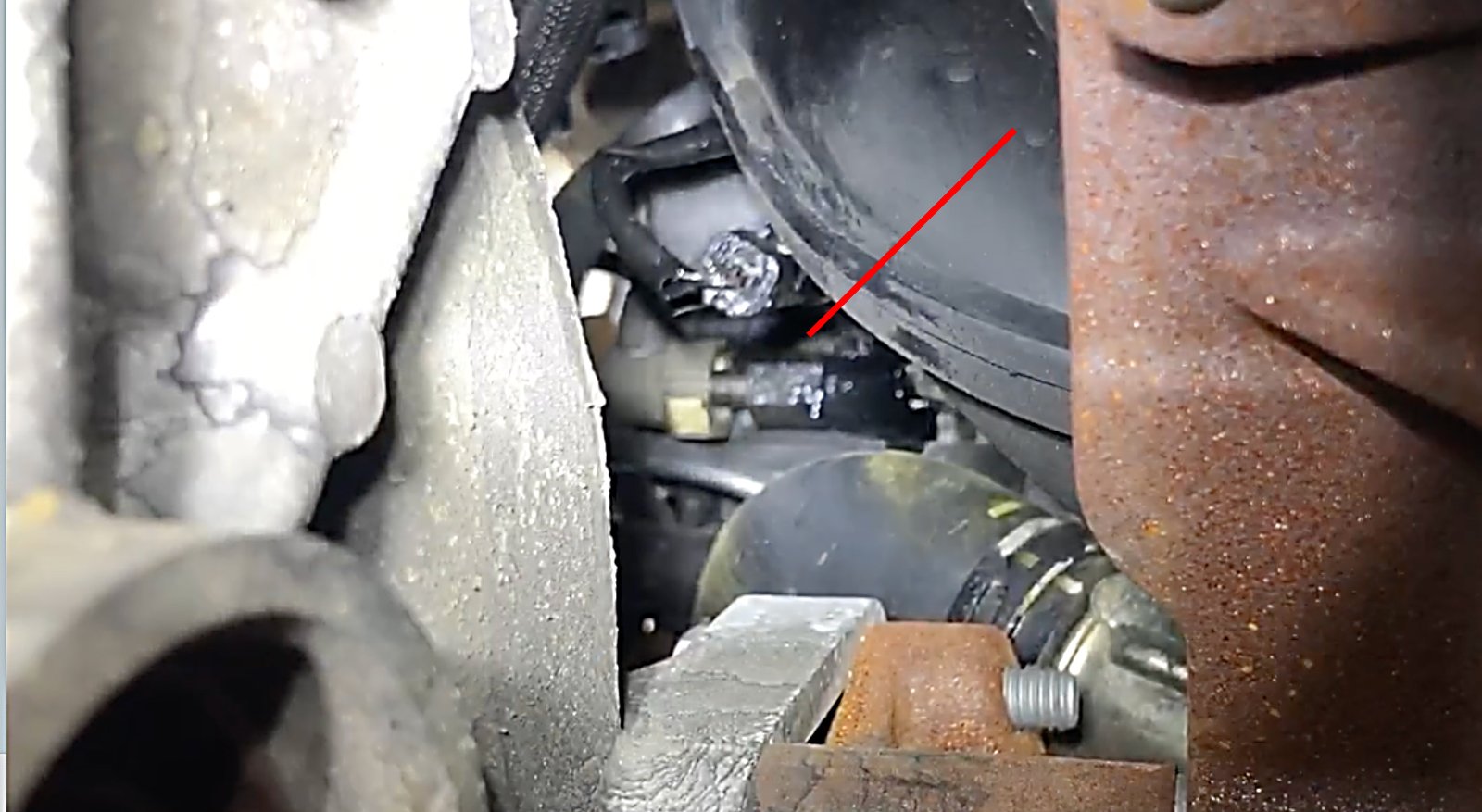

When I was underneath the car doing the engine mounts, I noticed that the bottom of the auto box was covered in oil. I determined that it was engine oil and with a torch I could see some fitting that is basically under the air filter box. It has some sort of grey connector on it.
Does anyone know what this is as I suspect I may need to order a new one.

It's hard to see because it's hidden by what I assume is the air filter trunking - but it's located above that connector that you can see and it leaks oil onto that connector and down onto the autobox.
Does that help at all?
Many thanks!
x 6956
Re: Something leaking oil - C5 X7
That's really hard to make out from the small picture and angle, sorry, but possibly the turbo side air union.

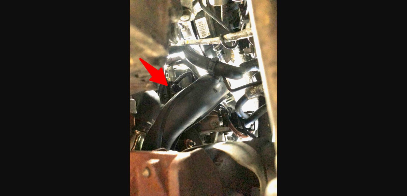

ImageSo I pulled the air filter box out today but could not see what the fitting was that was leaking - so crawled underneath again hopefully for a better photo.
Can anyone identify this culprit - I think it might have to be a garage job as access is really difficult :(
x 6956
Sorry, I can't make it out myself...
Unread post by Steve Walsh »
I can't make it out either, Offer of car lift still stands

So finally managed to get the Citroen docs to run and I think it's the High Pressure Fuel Pump that has a leak as the grey connector is exactly the same as that fitted to the fuel filter so I assume that this is the low pressure feed. I had 'assumed' that it was engine oil that was leaking but pretty sure that the fuel pump doesn't use any so it must be a very slight diesel fuel leak on the low pressure side. The connector that you can just about see covered in the muck is the fuel temperature sensor.

Which engine is this ? Some 2.0 HDi engines did leak oil via high pressure fuel pump in to the environment.

kantica wrote: 20 Jun 2024, 08:04 Which engine is this ? Some 2.0 HDi engines did leak oil via high pressure fuel pump in to the environment.
It's a 2009 2.0 HDi 138 FAP
I was convinced it was oil at first but is there somewhere oil can leak from the pump? Maybe it's from the gasket where it mates to the engine perhaps?

I have 2.0 163 FAP and had similar oil leak. I am not 100% sure from your pictures, but my pump had bad input shaft seal and leaked oil from engine head. The gasket between the pump and engine head is usually not the problem.
Take a look at number 15 on the picture from https://www.viscodiesel.com/en/7135-528 ... ail-dfp3.4

Thanks!
That's interesting as it might therefore be a pump repair possibility rather than buying a new one. I need to take a look at what is involved in removing it - if Citroen reckon it's 1.5 hours to remove and replace then how difficult could it be :) :) :)
