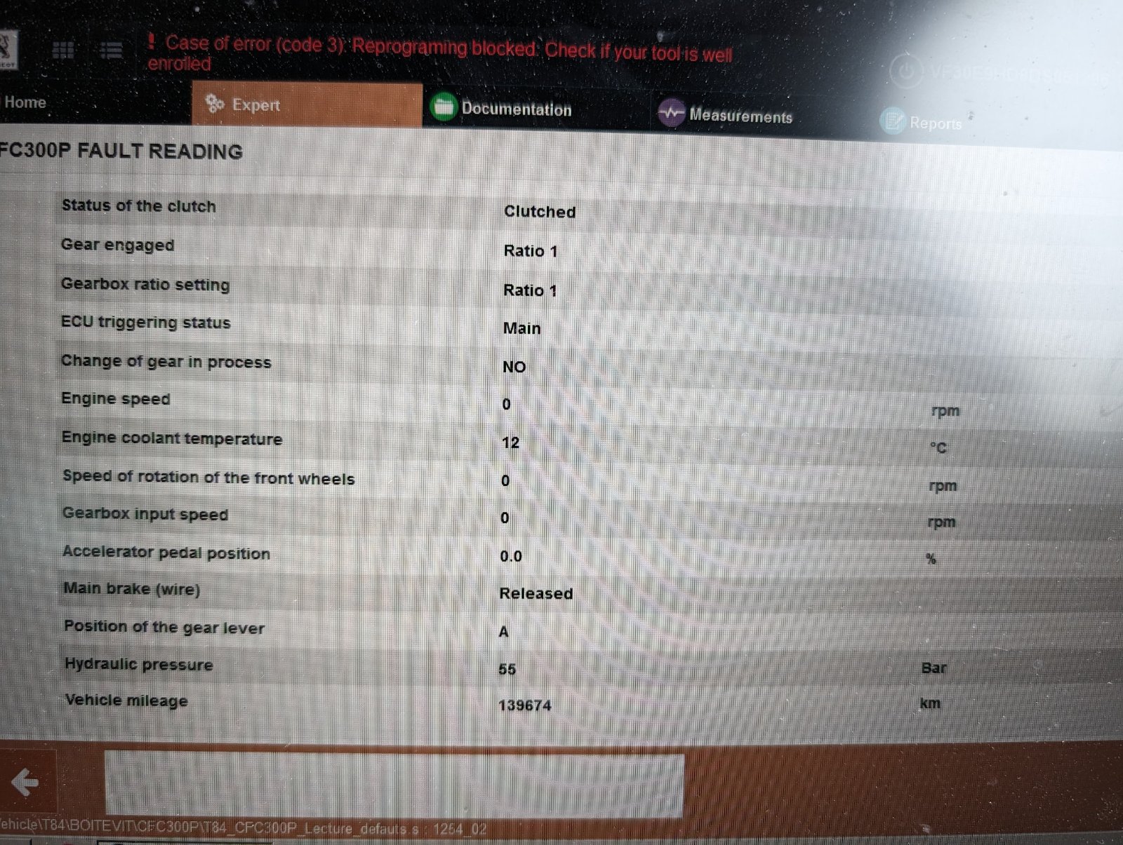

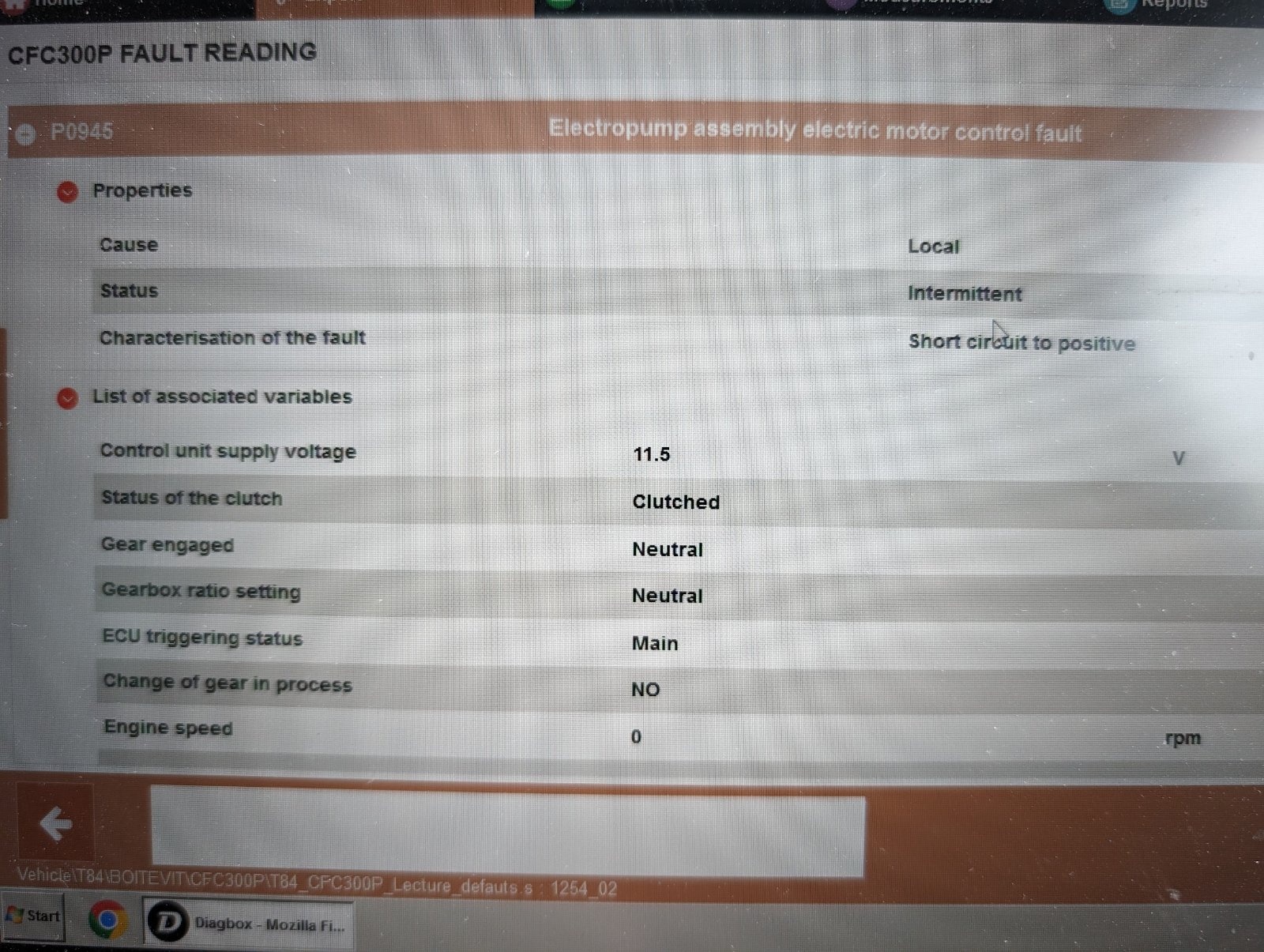

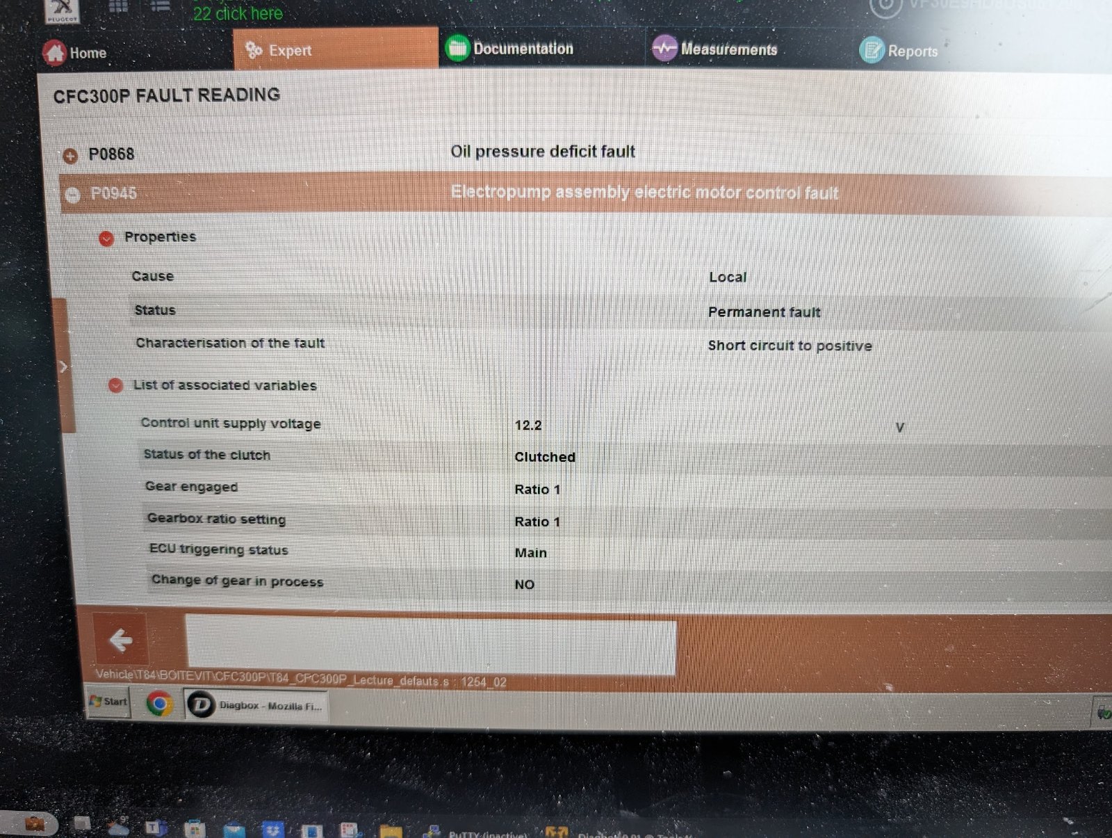

I have Diagbox and getting fault code is P0868. A quick search here points to low hydraulic oil pressure.
I’ve attached a screenshot as I don't fully understand it.
Any suggestions or pointers for further analysis would be greatly appreciated

Pop your VIN up so we can see the system you have. Please post your VIN in full without spaces - it will be automatically masked from public view after submitting your post & will only be visible to staff.
In the interim, it's likely these will be relevant:
Fault Code: P0945
Description of Fault: Electro-pump unit electric motor control fault : Short circuit to positive.

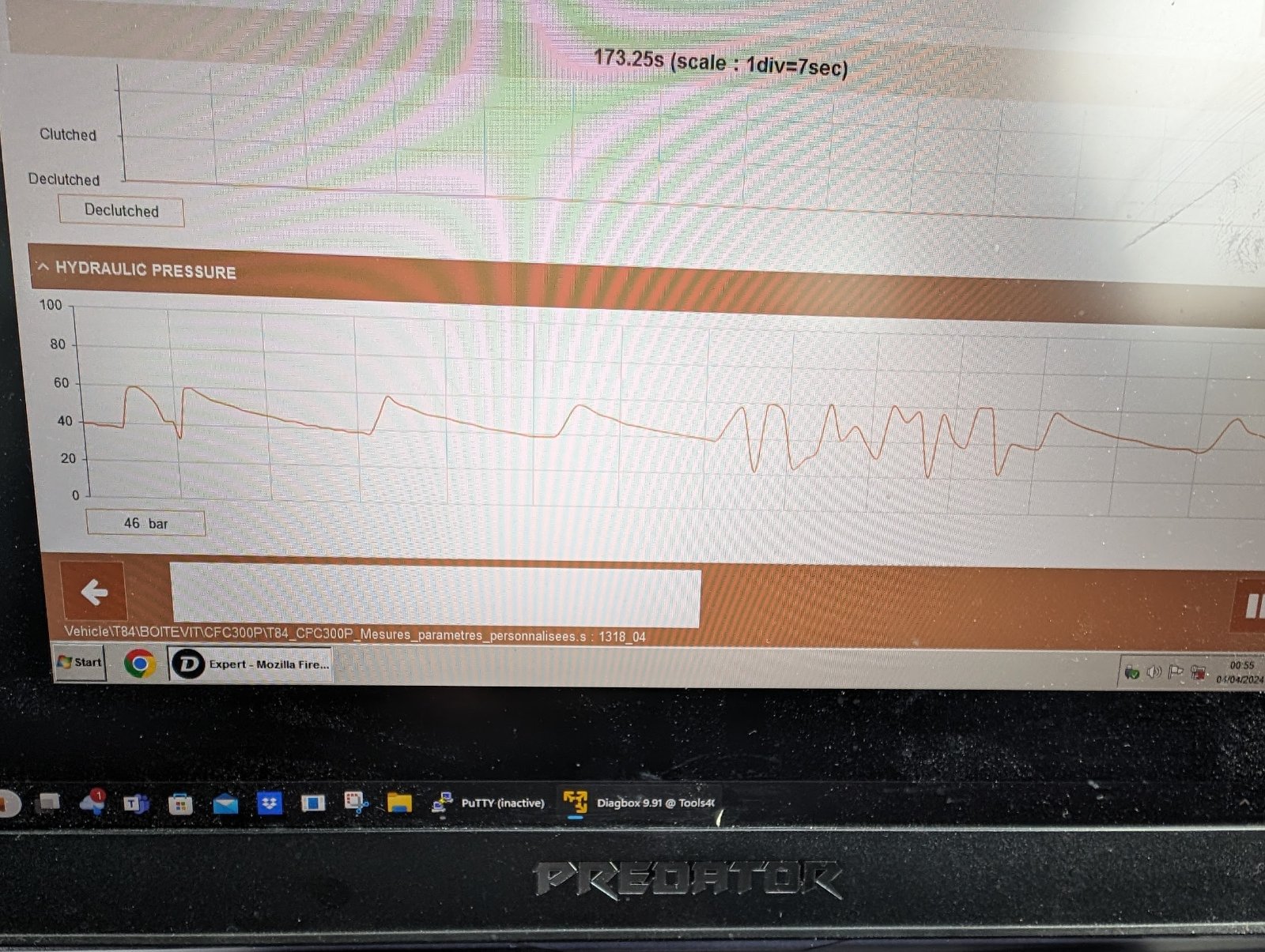

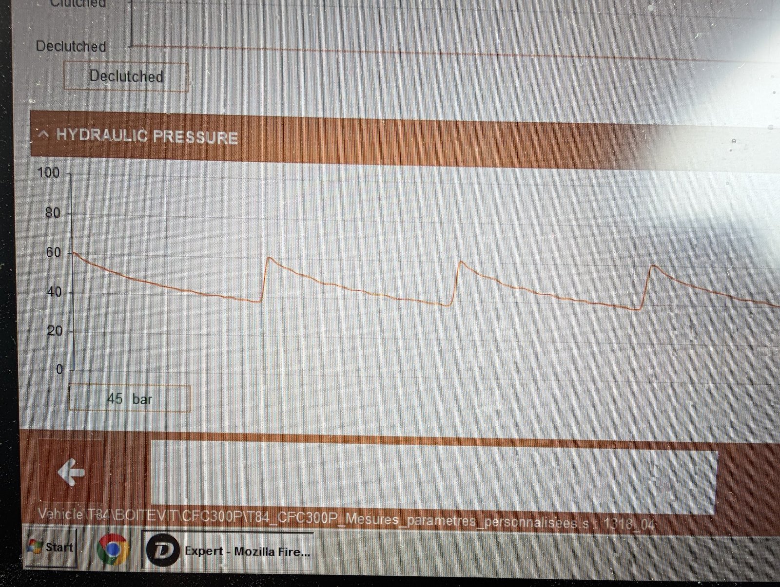

I ran Diagbox to check the Hydralic pressure of the gearbox I can see when the car is in N it seems to be bouncing between 38 bars to 60, it shoots up and slowly comes back down (screenshot attached)
When I change gears I can see this pressure bar dropping to 20 and then shoots back up to around 60 basically bouncing between 20 to 60 bars (screenshot attached)
Changing gears bouncing between 20 to 60 bars
in Neutral gear (N) bouncing between 38 to 60 bars

is there anything that I could look at? perhaps it needs a top up of oil? it would be useful to see diagram of the ECG gearbox and its components I can see there is a reservoir is this something I can check for fluid levels?
Posts: 11012
Joined: 09 Nov 2005, 22:03
x 1481
Re: Peugeot ECG Can't change gear - P0868 - oil deficit fault
Unread post by xantia_v6 »
If the pressure is bouncing around, I would guess the the fluid has leaked out and the pump is mostly pumping air.
Look for oil stains.

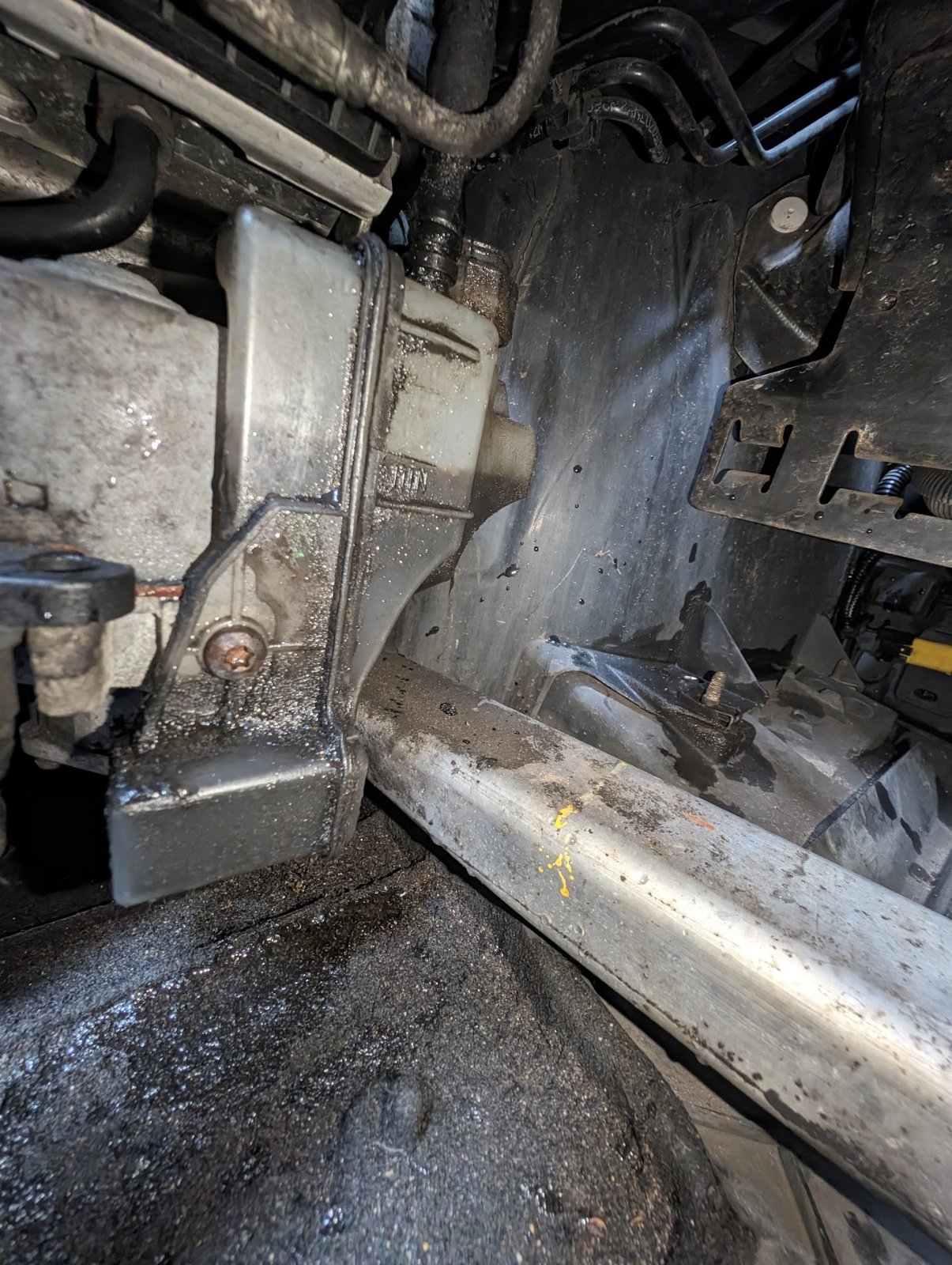

I have managed to locate the reservoir does look like I have a leak somewhere. The current level is just below the minimum, I wonder if I could top this up which would allow me drive this to garage instead of towing it
Forum Treasurer
Posts: 12615
Joined: 07 Aug 2002, 17:12
x 1498
Unread post by RichardW »
The level is only correct when depressurised, however if you switch the ignition on and it goes down to almost empty then sticking a bit more in might work.

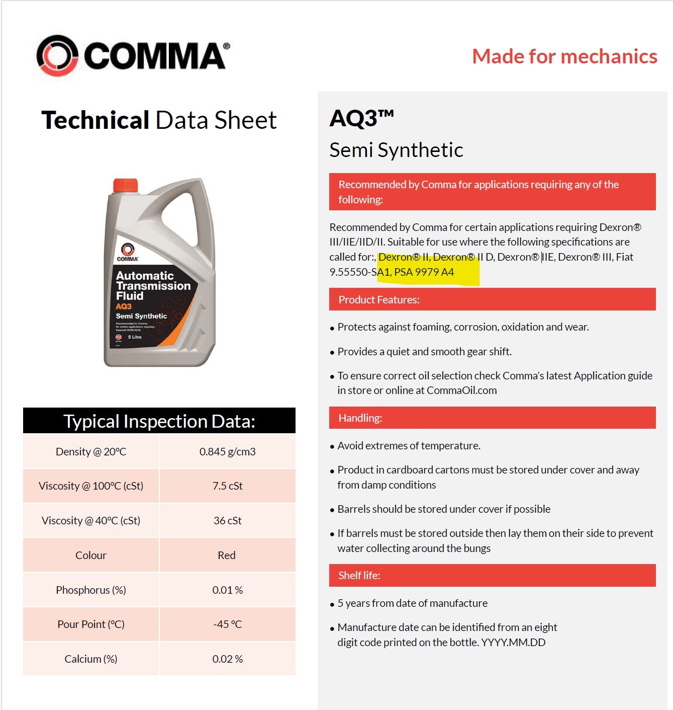

Any ideas what the specification of oil I need? I cannot see Eurocarparts or GFS selling it
x 6950
vmguru
Posts: 22
Joined: 13 Jun 2024, 11:45
Unread post by vmguru »

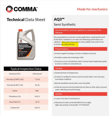

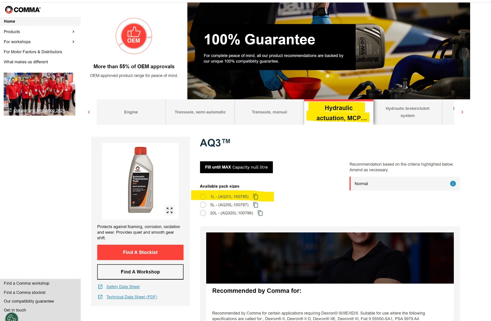

Thanks that's seems very expensive for 1L of oil, will have a look around see if I can find it at more reasonable price, the specification from what I can see is "9979A4"
same stuff but cheaper https://www.ebay.co.uk/itm/324989317747
vmguru
Posts: 22
From what I can see Comma AQ3 meets the 9979 A4 specification and GSF sell this for £10.37, GSF is very local to me I will double check with them in the morning.
https://www.commaoil.com/passenger-vehi ... s/view/191
https://www.halfords.com/motoring/engin ... 24309.html
