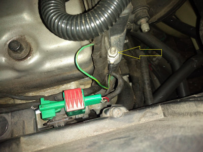

The "down stream" oxy sensor has a blue connector.
The green and yellow wire is here.
I think your problem is a bad coil pack. The coil pack sends out electromagnetic interference which is induced into the wires of the throttle body and confuses the engine ECU.
If fixing the green and yellow wire doesn't solve your problem it might be the coil pack...other than that, I don't know.
