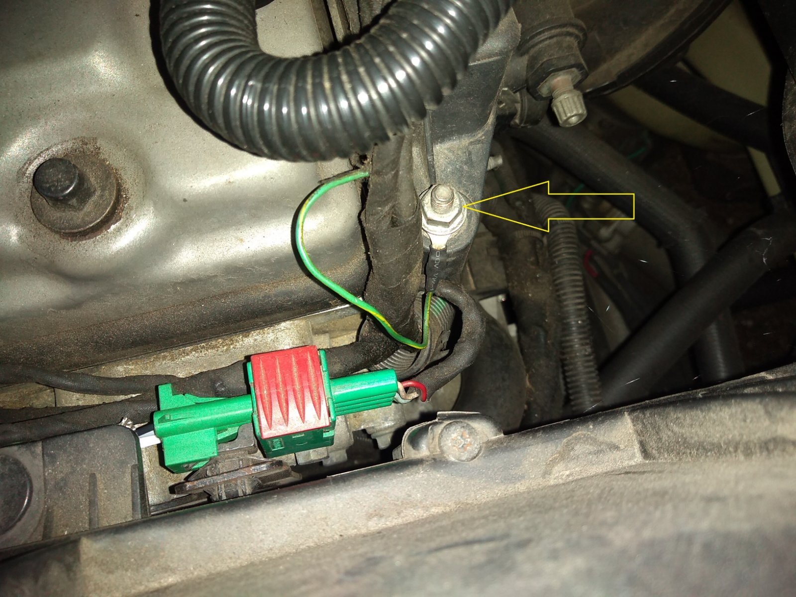

ozvtr wrote: 13 Jun 2024, 11:48 Check the green and yellow wire that comes out of the engine loom to the stud that holds the coil pack down.
See if you find a loose green and yellow wire from the engine loom on the top of the engine near the oxy sensors electrical connectors.
My knowledge of cars is limited. Picture of the car engine: . I understand the coil pack is what i marked in red. Is the oxy sensor eletrical connector the one I marked in blue?

Re: 2008 C3 1.1 - Error in throttle actuator control & Catalytic converter system
Unread post by ozvtr »
The "down stream" oxy sensor has a blue connector.
The green and yellow wire is here.
I think your problem is a bad coil pack. The coil pack sends out electromagnetic interference which is induced into the wires of the throttle body and confuses the engine ECU.
If fixing the green and yellow wire doesn't solve your problem it might be the coil pack...other than that, I don't know.
