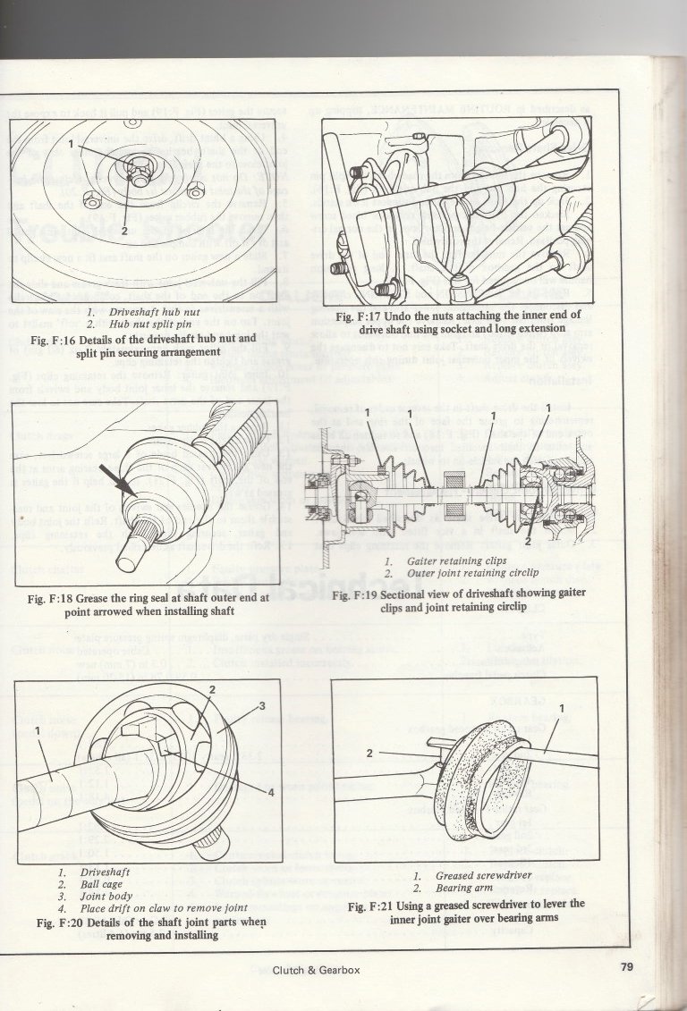

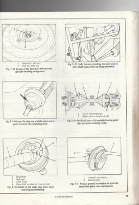

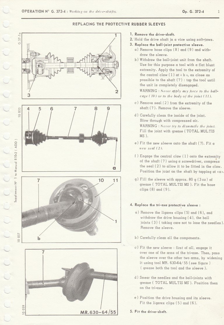

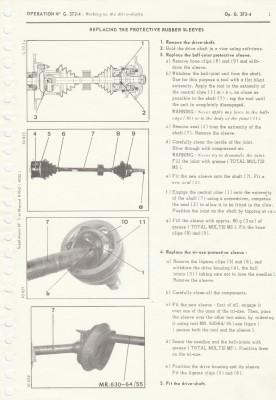

This will be 'fun'. It's been more than twelve years since I last did this job.
After removing the front wheel, remove the drive shaft to hub retaining nut and withdraw the hub from the shaft. This may require removing the lower (or is it upper?) retaining nut from the lower (I think) wishbone for better access.
Now you need to detach the inner end of the drive shaft from the brake disc, using long extensions. Six fixings in all, some are nuts. The drive shaft is now ready to be manipulated out through the sub-frame - it's a swine.
With shaft out, repair to workshop vice. The procedure is basically to separate the outer universal joint so as to replace the gaiter using greased screwdriver(s) to ease it over the end of the shaft.
And as they euphamistically say: 'Refitting is the reversal of dismantling'.
The images (assuming I can remember how to insert them!) are one page from the official Citroen workshop manual 008102, and Autobooks 278 by David Penn.
