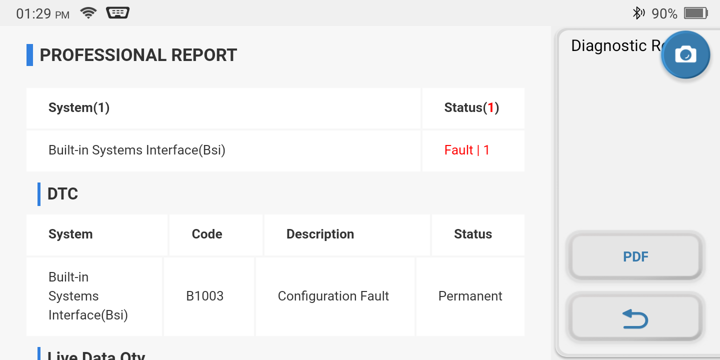

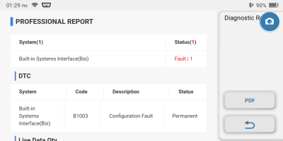

Hi all I'm new here hope you can help I have a 2014 Peugeot 308 16 hdi 158 thousand on the clock owned it about 6 months and everything has been fine with it
Yesterday engine management light appeared and on the stereo it Said engine fault see dealer or something like that
I have a topdon bt800 I plugged it in and it had a few faults which I cleared but the b1003 remained and engine management light stayed on
I have read a few posts regarding this but from various sites and conflicting information so any help would be appreciated
Many thanks Dave
This is from the topdon

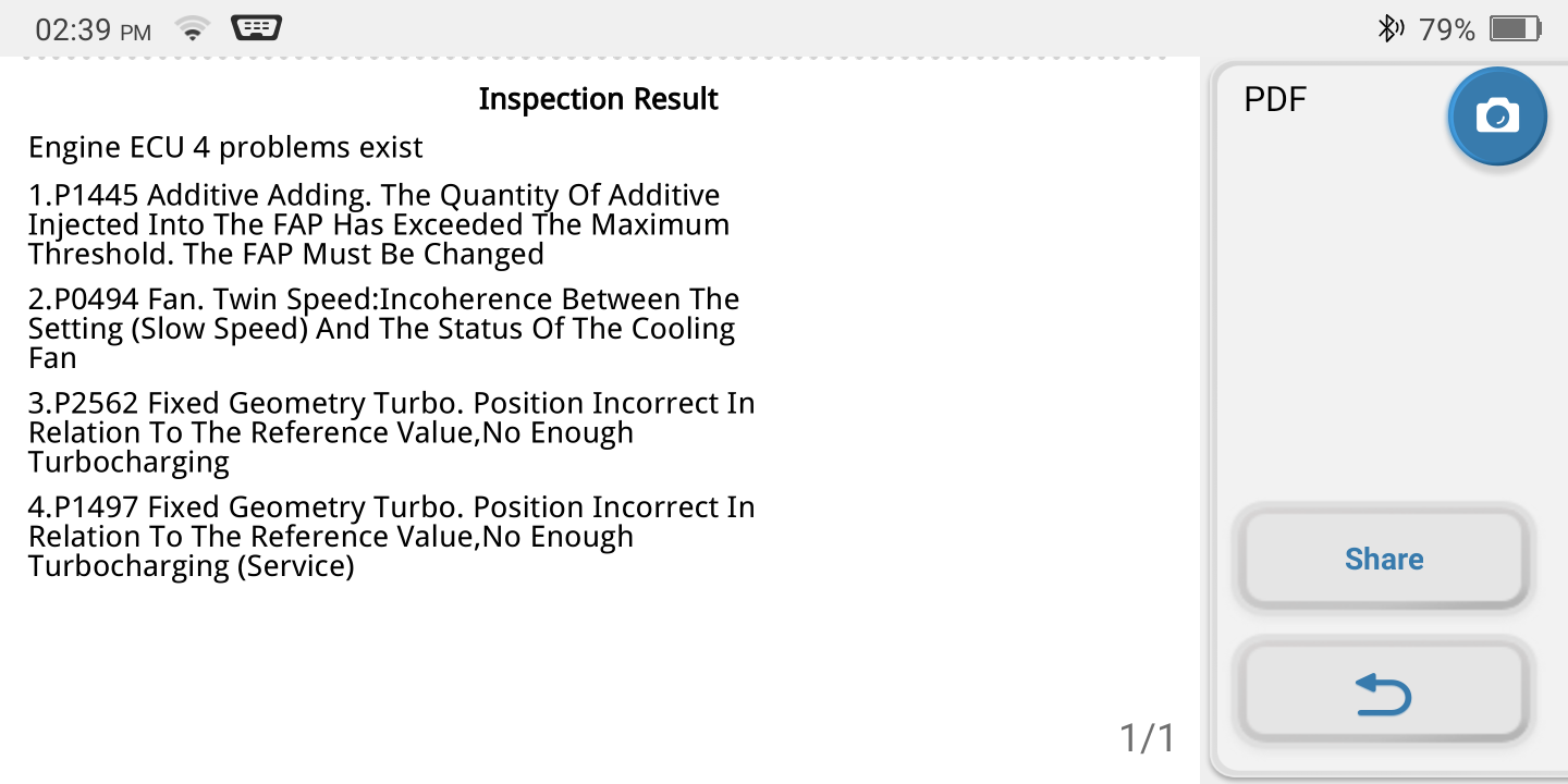

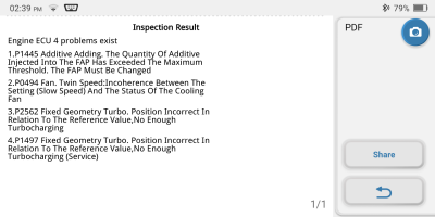

Hi they came up as historic so I cleared them and don't have the details of them the only code showing now is the b1003 I can quickly run a check again and see if any more have shown up since I cleared them
daveyboii71
Posts: 3
Joined: 08 Jun 2024, 13:54
Re: Help needed please bs1003
Unread post by daveyboii71 »
OK so I do a full rescan and this is what has shown up I have managed to reset and engine management light is off at the moment
