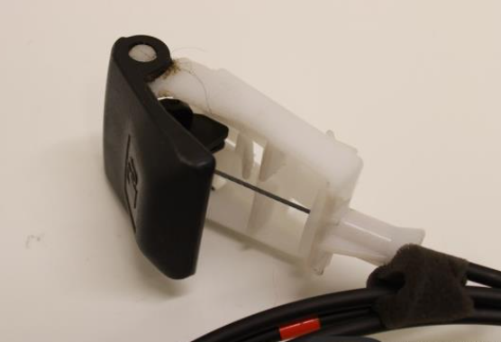

Re: How can I put the fuel cover wire back in place?
As you can see there are fittings on the back of the flap where the cable is inserted. You'll have to check to see if it has just come out or if anything has broken.
The whole flap unit just seems to be held in place by the white plastic peg.
Thank you! Yes the white plastic holds the lever and the metal head goes inside the lever itself. Now in my case the plastic is screwed to the dashboard and judging by the image you send, I should remove the white plastic completely. (The black lever itself is removable from the side pins, but the white is stuck inside - need to figure how to take it out)
