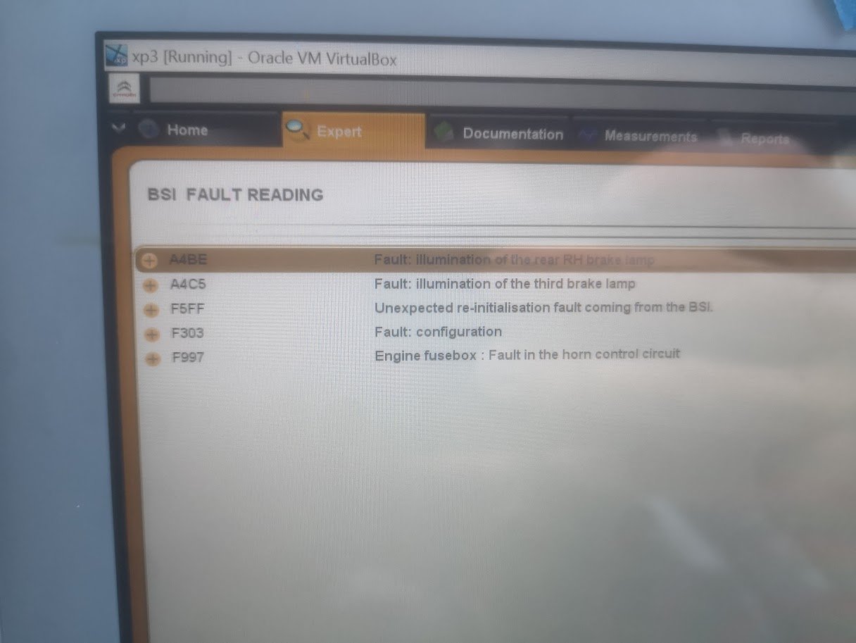

Finally got a lexia and plugged it in, but I can't seem to find the fault code for it.
I found a few other codes - but nothing that should be related?
Any ideas where to find it in the software?

That's in the BSI, you need to look in the engine ECU.

RichardW wrote: 05 Jun 2024, 10:43 That's in the BSI, you need to look in the engine ECU.
I guess that would be "engine relay unit"?
I can't see anything else labeled with engine

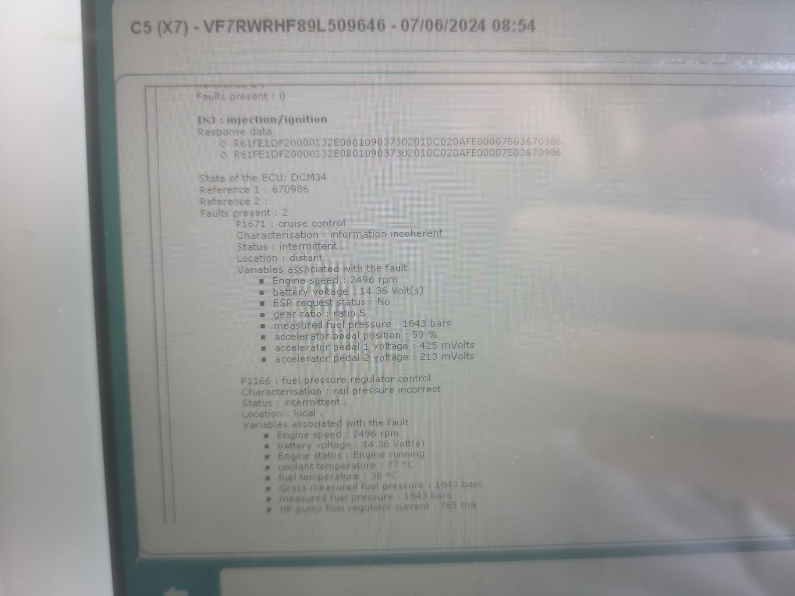

Once in Diagbox and it's read the VIN click on fault finding and then let it do a global scan. The engine ECU is usually the second one in the list, may be called injection or something like that. If you post up a pic of the global scan results, we can tell you which it is.

Re: c5 x7 anti pollution fault
Unread post by Agour »
Got it, thanks! :)

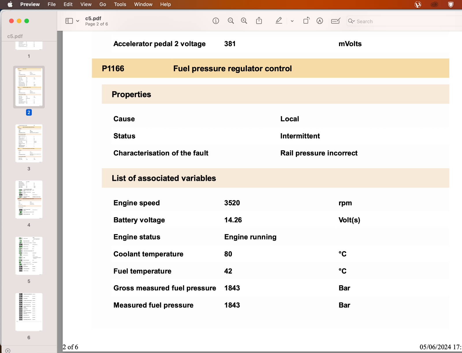

2 faults under the injectors, presume it must be p1166 that caused the anti pollution fault?
The faults are at least for now, intermittent, so I'd just clear those down and see how things pan out.
When did you last change the diesel fuel filter?
Don't run the fuel tank too low.
I'd also suggest getting some fuel system cleaner in for the next few tank-fulls and that should give the fuel system a clean, or start using some premium diesel for a while.
