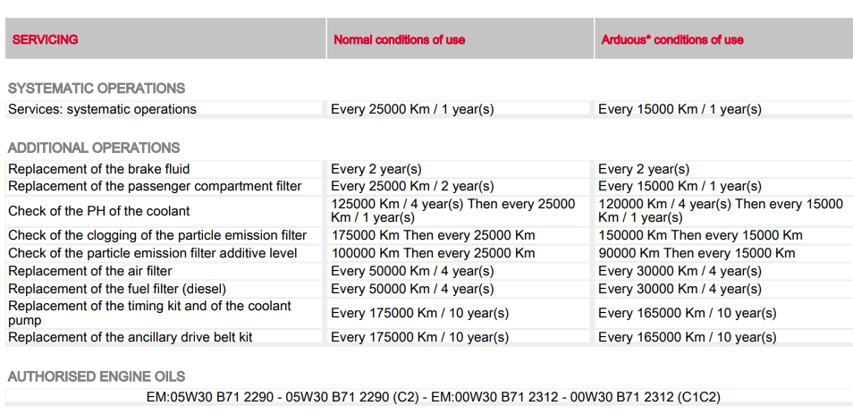

Re: Cam belt change
Ok, that's more like it (and just for ref. - there are no letter 'O's in the VIN, just Zeros :wink:
Here's the servicing schedule:
Click Image to Zoom

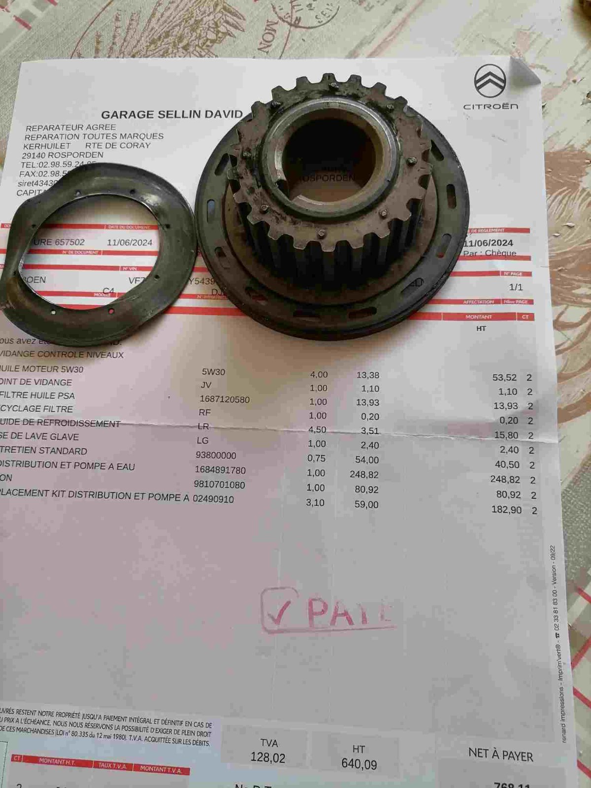

Mme just picked up car from garage after service & cam belt change etc.
Was paying bill when owner, who's looked after our cars for 21 years, came out & gave her the old belt pulley which apparently was almost off. He had never seen this before & said she was lucky the engine wasn't wrecked.

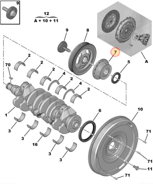

Can somebody tell me where this pulley is from?
It's got a key slot so I'm guessing it's either from the crankshaft or camshaft.
x 6956
Re: Cam belt change
It's the engine timing gear that's on the crankshaft pulley, item (7). £90.68 UK inc. VAT (£75.57 ex VAT) just for comparison.
