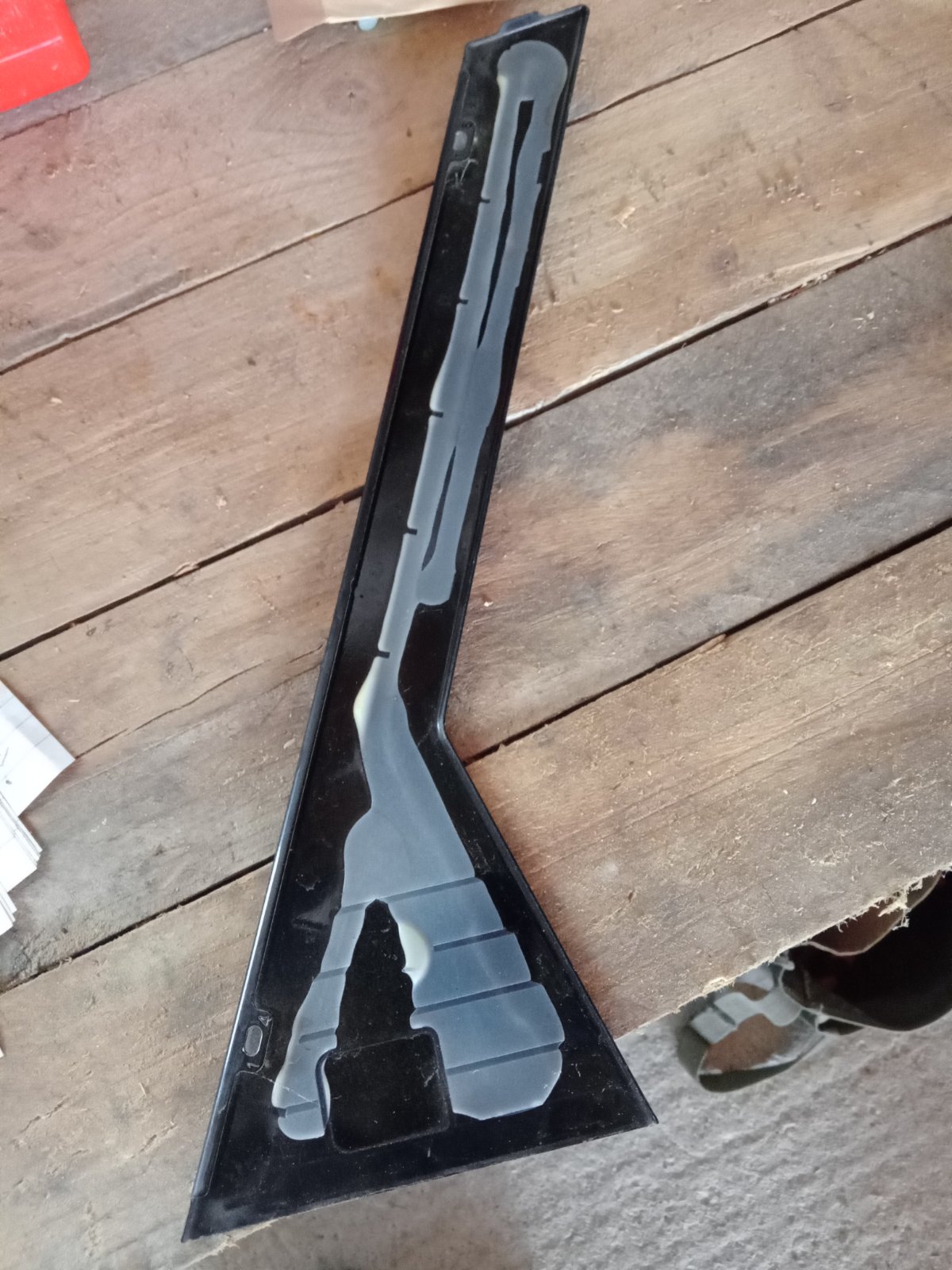

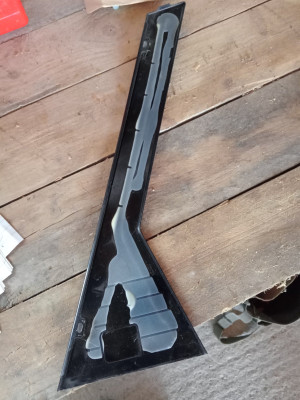

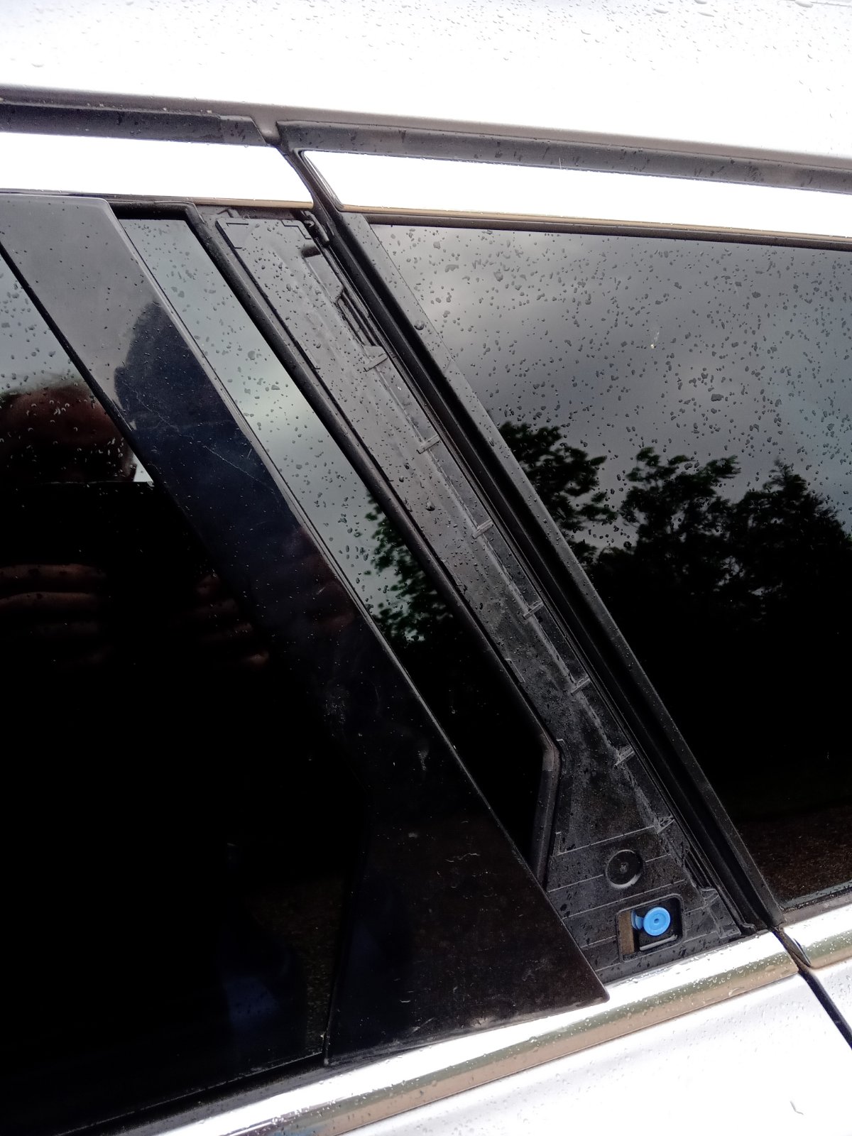

A piece of trim fell off - see pictures. Luckily, on my drive and not on the road.
Could someone advise how to remove the old glue, and the best stuff to use ?

That looks to me like it has a locating Tab at the top and a stud fixing at the bottom which has presumably broken and hence it fell off. I think the grey stuff is there to stiffen it and so should be left. I'd put it back on with double sided badge tape like this: https://www.ebay.co.uk/itm/264890492683 ... BM5ovb5_dj
Good luck !
Good luck !
- x 6945
Re: What Glue to use for Trim

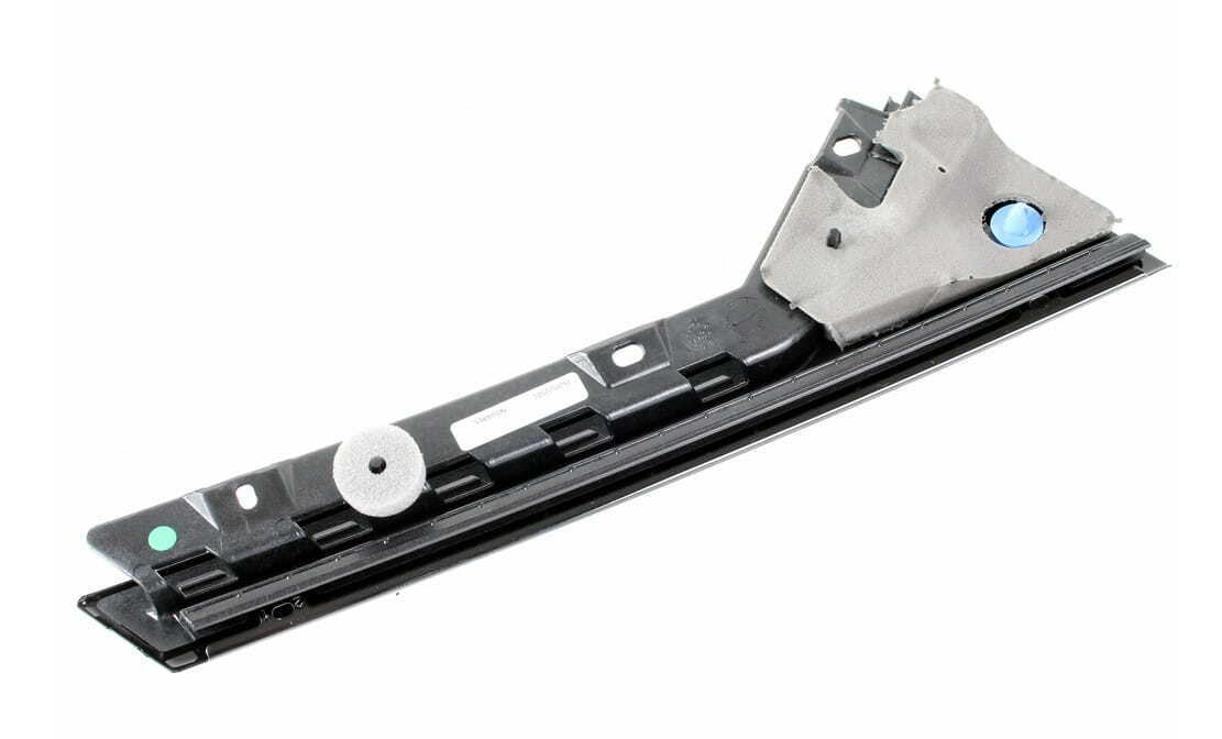

It's likely to be a complete part like this otherwise... so hopefully some very strong adhesive to secure that on may do.
