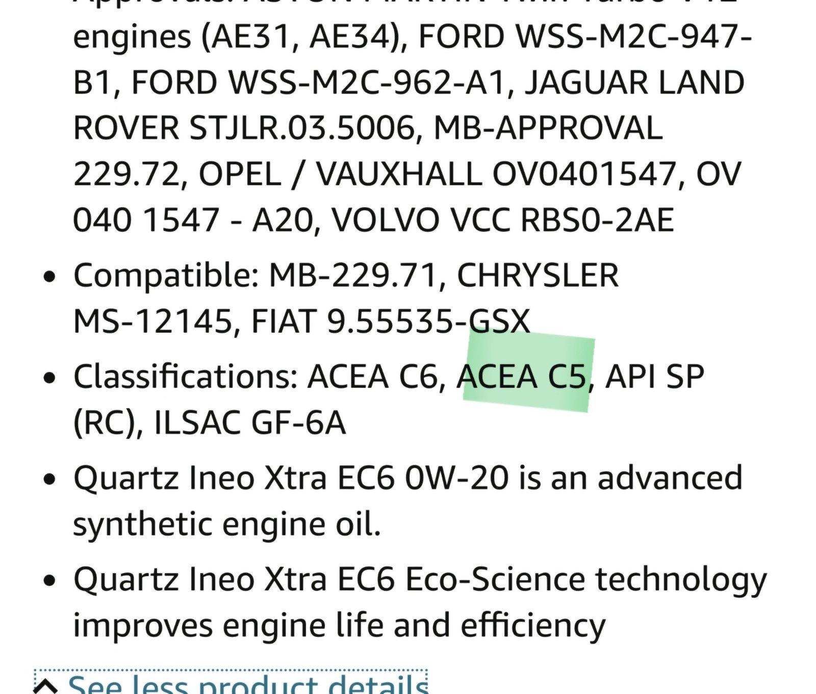

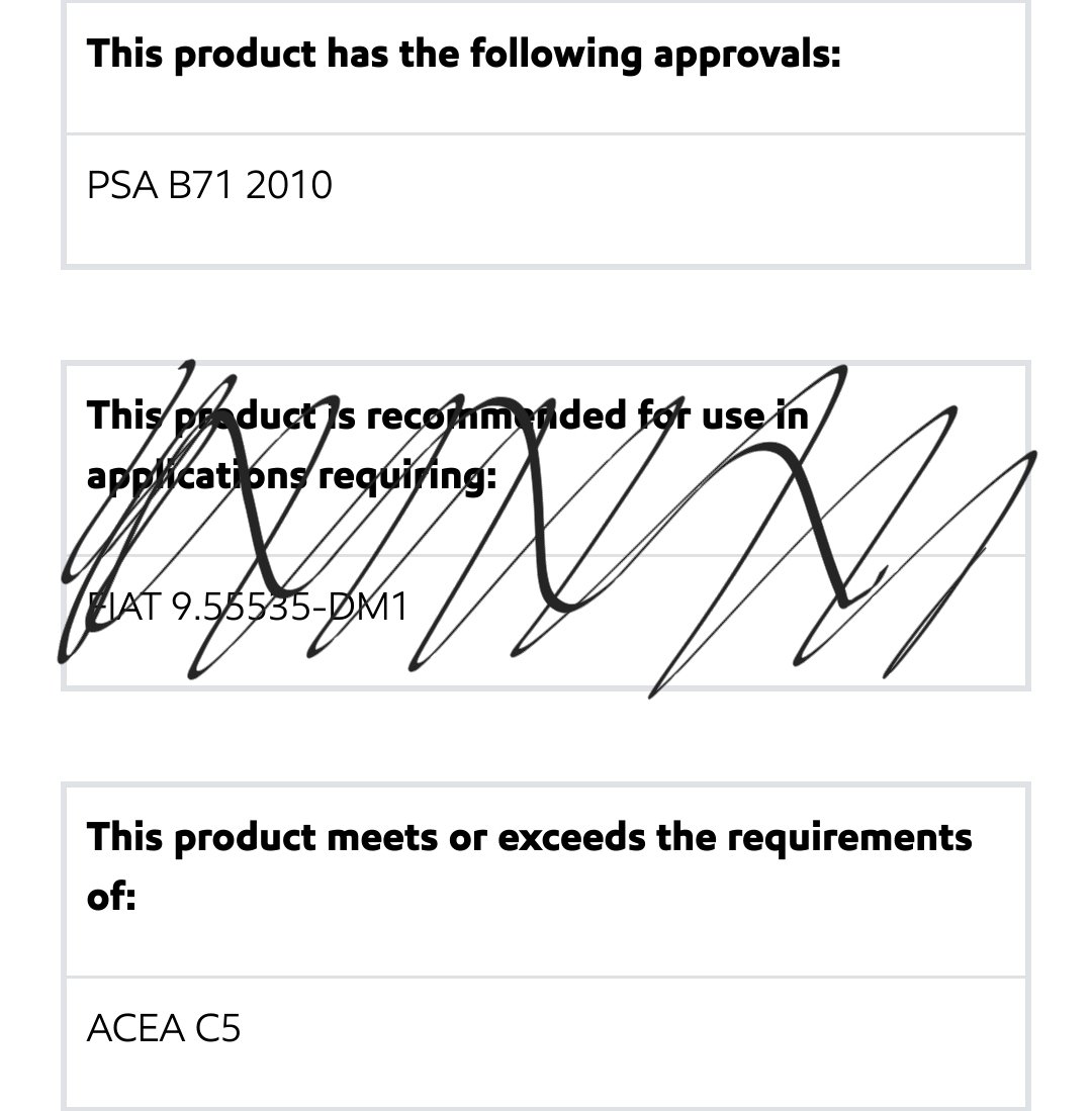

Thanks - would this also be suitable (I already have some) :
https://www.mobil.co.uk/en-gb/engine-oi ... la-p-0w-20
or this
https://www.amazon.co.uk/TotalEnergies- ... r=8-7&th=1
or this

This means it is of the correct specification.

The Mobil oil says it meets the spec, the Total one doesn't.

Not to confuse things but.
I would have thought that as both olis met the ACEA C5 spec that they are both suitable and the PSA-B71 2010 specification was just the PSA specifaction reference.
Very odd that Total doesn't meet the requirements especially as the car is a Citroen.
Stu
- Posts: 9360
- x 1938
Re: Correct oil grade for C3 Aircross
I take the opposite view Stu. If it doesn't say PSA-B71 2010 then I would avoid it regardless of whether it meets ACEA C5 or not.
