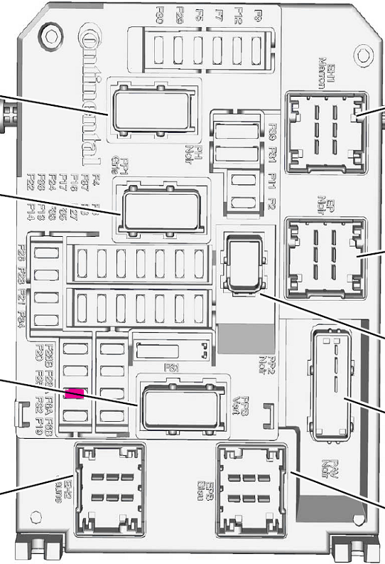

Regarding the switch, are you referring to this control?

Re: DS5 Media Control
Hi yes that's the switch I've done the basics like making sure the contacts of the switch are clean and not stuck but still no joy! so any guidance would be much appreciated.
Ok, so This is called the Telematic Navigator and it has a fuse in the BSI. The BSI is in the passenger glovebox (be very careful here as this is the main vehicle computer). It is Fuse F32, which I have shown in red below. It's a 10 Amp fuse and should be marked on the surrounding plastic of the BSI - but the position is clearly shown. You may need a torch.
Hooray!! absolutely brilliant control switch now working, yes it was the fuse it hadn't blown just not seated properly, the car might be getting on a bit but it's still performing well.
