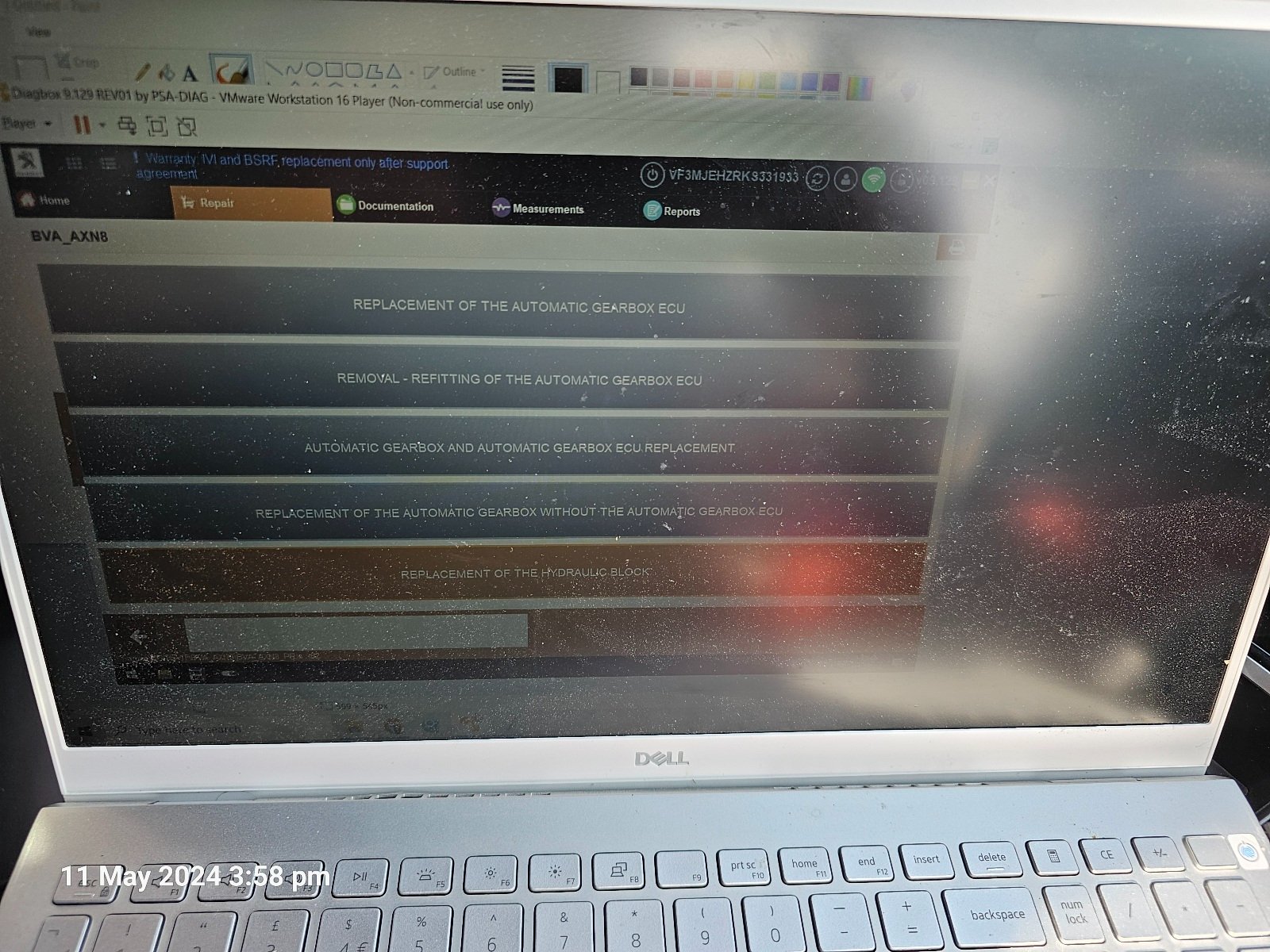

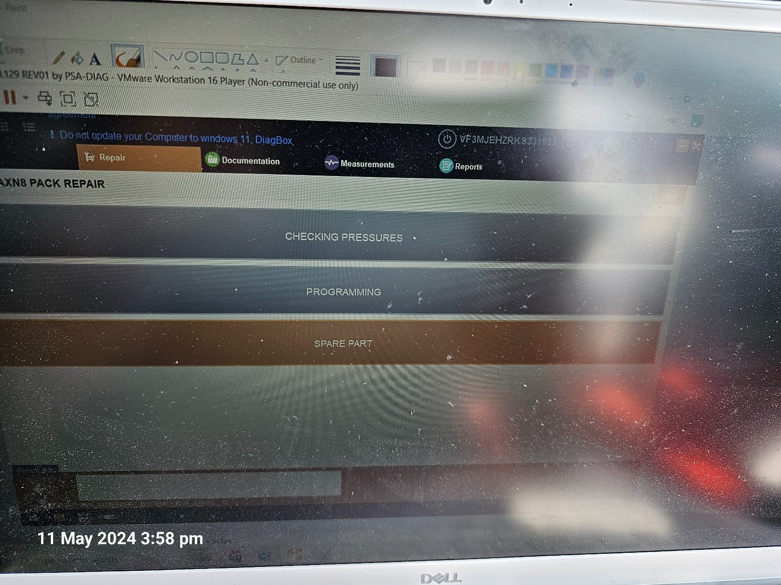

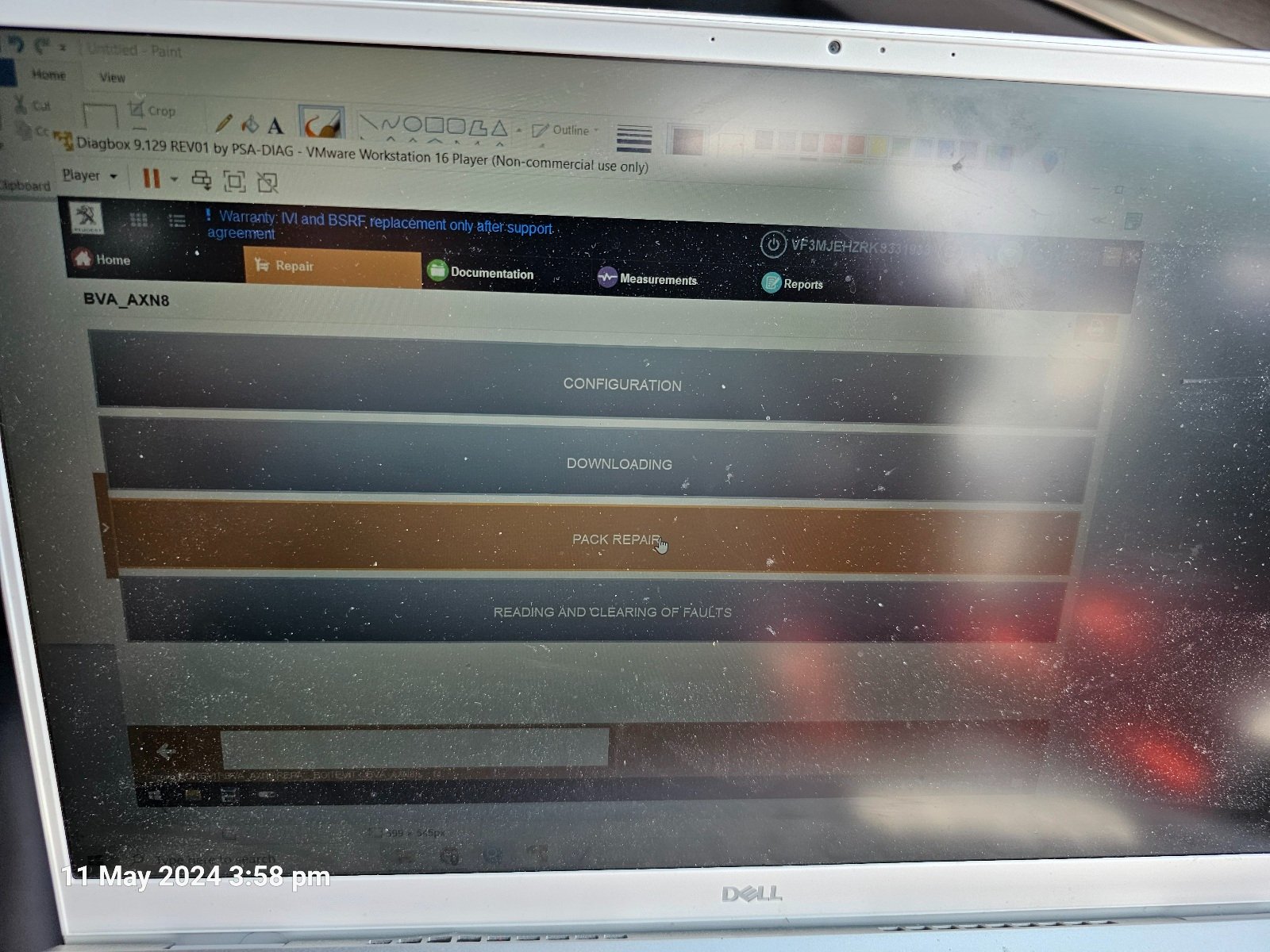

I refreshed the fluid of my AMN8 gearbox by already known method of draining around 3 liters 4 times and after that adjusting the level. In some of fhe forums I have read that after changing fluid, oil wear counter needs to be reset with Diagbox.
In Diagbox under repear menu I could not find any option for oil wear counter reset.

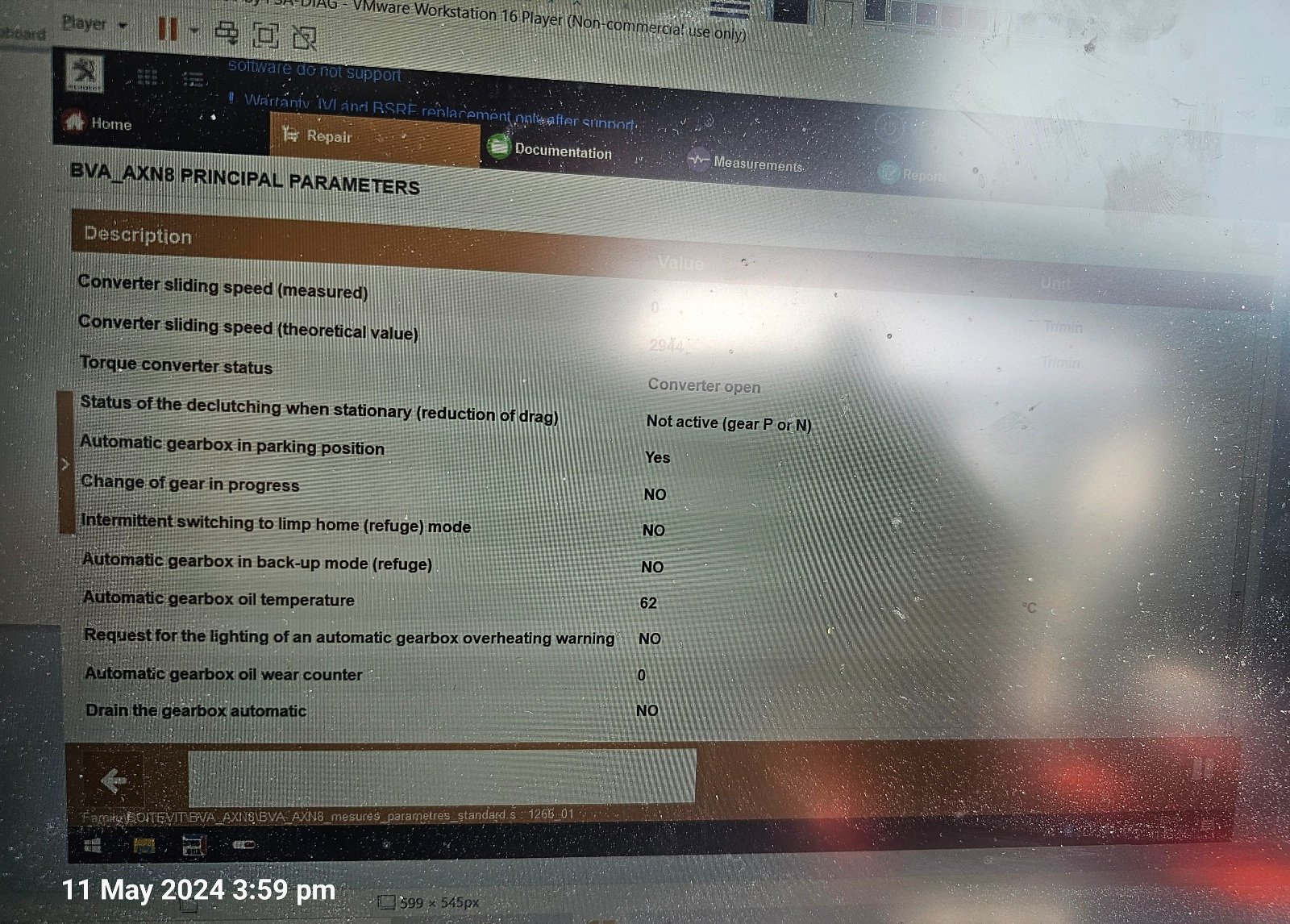

Even in parameter monitoring menu oil wear counter value is 0.( please see attached pictures)
Does anyone know if this is normal and maybe that gearbox doesn't need reset.

Re: AMN8 gearbox fluid refreshed
From the first picture, it looks like the oil counter is already at '0'.
Yes, that is correct. The thing is that I haven't reset it.
As far as i can remember when i reset my oil gearbox EAT6, in the last photo menu, there was a last choice , "oil replacement of gearbox" or something like that. Are you sure that you set down the drop menu with the arrows of keyboard or mouse? Additionally i was thinking that the oil wear counter had a combination of letters and numbers.You couldn't figure out how many hours or what PSA define as measurement unit . Also after the resetting (VmWare and 9.68 Diagbox) and 1k Km , i did a final 3lt oil change of 12 lt in total and the wear counter was 0. I tried and Diagbox 9.129 but i couldn't do the reset, because the program was stuck in the reset procedure.It's a mystery..
I watched some YouTube videos but all of them were for EAT6 and really there was an option for "gearbox oil replacement " at the end. Maybe in Diagbox 9.129 and ETA8 ECU that option is either removed or under different menu. Those are all available options for "gearbox repair ".I was hoping someone done that on ETA8 to share some experience.
You'll probably have to run the global test first, then select the gearbox ECU from the list, then within there, there should be a repair section and look for options there that should all be related to the gearbox.
