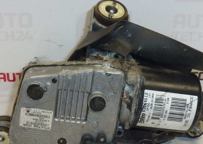

Can someone help me? Why do I find two part numbers for the same wiper motor - Citroen C5 2010, 1.6 hdi, 82kw (LHD)?
For exemple:
- left (driver side) wiper: 9682755580 (53569612) and 9683767280 (53571012)?
They look alike.
Are the same parts? Is there something different?
Thank you

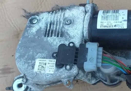

Wiper motors are different for left and right hand drive vehicles and also for right and left hand sides. So there are 4 different motors depending on which side and left or right hand drive.

So this wants to tell the small label from the manufacturer, with LH Pass or RHD pass.

Those are the manufacturer part, not the Citroen part number.

Problem solved. Thanks for help.
Even if I thought that is the master wiper motor, it was the other one, the passenger's one. I found maybe 4-5 cm of rotten leaves and dirt. In that was the wiper motor sitting.
