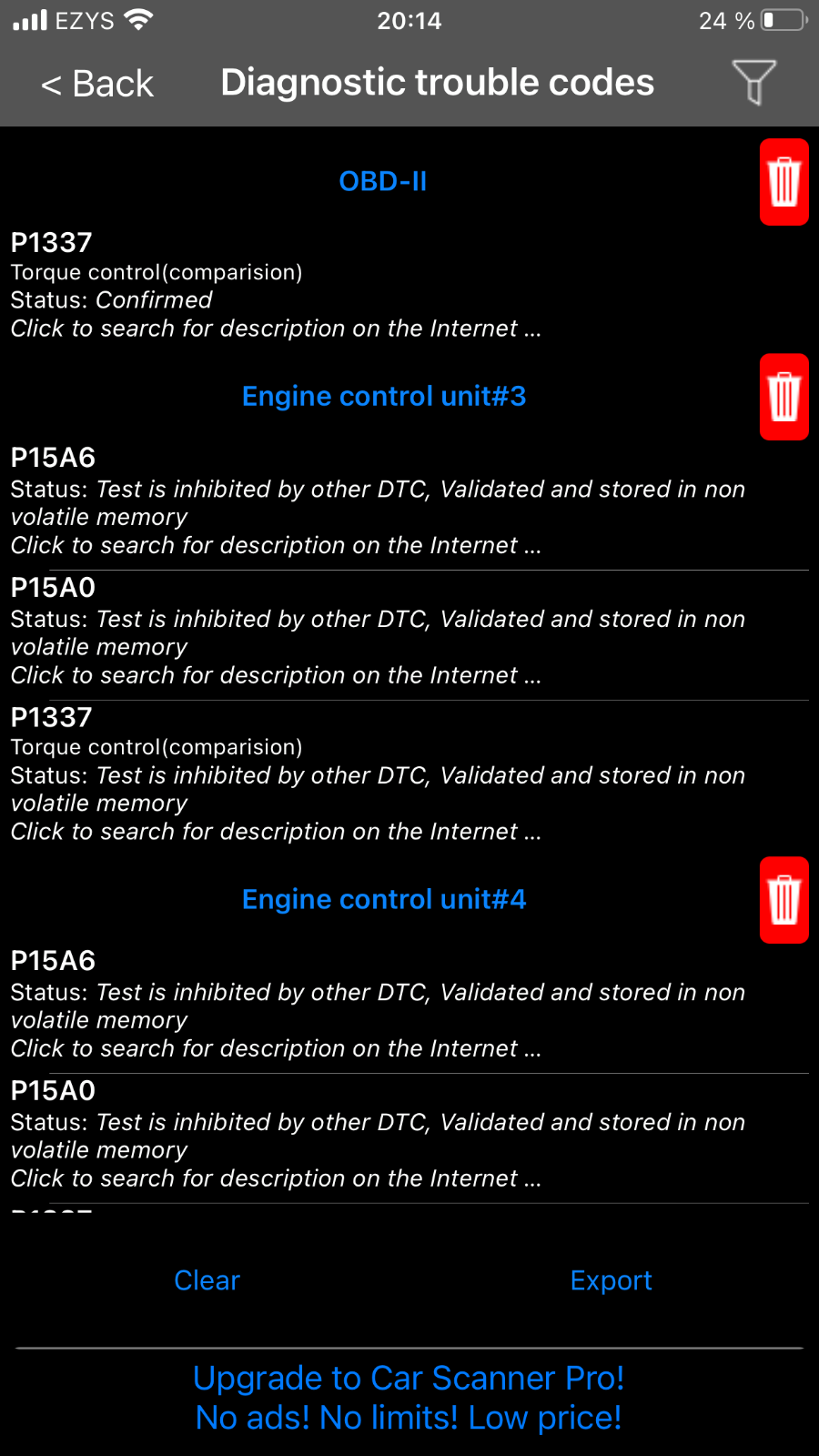

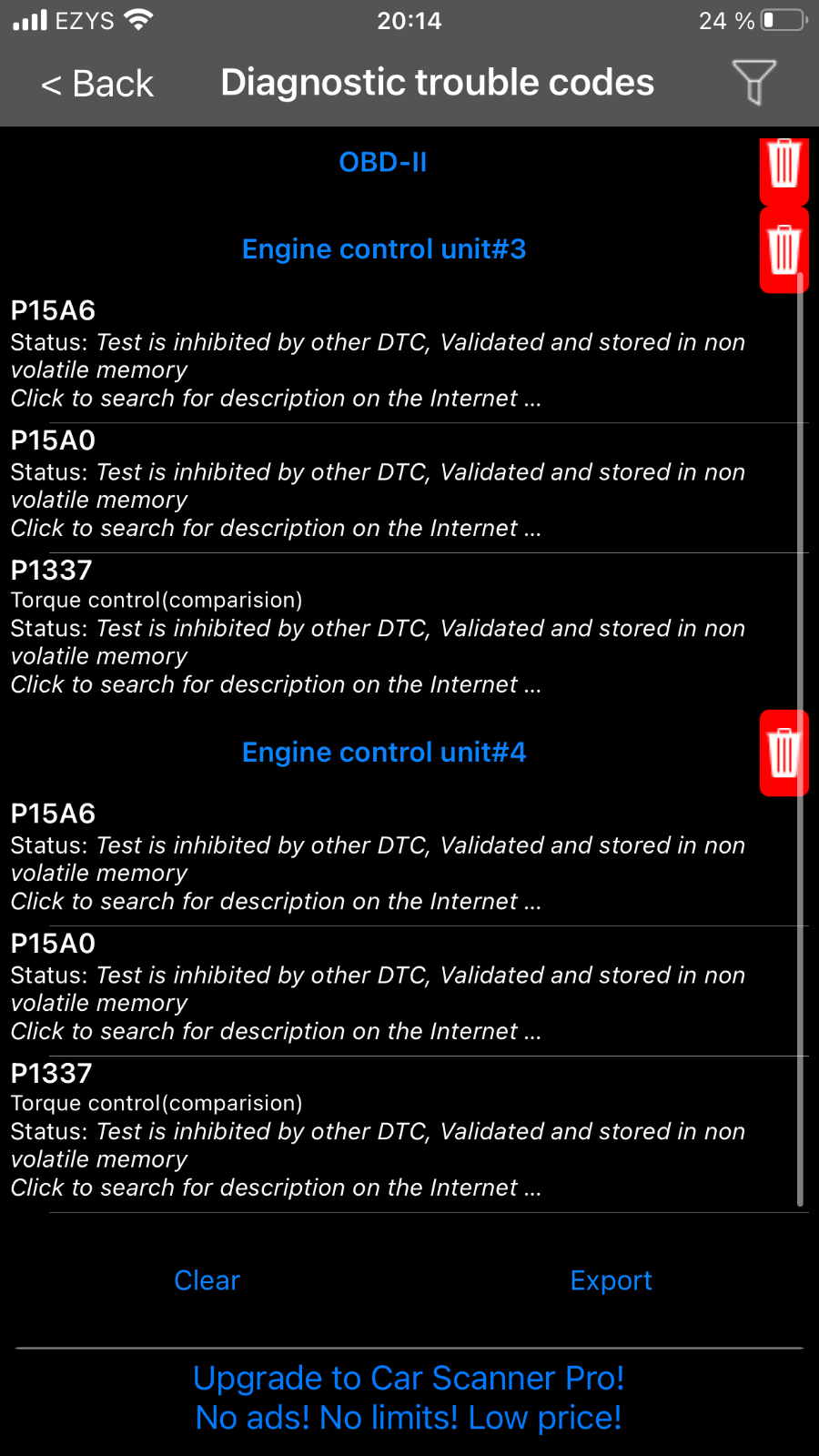

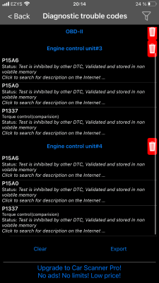

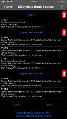

Also my cheap OBD reader shows something I can't understand as ECU #3 and ECU #4 and these does not reset after clearing codes even on ignition only and the one where OBD-II only throws P1337 and after clearing like I mentioned there's CEL gone, error itself cleared, car starts fantastic, idles nice when cold and reaches working temps and booom everything repeats.
