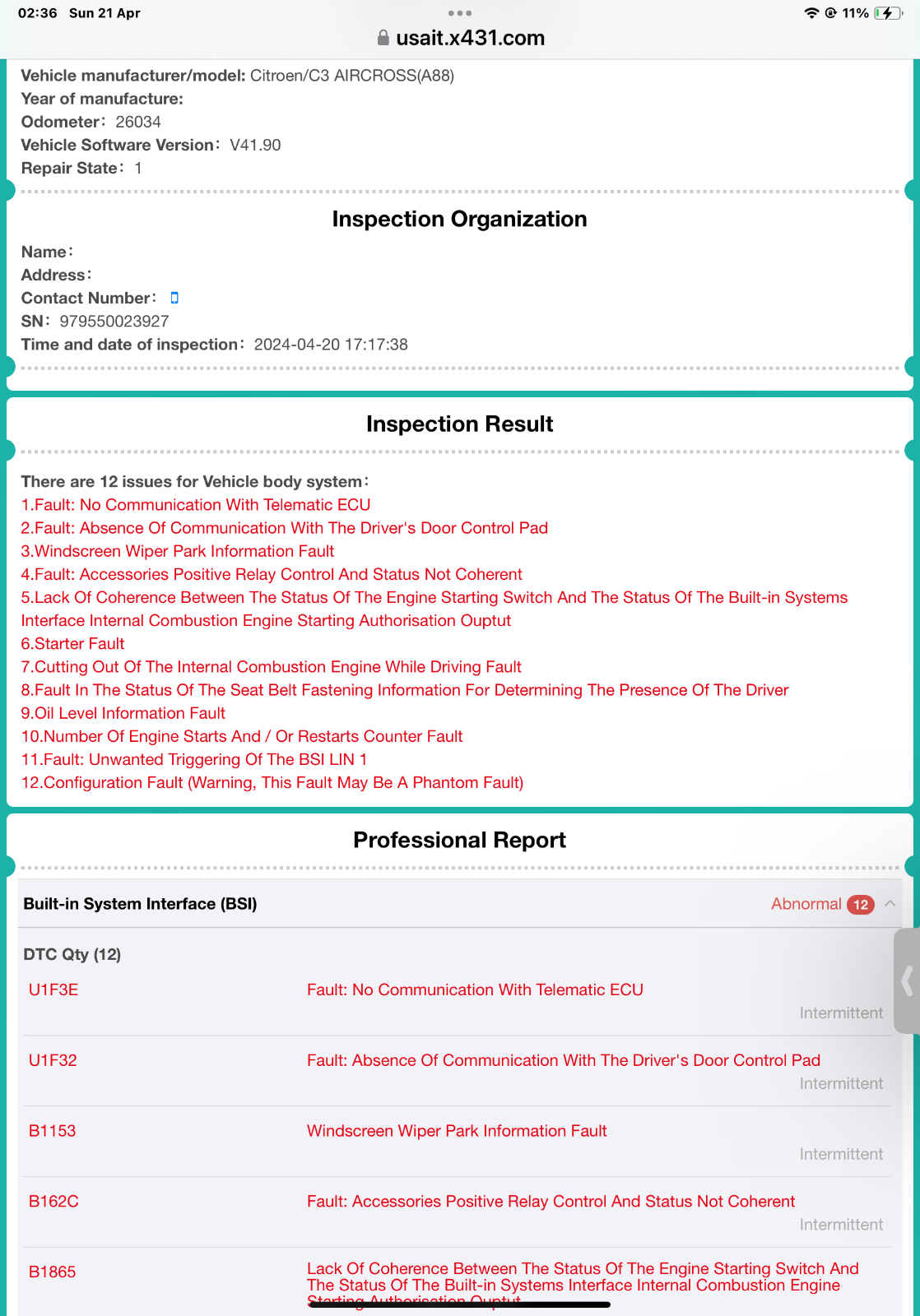

I’ve only driven 70 miles and on the 3rd day the orange symbol came on with a general engine dysfunction, I was worried so borrowed my friends OBDll diagnostic tool test and I would like some advice on the findings that was delivered, I’m new to new technology cars, so your advice would be invaluable, many thanks these are the findings below

Hi thanks, would you advise me not to drive the car following the findings that I have given.

Those are only BSI faults, and most likely related to a low battery at some point. The one putting the engine light on will be in the engine ECU. If it's running OK, probably no issue driving it, but you never know...

General rule of thumb for orange warning lamps with no running issues safe to drive as long as oil & coolant levels OK too.

Thanks for the answers is there anything in the report I should be extremely worried about.
