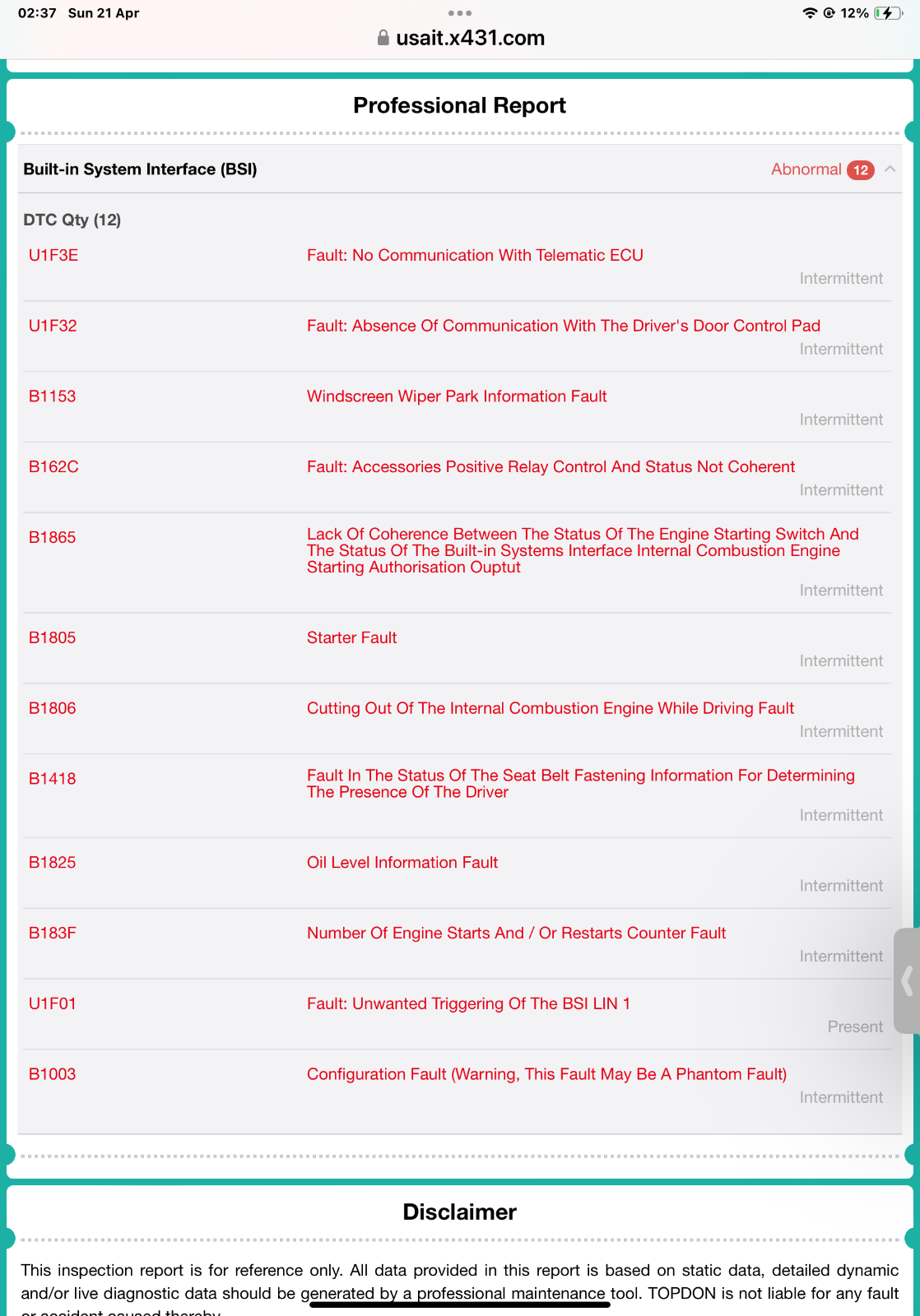

Hi first post in this forum, I purchased a Citroen C3 aircross 2020 on the car site cinch.
I’ve only driven 70 miles and on the 3rd day the orange symbol came on with a general engine dysfunction, I was worried so borrowed my friends OBDll diagnostic tool test and I would like some advice on the findings that was delivered, I’m new to new technology cars, so your advice would be invaluable, many thanks these are the findings below
x 6956

Those are only BSI faults, and most likely related to a low battery at some point. The one putting the engine light on will be in the engine ECU. If it's running OK, probably no issue driving it, but you never know...
