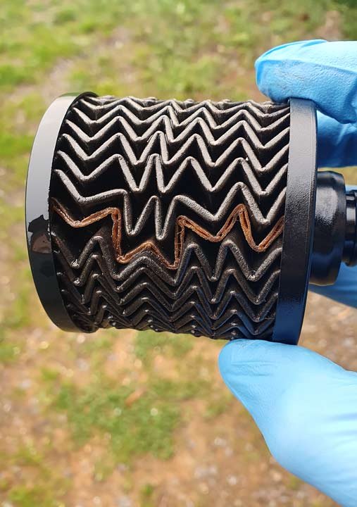

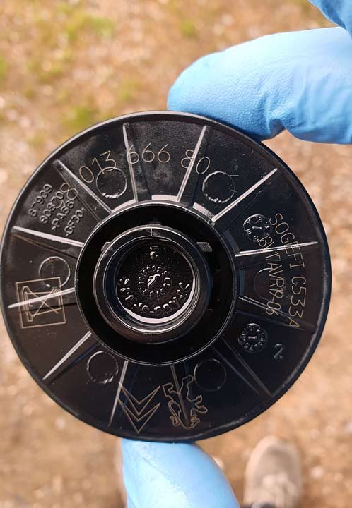

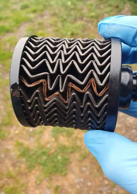

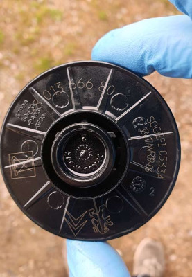

yesterday I changed the fuel filter on my Citroen C5 Aircross with BlueHDI 180 engine.
The old/original filter was attached at the bottom of the fuel filter housing and looked like this:

You look to have got the wrong replacement filter. This happened to us when getting one for our 1.6 hdi Cactus, GSF supplied the wrong part (Mann). Once the old one was removed I saw the Mann one did not have the 'nozzle' on the bottom as in your first photo so put the old one back . I managed to then get the correct one from Eurocarparts which was a Bosch.
If I was you, I would buy the correct filter and fit it. For something that is replaced about every 4 years you will be worried about it until then if you do nothing now. Worse though, it might not be stopping bits of metal/other stuff getting to the injectors. In my case I was able to return the Mann one to GSF since I had not used it so it was as new,
