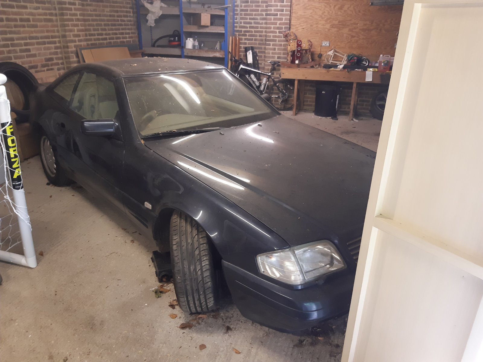

Well, I wasn't expecting this. I turned up to work the other day and was told the old SL320 Merc in the garage needed to go. Did I want to buy it ? Ummmmm. Errrrr. :-k
I said 'yes' - with quite a lot of hesitation.
It belongs to one of the family I work for and it's been stuck in the garage for 'quite a few' years now #-o It used to run - I parked it up in the garage some time ago, but hasn't turned a wheel in ages apart from one exception.... it was flatbedded to and from a garage for a service and MOT about 3 or 4 years and has done precisely 0.3 miles since. There were great plans to use it, but they came to nought.
And now for the bad bits....
It doesn't run. It cranks fine, but not even a hint of firing.
It's had numerous mice living in the engine bay.
There's probably mouse damage to bits of wiring.
It's filthy. Covered in grease and bat 'detritous'.
The engine bay stinks of mouse pee and is a health hazard.
The driver's door has a big dent in it.
Someone keyed the bonnet many years ago and there's rust showing in places along the key line.
There's only one key :(
Innumerable other bits and pieces need fettling and fixing.

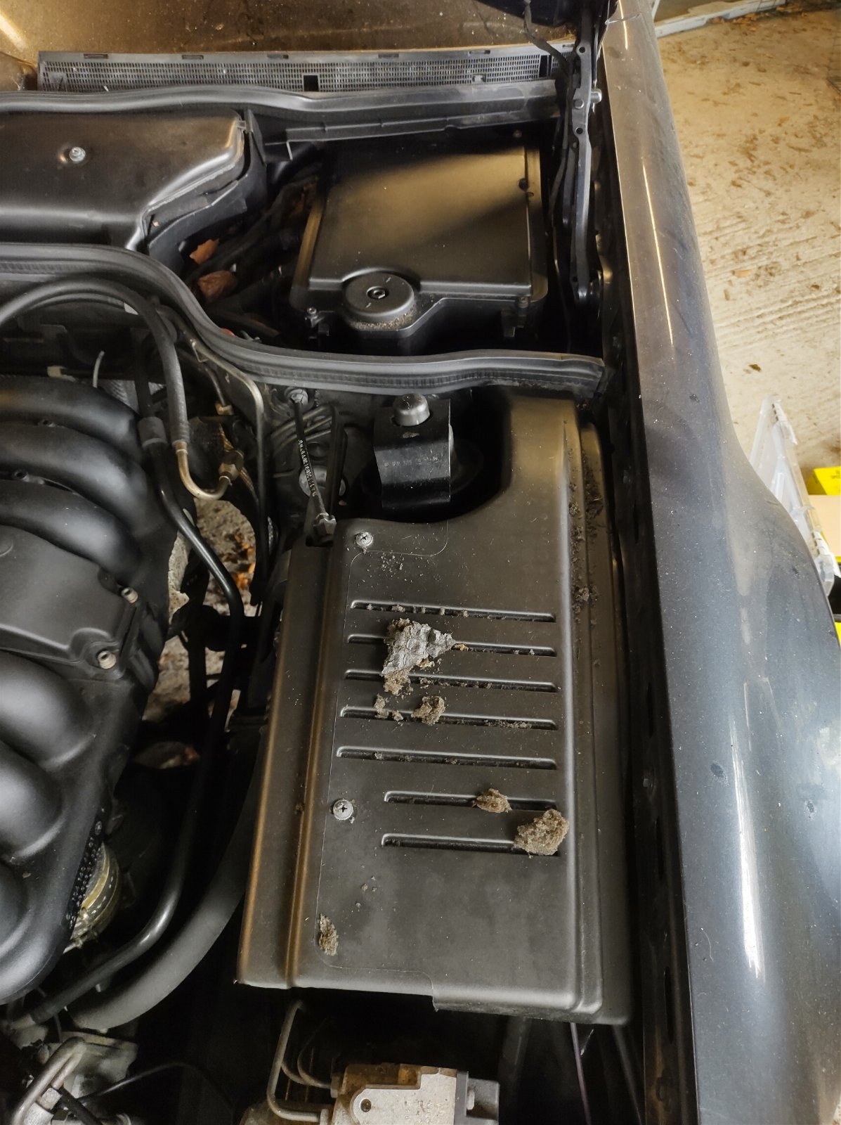

That collection of leaves and rubbish comes courtesy of some mice. It leads to.......
Air filter nest - own work
I think I'd call that full. That's the air filter housing :?
And in the opposite corner of the engine bay lies the ECUs and electrical gubbins - all nicely insulated by more mouse nests.
More mouse nests - own work
The box to the top of the picture that has the round cap in it - that's the ECU compartment. All around it is mouse nest #-o

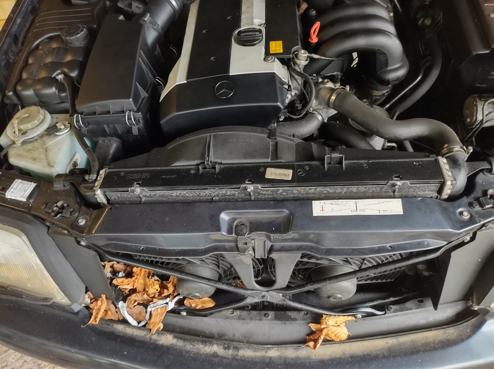

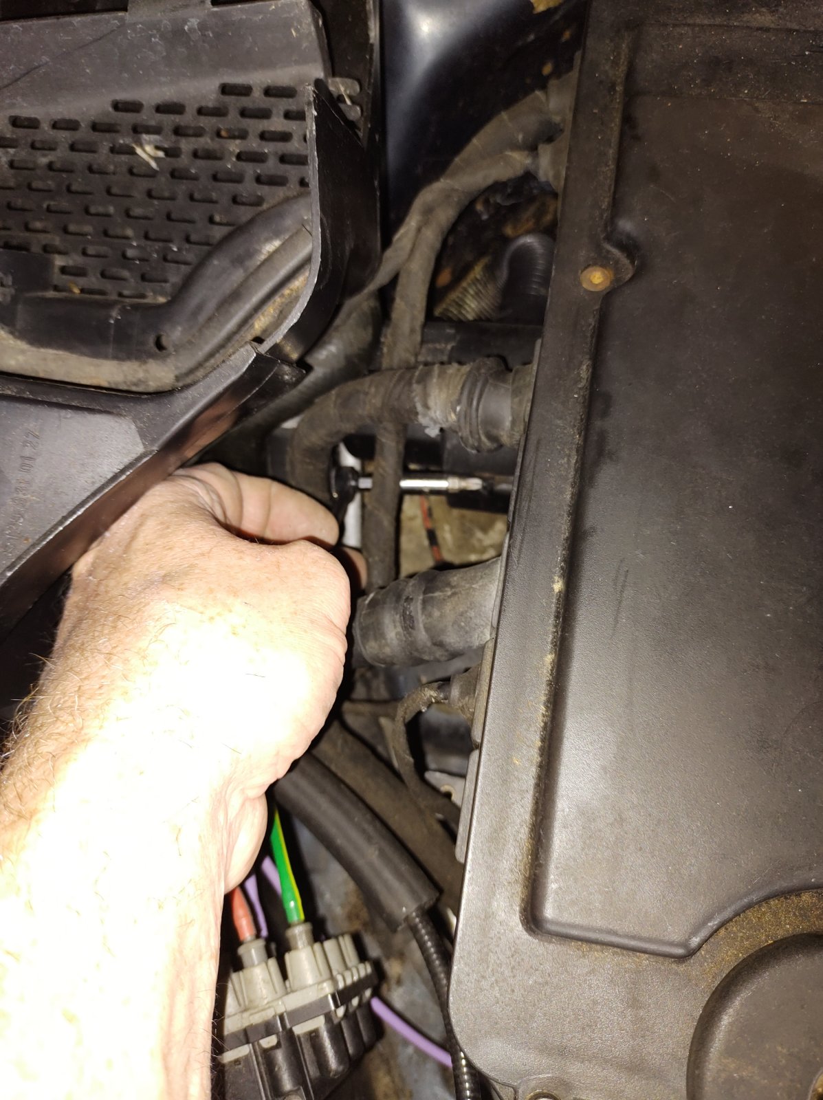

I started by cleaning the engine bay to remove as much evidence of mouse as possible. I sneaked a bit of time during the week with some TFR and a paintbrush followed by a gentle spraying off with a pressurised garden sprayer - all this meant it was in an acceptable condition for me to have a closer look at the wiring and other bits today. Out of all the wires that could have been chewed, they appear to only have got at the power wires for the small fan that cools the ECU compartment in the back corner of the engine bay. It was still a pig to get at though.
Trying to unscrew the fan - own work
I thought I might just be able to unscrew it and withdraw it - but it appears to have been assembled onto the ECU compartment on the bench and then the whole lot put in the car on the bulkhead - and removing this would have meant removing the interior. So that's not going to happen :roll:

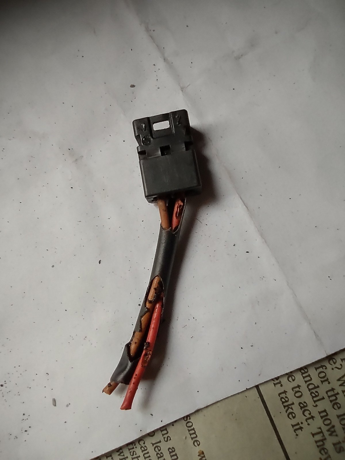

Instead, I cut off the chewed wires, de-pinned the plug, made good with new wires, and re-joined the wires back with soldered joints. It was a struggle as I've got large hands and there's bu88er all space to do anything - especially when you need 3 hands to join two bits of wire and hold the soldering iron.
Mouse damaged wires - own work
One thing I noticed - these two wires were the only ones I could find that weren't wrapped in waxed (or doped ?) loom tape. All the properly wrapped wires hadn't been touched by mice, whereas this one section of plastic sheathed wire had.

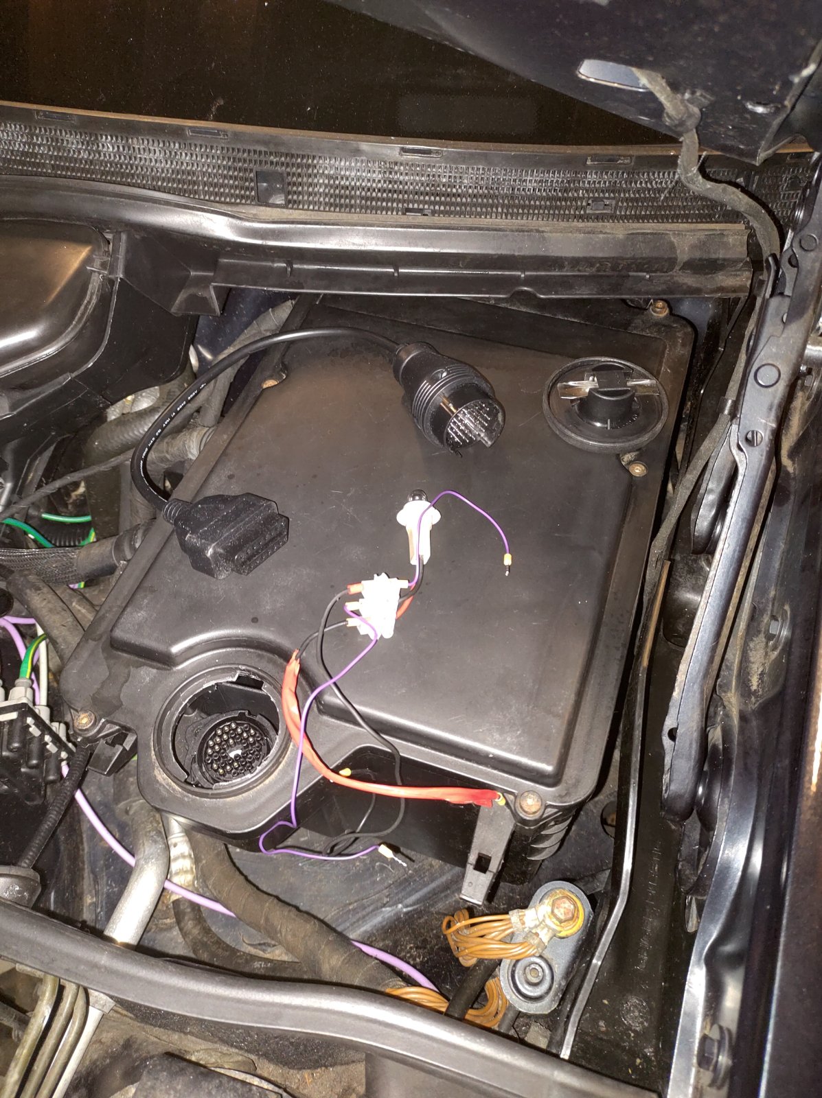

I then moved on to a diagnostics session. As this is a 1997 car, it all seems a bit vague with diagnostics. The car has a 38 pin round diagnostics port which seems to work with both a blink code reader and a conventional OBD code reader. I tried both to see what would happen :)
OBD port and 'readers' - own work

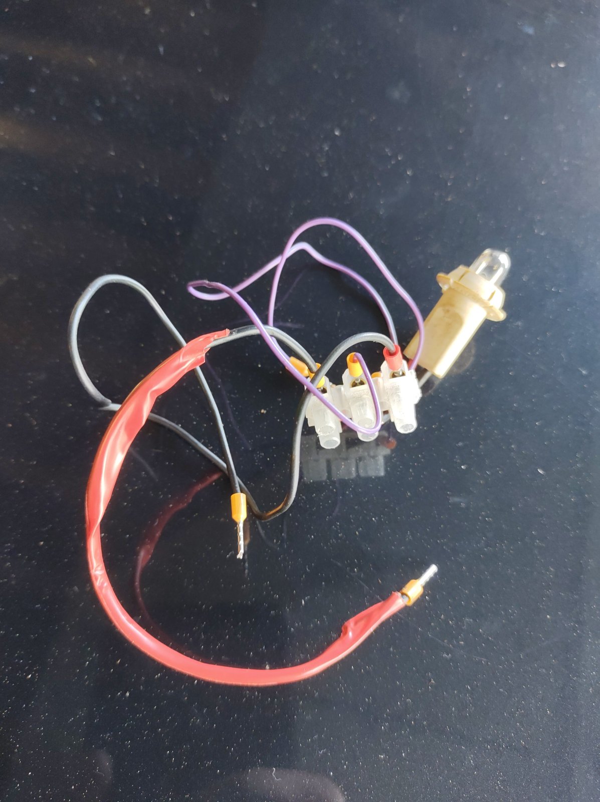

I built myself a blink code reader out of random bits of electrical stuff lying in the back of a drawer :lol:
Blink code reader - own work
It worked ! Or at least it showed no faults were present, so either I was doing something wrong.... or no faults were present. I also tried the 38 - 16 pin converter and plugged it into my Topdon 800BT OBD reader and surprisingly it found the correct protocol in the end and reported a very basic diagnostics with no faults. I'll take that as a result. No critical mouse damage and no faults found. Hurrah ! :-D

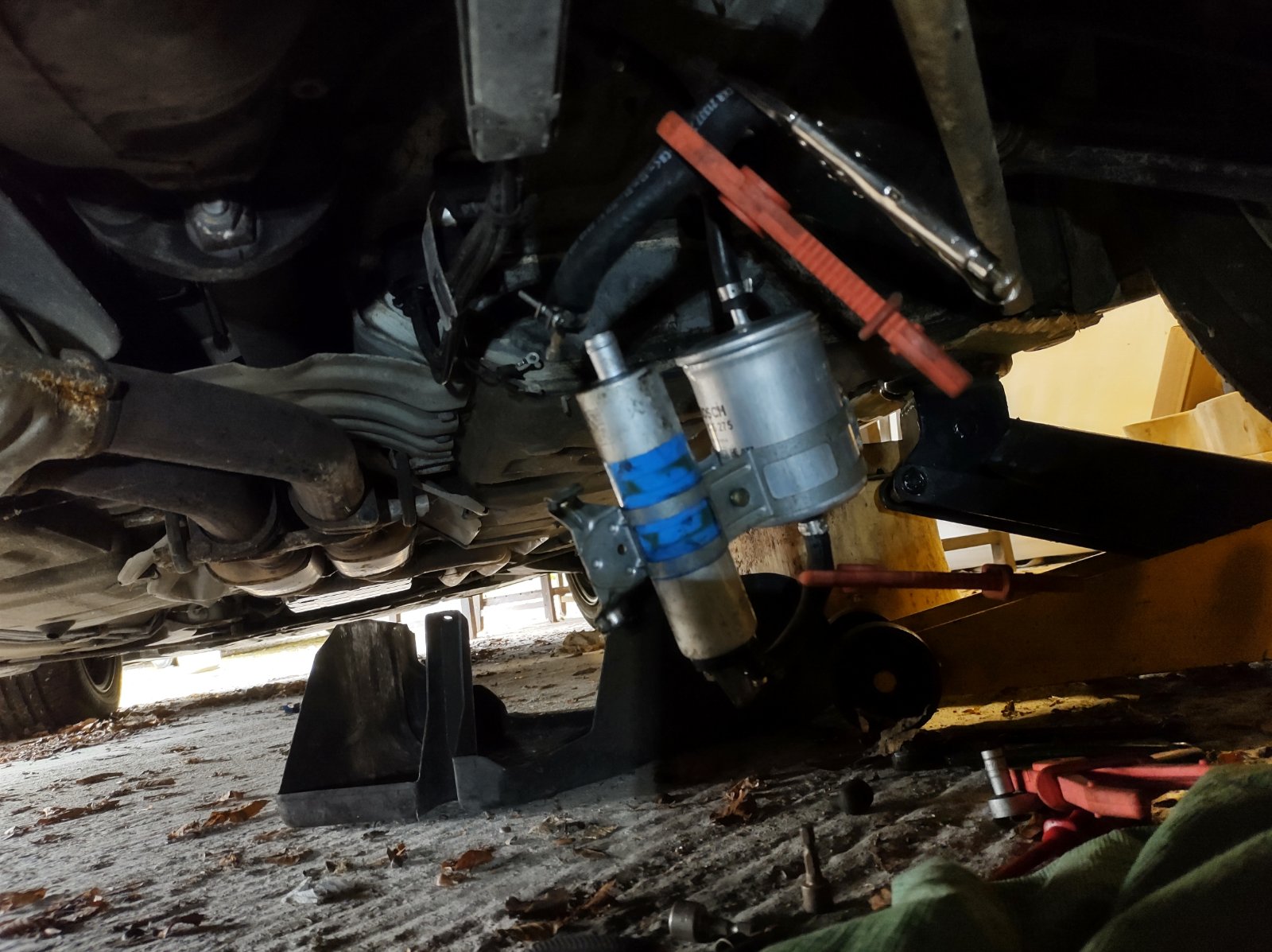

Next was fuel. I put a fuel pressure gauge on the injection line and found.......... no pressure. A-ha !
No fuel pressure can be because -
The pump isn't being commanded to pump.
There's no petrol in the tank !
The system is blocked.
The fuel pump relay is dead (a known issue).
The fuel pump is dead.
I know there's fuel in the tank as I put 20 litres in ! I know the filter is good as a new one was fitted when it was MOT'd and serviced a few years ago.... and it'd only done 0.3 miles since !! I voluntold a mate to help me check that the relay was getting a signal (it was) and I bench tested the relay and it worked. So..... by process of elimination.......
A dodgy fuel pump - own work
Jack up the car, check the pump is getting power (it was), hit it several times to try and get it going (it didn't), so remove it and order a new one. Prices range from £35 delivered, to just shy of £20million for a genuine Merc one #-o . I settled on a £100 Bosch one which will be with me early next week. Hopefully that might get the engine running :-D

New fuel pump fitted, repeatedly turn on and off the ignition to prime the lines and also open up the pressure testing point to bleed out some old fuel.
Crank it over and after a little hesitation it stumbled then burst into life - along with some ticking from the engine as things got lubed and the hydraulic tappets got working properly.

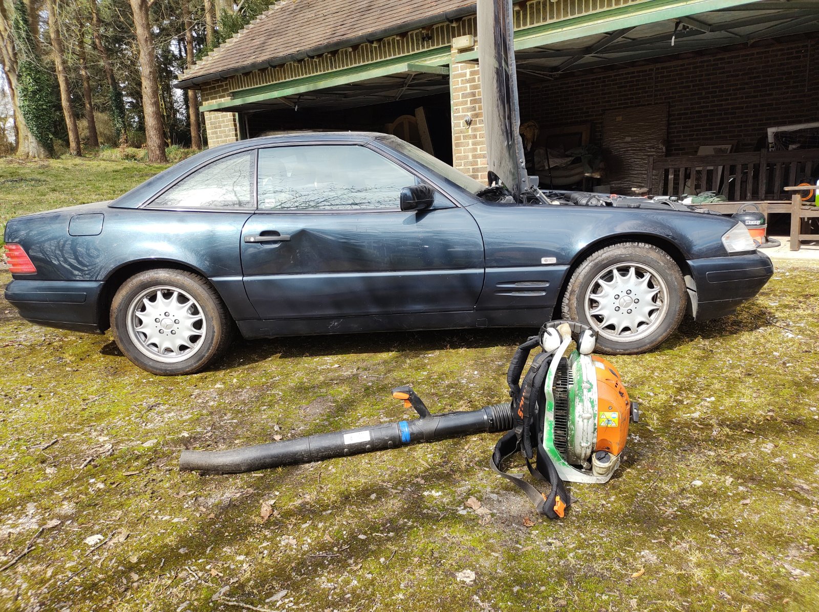

I tentatively eased it out into the open air and had a go at the engine bay with a backpack blower to remove even more mouse remnants - loads of bits of leaves and Beech nuts came out from all corners #-o
It's first drive in years - all of about 10 yards. - own work

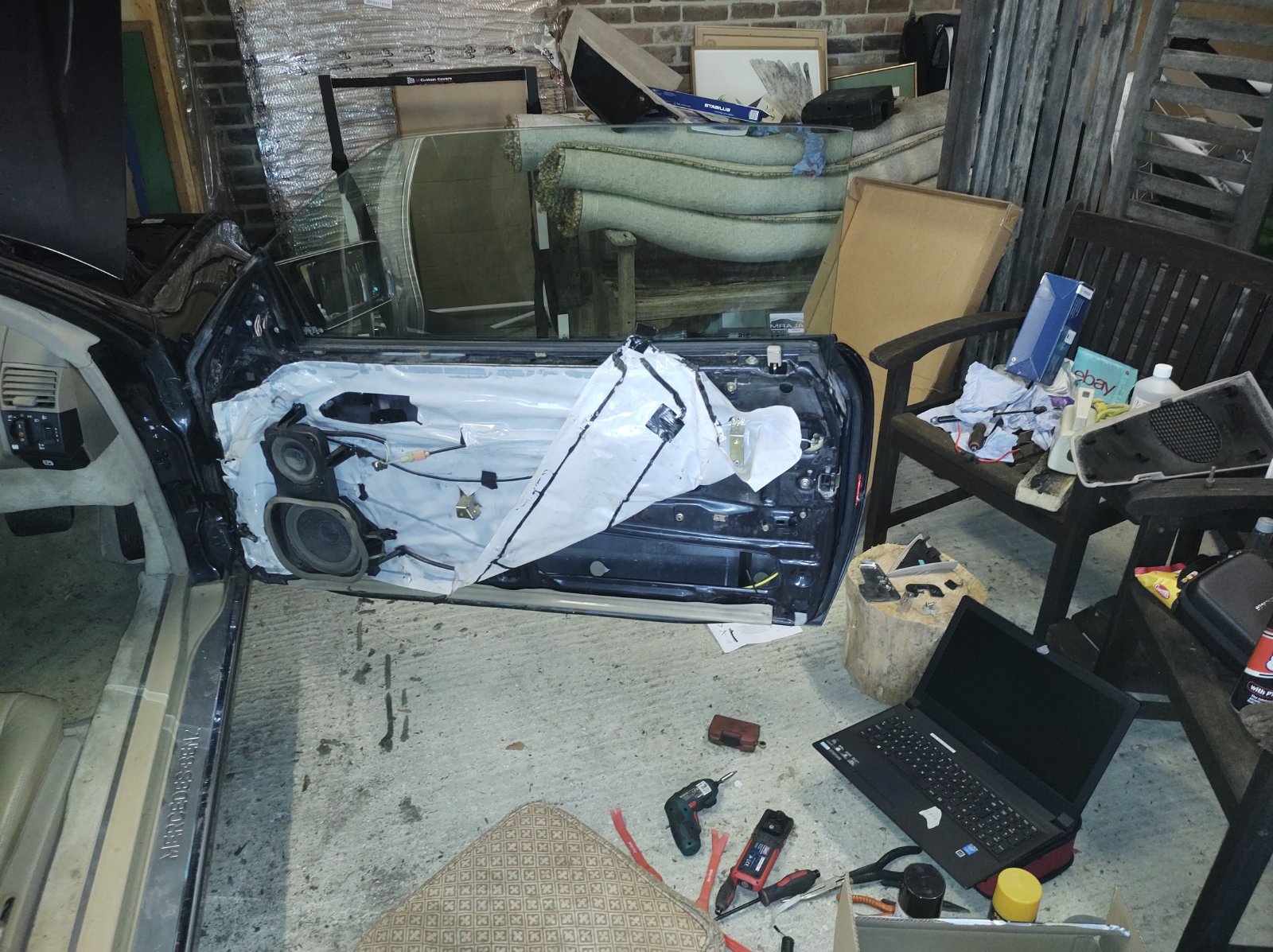

First up - both front windows were protesting when going up and down. A general slowness along with a few interesting noises were diagnosed as dry window runners, so door cards needed to be removed. A remarkably easy job to do - all things considered. A few screws and bolts tucked away which were swiftly undone, and a heave-ho on the door card in an upwards direction and it came off.
First - read the removal instructions on your dodgy copy of the MB workshop manual - own work
Second - reveal the inner workings of the door - own work

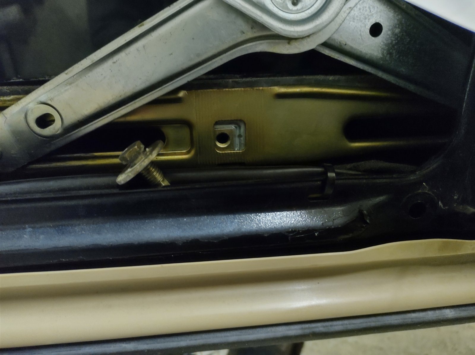

Silicon grease was liberally applied to the runners and winder mechanism, and in the process of grovelling in the door innards I came across an orphaned bolt. Easy enough to find out where it came from though. Shocking build quality though - after 27 years a bolt has come loose #-o :-D
AWOL winder bolt - own work

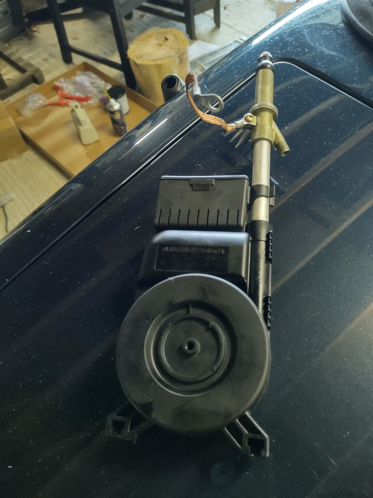

Next was onto the radio aerial. It'd steadfastly refused to retract all the way back so off it came for some benchtop encouragement.
A nAerial - own work
I stripped it as much as I could, and gently heated the mast whilst <ahem> tapping it home with a blunt object. Success - although it still protests a bit when fully retracting. More grease and lube was applied to the internals of the mast and gearbox and it was reassembled and put back from whence it came.

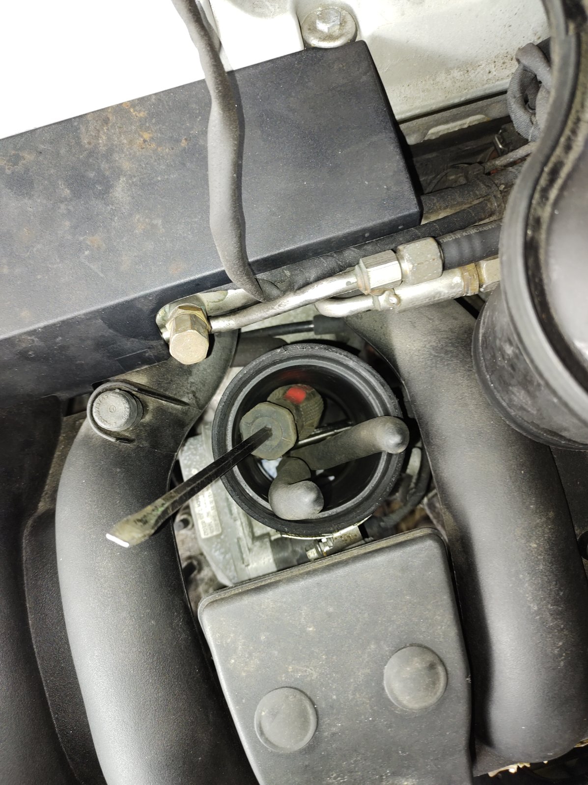

I'd noticed a light pool of oil in the inlet tract of the manifold - I presume it's just a result of the engine not really being used much over the years. I had to be resourceful to get at it to mop it up - prop open the throttle plate and use a really long pair of pliers to get some blue roll onto the oil to soak it up.
Intake tract oil removal - own work

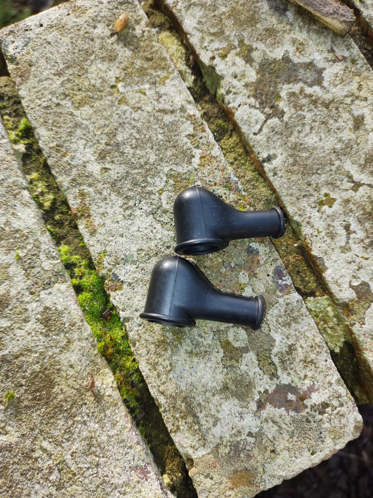

The only other job was a fairly simple one of putting new caps on to the fuel pump terminals. The Bosch pump I'd fitted didn't come with new rubber terminal covers, and the old ones fell apart when I removed the old pump - so it was a fairly simple job of crawling underneath the back of the car, taking off the power leads one by one, and slipping on the new rubber covers.
Pump terminal covers - own work
