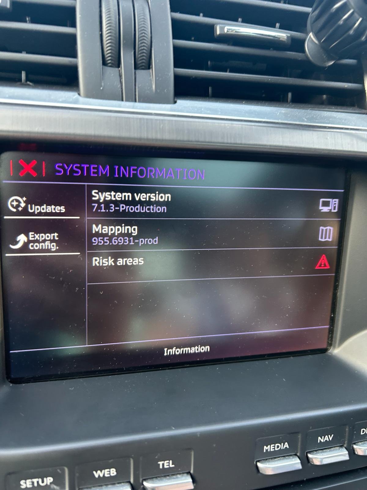

System version is 7.1.3

I think you may have got it back to front.
There was version 7.3.1-r1 released in October 2016
The last version for this system is 7.3.1-r3 released Jan 2019.
So have another look to confirm, as you may have the penultimate release (r1) and who knows if they provided an update that may allow Android Auto.
Let me know.

Re: Infotainment system
Ok, that makes sense with the additional info from the screen. Basically you have the version of mapping and hardware that were applied at the factory when the car was built, hence the 'production' references. These versions were not publicly released as updates, which is why I queried it.
So if you provide your VIN (Please post your VIN in full without spaces - it will be automatically masked from public view after submitting your post & will only be visible to staff) I should be able to provide you with the latest firmware update as you are 3 versions behind the last update there will be for this unit. There have also been 18 map updates since your version too.
