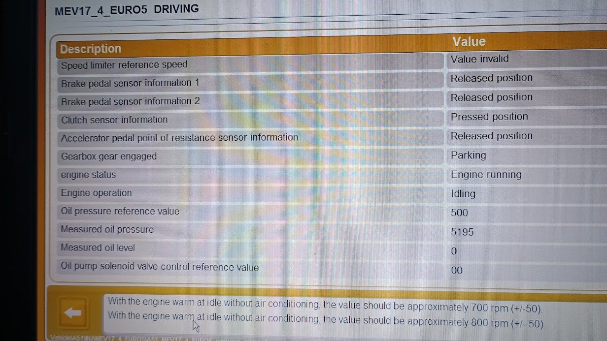

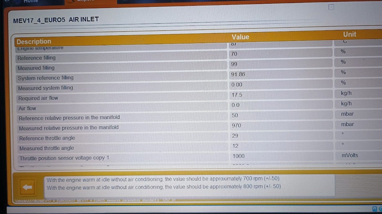

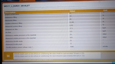

I had a session with DiagBox last night. From cold, car fires up straight away and enter the oscillating idle phase (and is unresponsive to accelerator pedal). Reference filling and measured filling dancing all over the place.

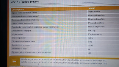

I observed the oil pump was happily under control, reference and measured pressure were stable (around 3300mbar from memory), and would be seen to be tracking up and down with engine speed.
I've never seen it before, but after some running, the ECU showed a permanent fault on atmospheric air sensor.
And although looking settled...the oil pressure has gone sky high (5195mbar): Ref pressure seems wrong - and the control loop is doing what its told - solenoid drive zero%, trying to control it.
....but the oil pressure reference value also looks wrong - perhaps as a result of the atmospheric pressure reading being odd: How many air pressure sensors are there? I thought there was just the one - inlet manifold.
Any red flags from the above pictures? It seems like just one thing is likely to be wrong....Also of note; I used to get P1667 ECU internal fault (permanent) which has now disappeared!

I would expect that there is an atmospheric sensor, maybe part of the throttle assembly.
The oil pressure readings do seem strange. I think that it would be worth checking the 5V reference voltage that goes to the sensors, and check that it is not fluctuating.
