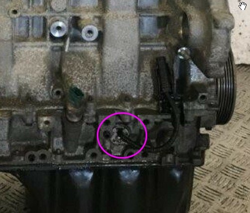

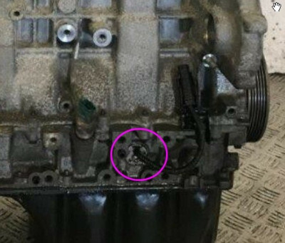

Hi, after a bit of reading I'm hoping to replace a 5FS/EP6C engine in a 2011 C3 with a 5FW/EP6 engine from a 2008 207. All going ok so far, but the 5FS has a sensor in the sump area that the 5FW doesn't. Can anyone identify this please:
Worse case scenario, I may have to change over that section of the crankcase - not that keen to disturb bearings.

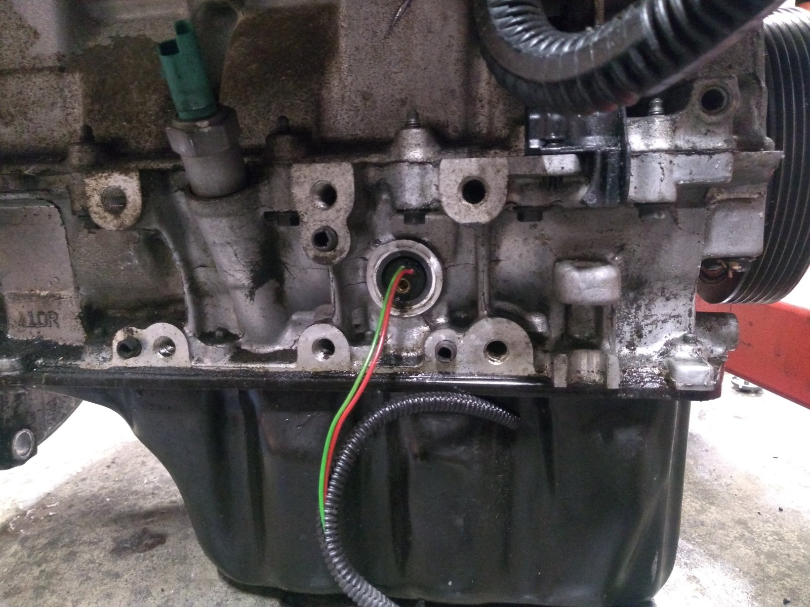

Better picture tonight:Image

Re: C3 Engine swap - mystery sensor
Unread post by RichardW »
I think it's not actually a sensor, but in fact feeding a solenoid on the oil pump, presume the ECU has control over the oil pressure somehow.
jcmnz
Posts: 13
Joined: 02 Aug 2022, 04:00
Unread post by jcmnz »
Thanks - that's it; I've found pics of the controlled oil pump with that cable hanging out. I wonder if the ECU tries to servo control the oil pressure or just open loop output to the pump solenoid. DiagBox might show me if there's a linear oil pressure reading; if not, then I can just remove the solenoid and keep it on the outside of the 5FW engine. Worst case - I have to swap over the lower crankcase and controlled pump. I'm always scared to disturb crankshaft bearings...but maybe I can swap the shells over to the 5FS casting without any problems. It seems like a lot of messing around, but finding a 5FS was proving difficult/expensive!
