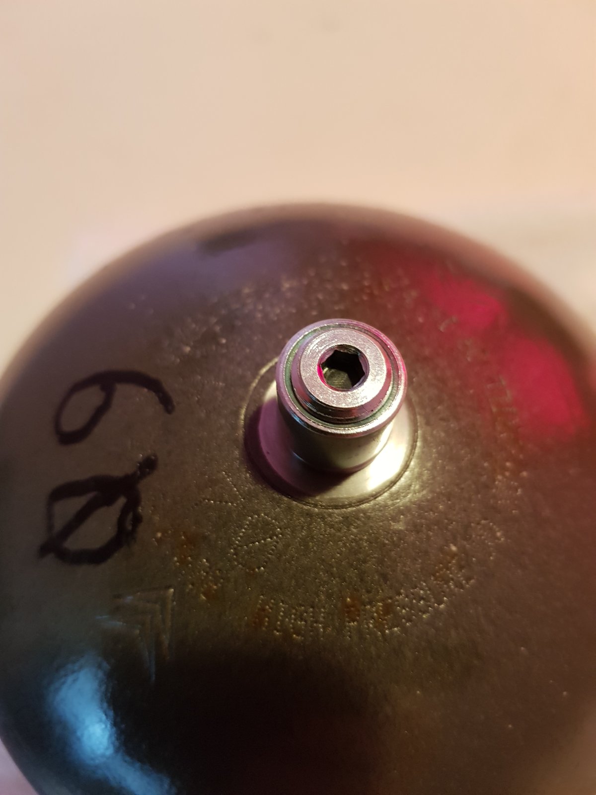

The residual pressure (filling pressure or taring pressure) of a spring ball can only be checked if the ball has been removed.
A special testing device is available from the Citroen dealer for this purpose.
It can be used to check all spring balls (LDS or LHM).
Many hobby mechanics have built such a device themselves.
Of course, original LDS balls can be refilled - the triple diaphragm lasts a very long time.
Replica balls are less suitable because they only have single diaphragms.
A thread must be cut for the filling valve and special tools are required to fill the nitrogen.
Specialised companies or hobby screwdrivers with the necessary experience are available for this.

A company in Italy provides different parts for refil the sphere's.
I machined mine, and refill them.
Greetings,
Kees.

Hiya Stu, Plieades are still recharging spheres and they are able to do the C5 spheres. I had my 4x corner spheres recharged by post a little under 2 years ago now. I had opted to replace the centre hydractive spheres with aftermarket ones. The center ones were very difficult to remove - the rears were the tightest I've ever experienced and the front center one is impossible to reach.... Actually, now I think of it the rear corner ones required both rear struts out to remove the spheres and they were still so tight that I thought my HGV chain wrench would snap.. It's been 2 years and I'm interested to get the Plieades ones on the sphere tester to see what pressure they have. The car rides like an airbed

Here was some chat from when I got the spheres back from Plieades. viewtopic.php?t=72145 I had agreed to send them and wait for their turn around time (a week or so) because they no longer do their old exchange because they simply do not have enough old spheres (or any Martin had said) so to keep the car on the road I temporarily fitted a pair of Xantia Hydractive spheres to the C5. They were a lot stiffer when the C5 switched to sport mode.
