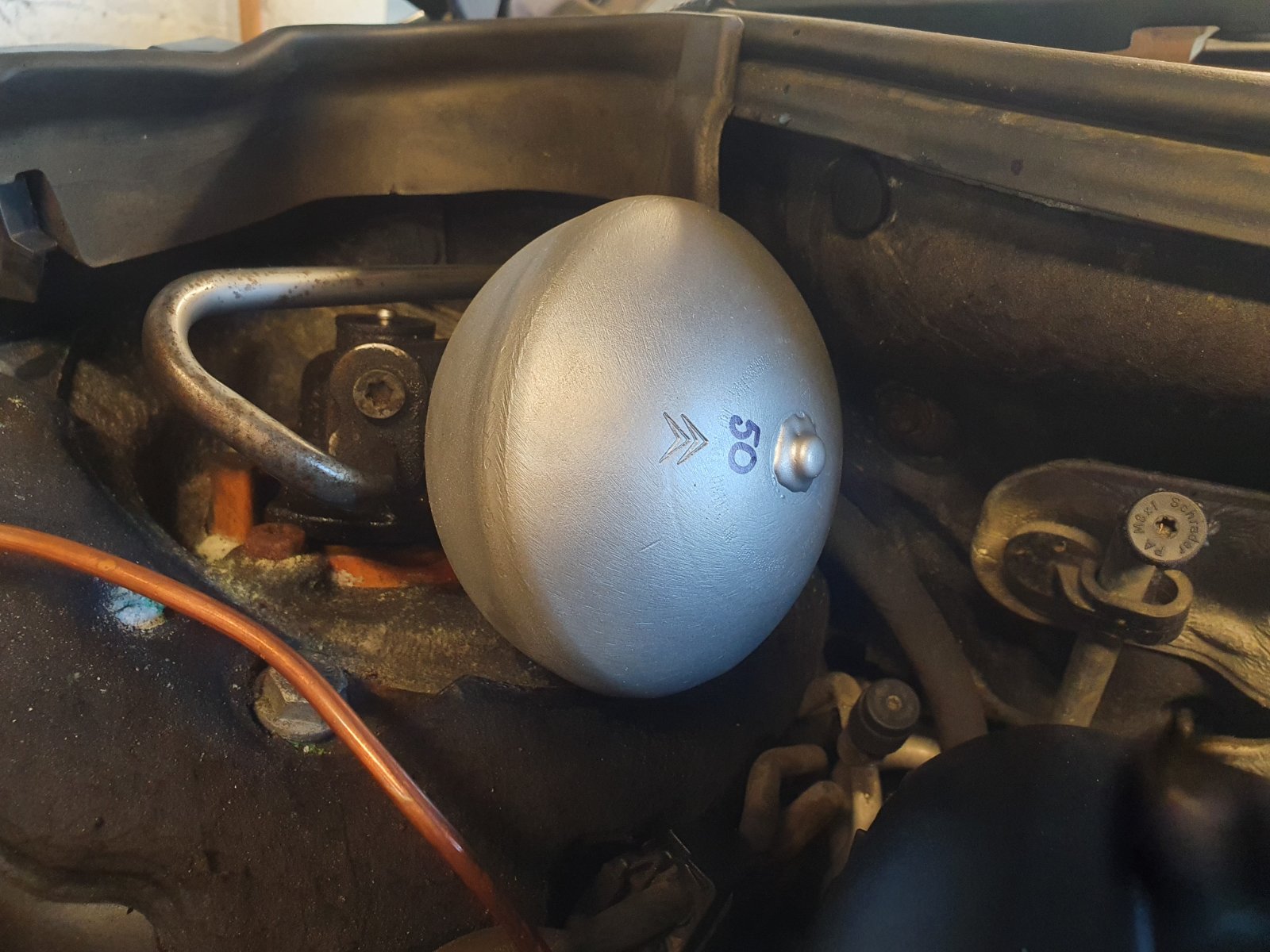

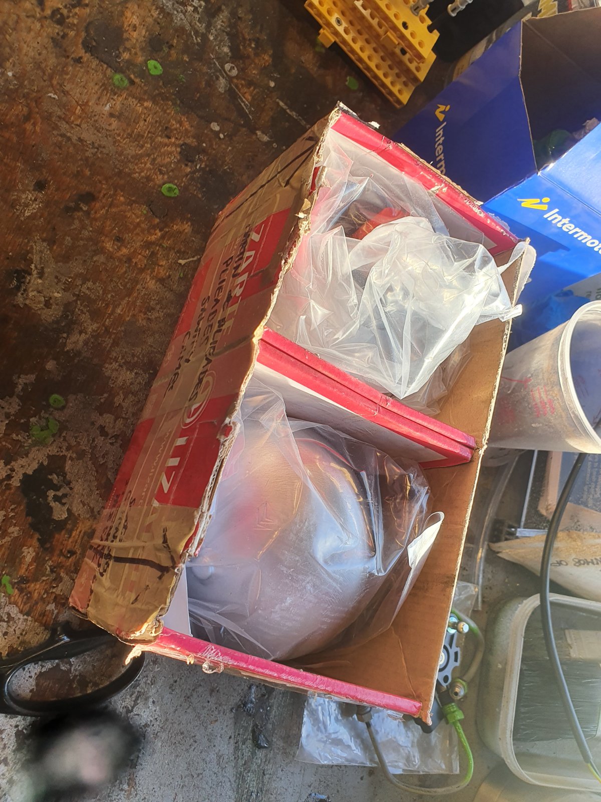

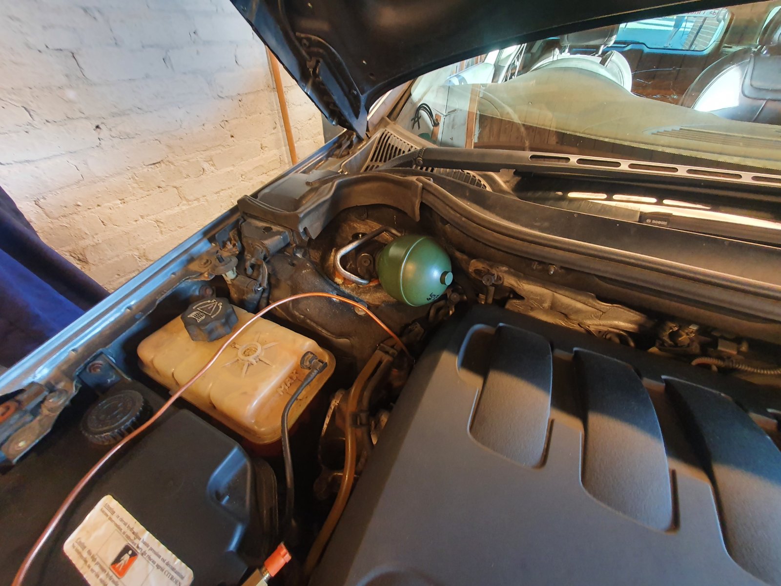

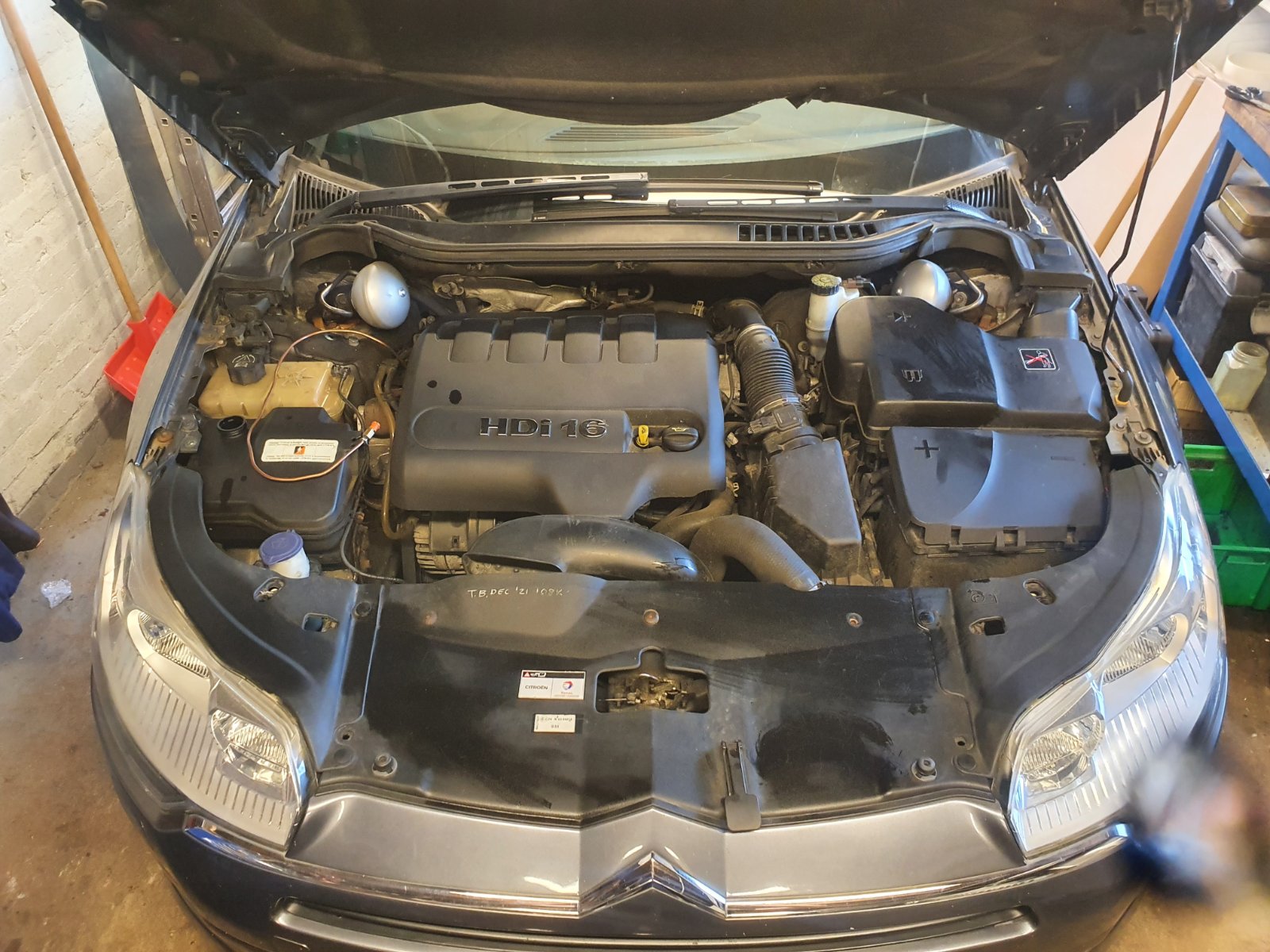

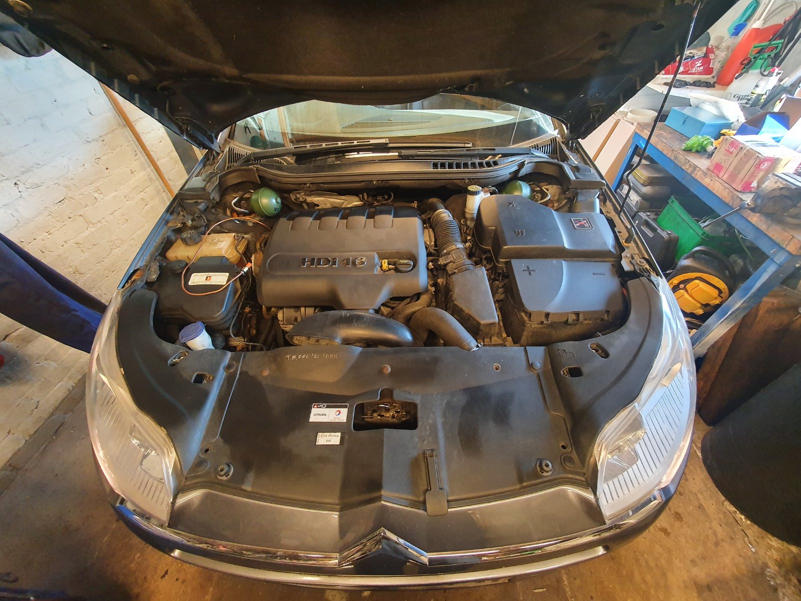

Ok, not new but regassed. I sent my front corner spheres to Pleiades for recharge and they did a champion job and returned very quickly. Repainted too.
I am delighted with the ride quality now - a new front center sphere and now regassed corner spheres, new rear center pair. If only I could actually remove the rear corner spheres I'd have sent them too but that is for the future...
Some pointless photos of my childlike excitement:
..And! the drive home was incredible - unbelievable magic carpet ride and still good enough cornering. It's incredible how much of an effect the corner spheres add to the overall floatiness. Generally the car is riding better than ever now.

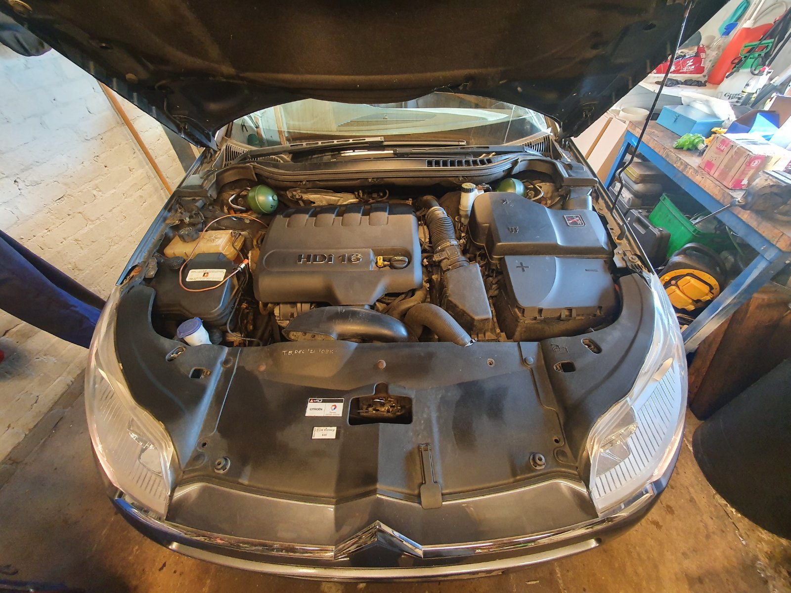

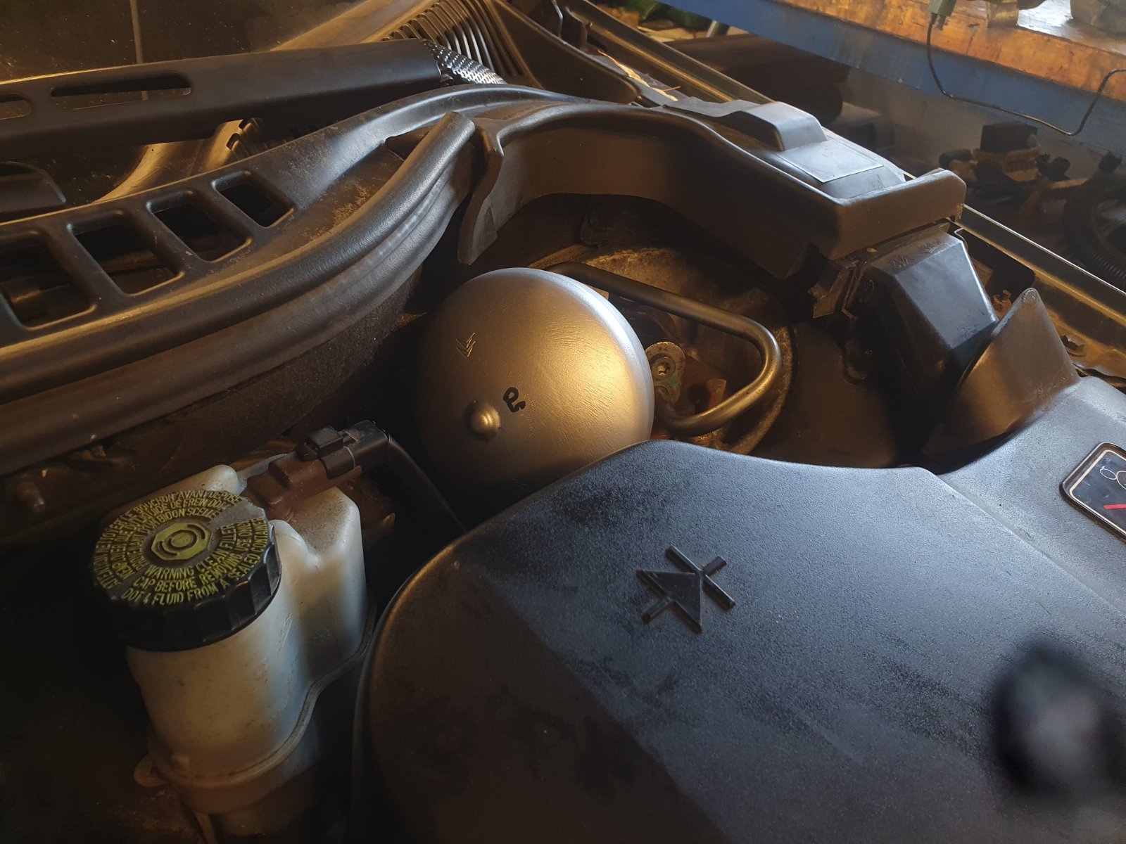

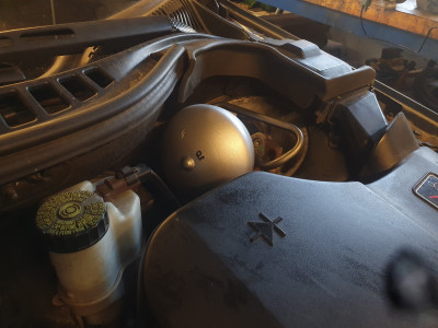

Hello! I want to change central front sphere too, same Citroen C5, I have this central sphere on the left side in my 2.0 HDI RHR 2009 Citroen C5 (we are driving on right side in Poland). How to change it most easily?
Kees
- Posts: 591
- Joined: 16 Nov 2021, 16:16
- x 147
Re: New suspension spheres!
@Maciejz:.
For the center sphere on the left side, you have to remove the left drive shaft and the 6mm bolt beneath the subframe with hold the airco tube.
Then with a long chisel you can hammer it loose.
It's not really difficult.

I would be cautious trying the method with a chisel because the mounting frame for the front firmness regulator is an aluminium casting with 3x rubber flexible mountings. I managed to snap this mounting on mine trying a similar method. The service method is to lower the front subframe to remove the full assembly and remove the sphere from the assembly off the car (C5 spheres can be very tight).Kees wrote: 25 Apr 2024, 13:40 @Maciejz:.
Greetings,
Kees.
You might have success this other way but take lots of care.

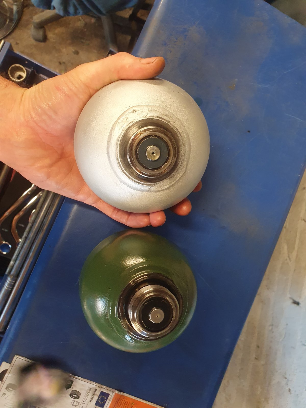

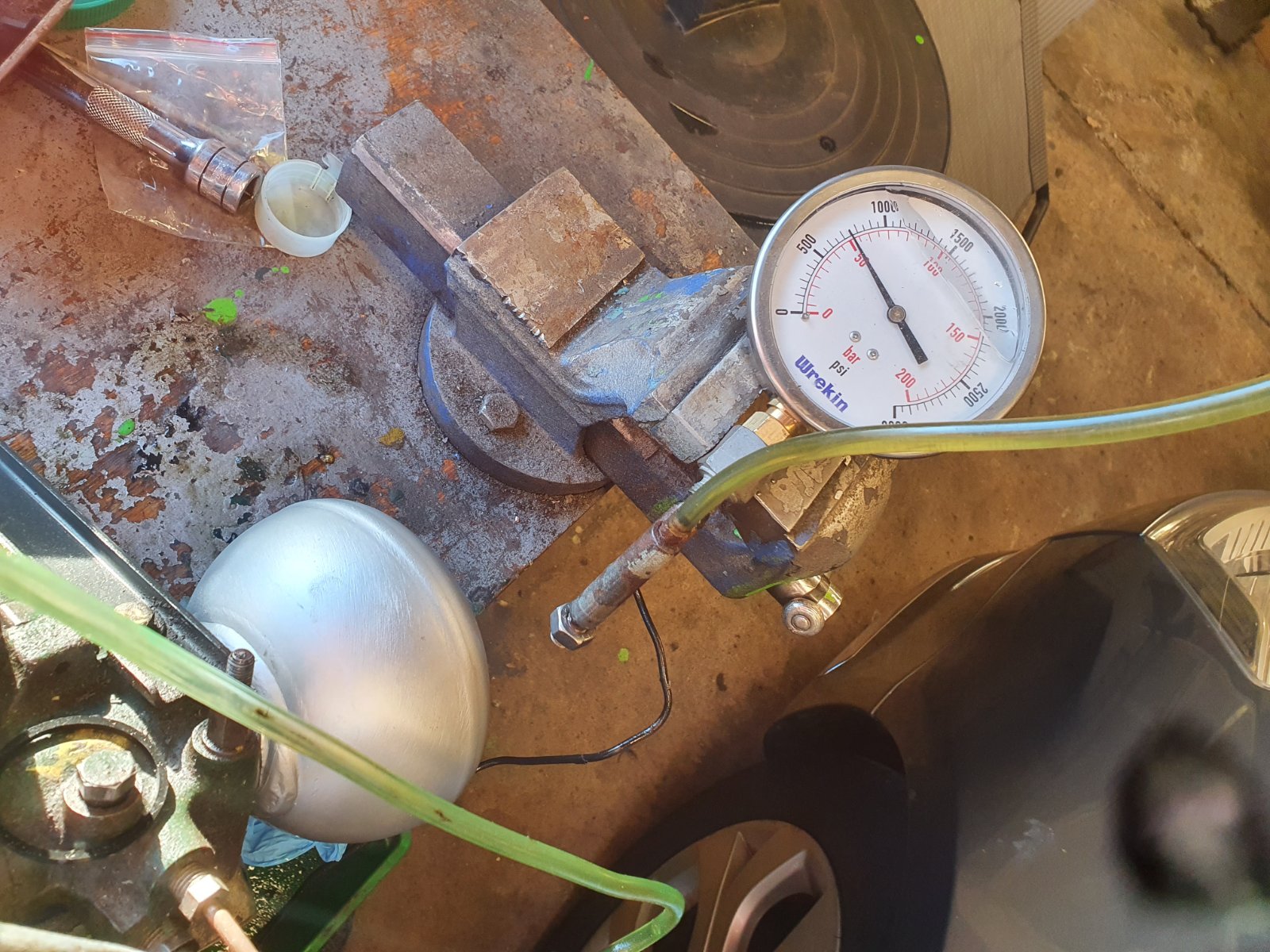

Hi it took a lot of attempts before the mounting broke. The sphere was immensely tight. Possibly corrosion. All 7 spheres on my C5 were as tight as this. I was Possibly unlucky.
Curiously though, I recently had the front subframe off to repair the steering rack. I decided to take the opportunity to remove the front centre sphere after 3 years to test the pressure. I fitted the sphere 3 years ago with a film of grease at the mating faces and also tightened it to hand tightness. Despite these precautions I found that it was again very stuck. So I don't really understand why.

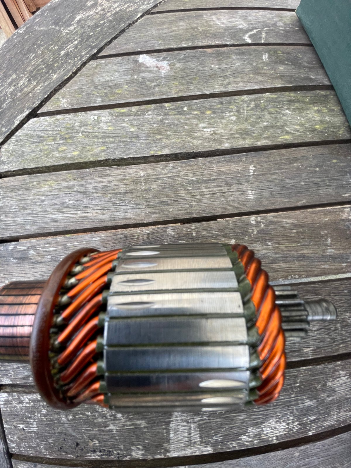

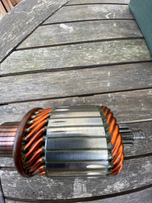

I'm missing all this fun with the Audi but just had to replace the starter motor, have a look at the armature in the attached photo
Kenny
