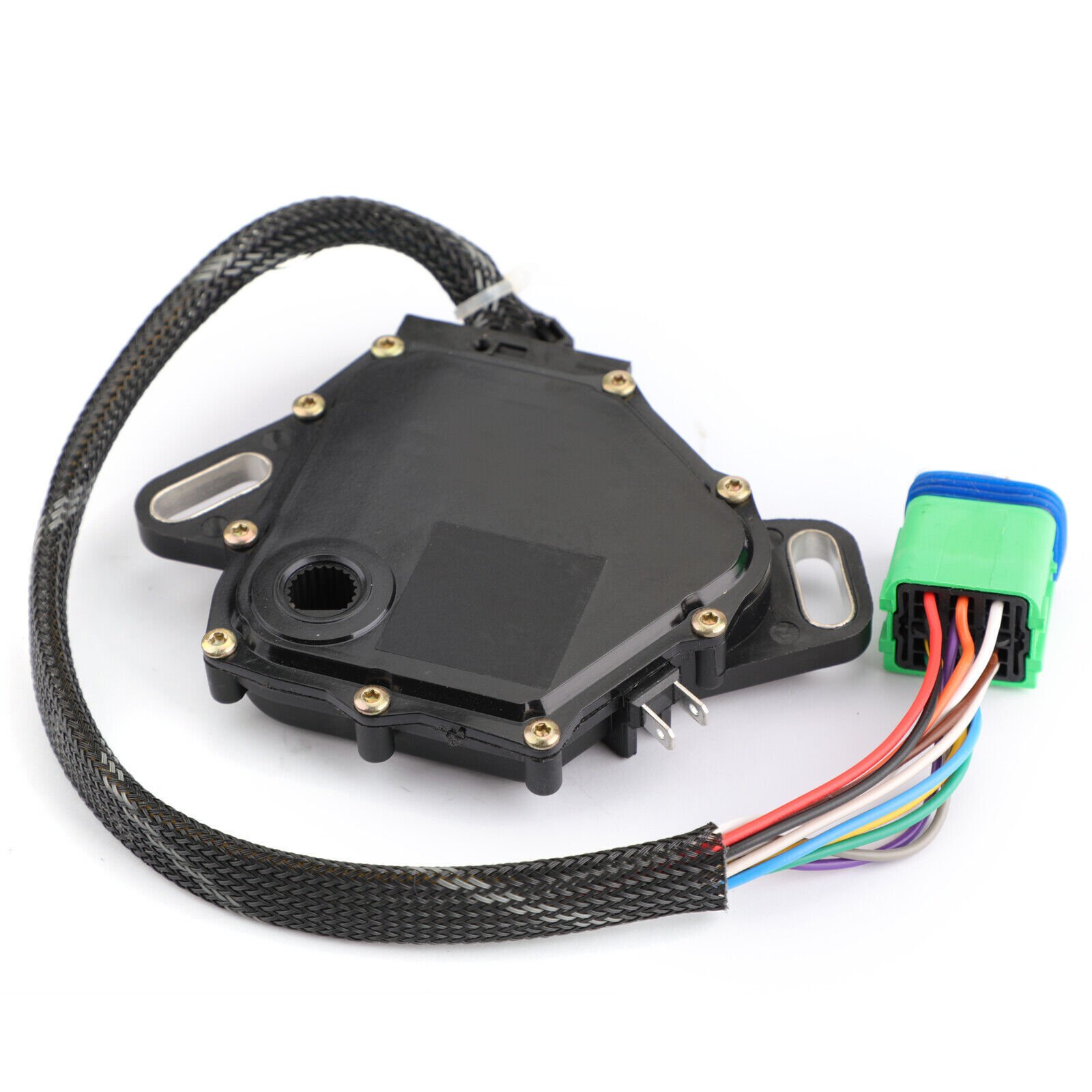

On the top of the gearbox is a rotary switch assembly. This is between the selector cable from the cabin and the selector input to the gearbox.
This tells the gearbox and other things which mode has been selected by the driver.
For safety, the engine can only be started in P or N. It seems that that safety switch is not working correctly.
Either the switch is miss-aligned slightly or the switch is faulty.

Do you have a photo or document of the part that you think is defective?

How do I find the part code?

Re: citroen c3 - 2005 - My car doesn't start
The switches are very easy to find on ebay.
You can also try undoing the the 2 mounting screws and rotating the whole switch A VERY SMALL AMOUNT in one direction or the other.

Thank you for your support. I will lift the car as soon as possible and check this underside. I think the part is on the automatic transmission.

On the top of the transmission, not the bottom.
Between the battery box and the thermostat housing.

Hello everyone. Fixed the issue. I changed the defective part today. Fixed the issue. The sale price of the defective part in Turkey is $61ozvtr wrote: 04 Mar 2024, 20:52
