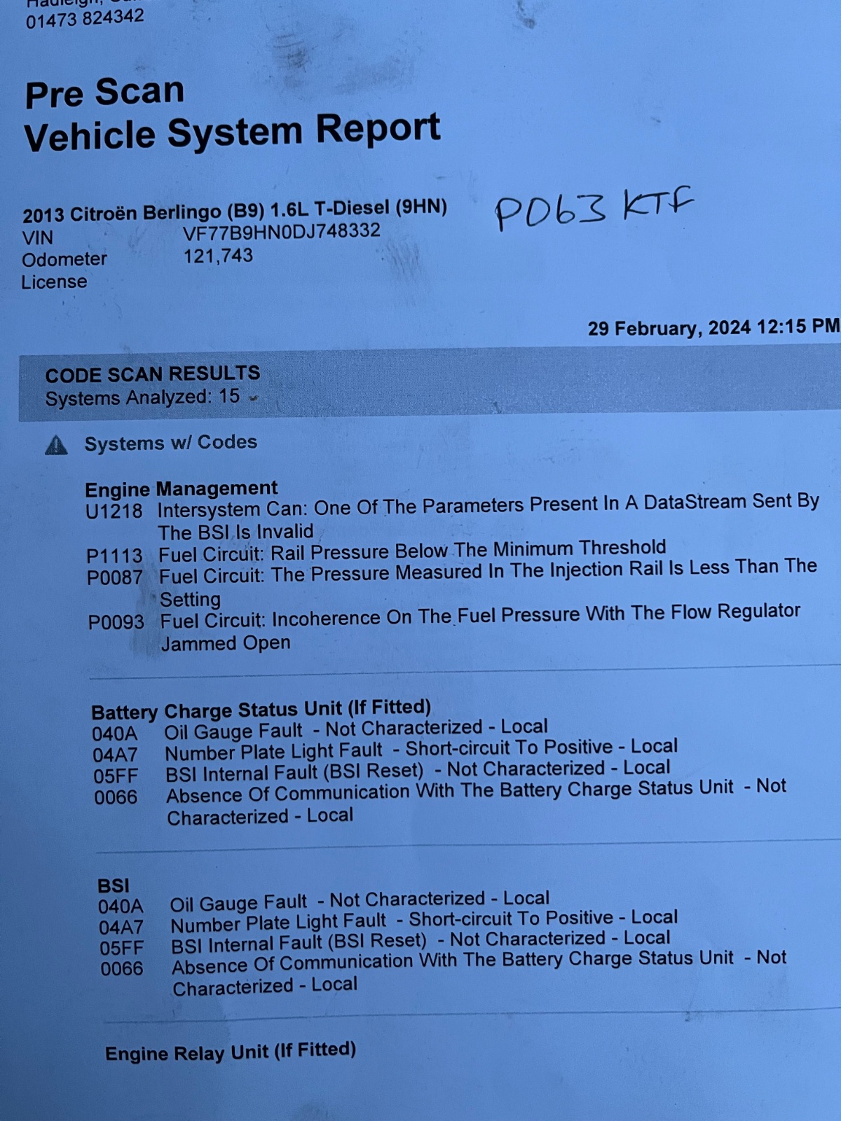

Hi I’m wondering if anyone can help. I have a Citroen berlingo 1.6 HDI van 13 plate. Whenever I accelerate hard or put my foot down in a high gear the engine either shuts off with the red stop light or it jolts and the engine light comes on and the triangle light. The fan then stays on when I turn the engine off along with the triangle light.
I’ve had a new fuel filter fitted twice and both times the van has run perfect for a week with much more power and smoother to drive then the same things starts happening.

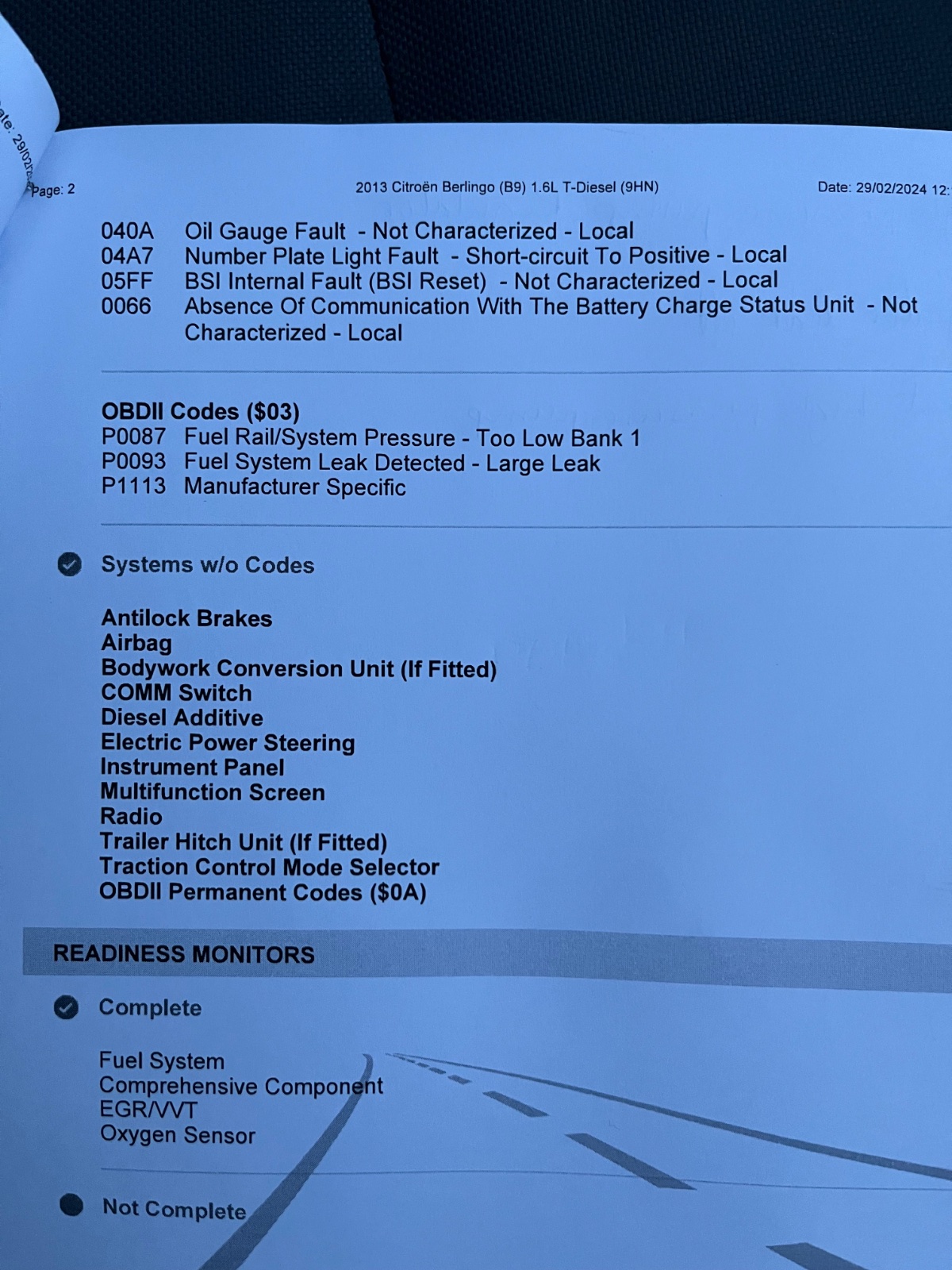

I took it to a garage and these were the fault codes.
x 6957
Re: Citroen berlingo 1.6 HDI engine shutting off
So her are the main faults concerning the fuel system. So I'd focus on these first, but basically the fuel pressure in the rail is insufficient and this is despite the regulator fully open. So looks like a blockage in the fuel system before the fuel gets to the regulator or the regulator itself. Do you run the vehicle on 'fumes'? If so, gunge and diesel sludge will be a factor getting picked up; or the fuel filter has not been put back on correctly and the circuit primed properly are things I can suggest.

Fault Code: P0087
Description of Fault: Fuel circuit: The pressure measured in the injection rail is less than the setting. The pressure measured in the fuel high pressure common injection rail is lower than the reference value for 800 ms even though the electrovalve is open to the upper limit.
Conditions for Fault to clear:
  • Ignition switched on
Downgrade Modes whilst Fault is active:
  • Reversible deactivation of the vehicle cruise control
  • Activation of the cooling fan at fast speed
  • Switching on of the warning lamp and/or warning message: Warning lamp MIL
  • "SERVICE" warning lamp
Symptoms:
  • Jerking/stalling
  • Lack of power
  • Starting problem
  • Absence of automatic stopping of the internal combustion engine (Vehicle equipped with "stop and start")
Suspect Areas:
  • Clogging of the fuel filter
  • Air leak on the fuel filter
  • Leak in fuel circuit (low pressure)
Fault Code: P0093
Description of Fault: Fuel system: Incoherence on the fuel pressure with the flow regulator jammed open. Excessive under-capacity of the injection system to provide the pressure for the flow in progress. The pressure measured in the fuel high pressure common injection rail is more than 250 bars lower than the reference value (For 800 ms).

Low fuel pressure faults were P0087, P0093, P1199 i think. Measured fuel pressure falling behind instructed under load.
