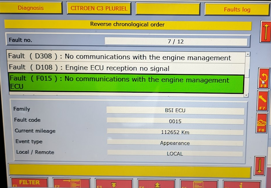

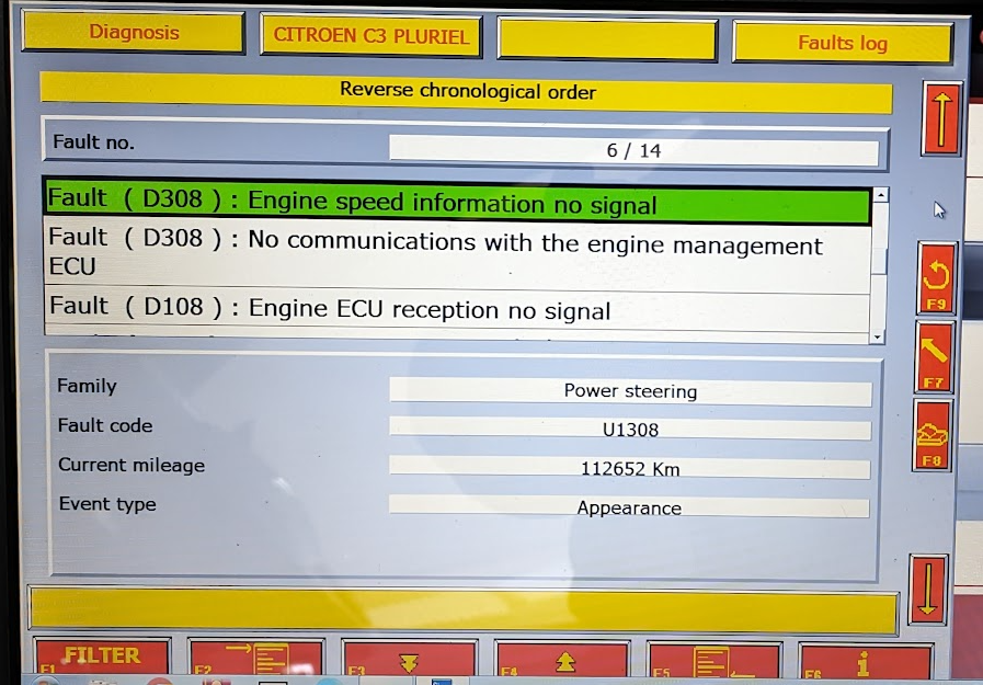

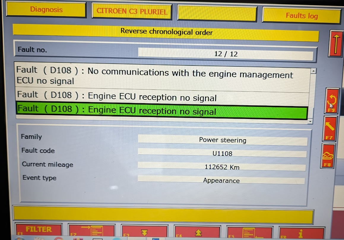

So I connected Lexia, which showed up 157 fault codes including no coms with engine management, absense of +permanent on the display, power steering faults, abs faults, ecu reception no signal and also two unknown faults that showed the odometer reading at 262140km when in fact it 112652km.

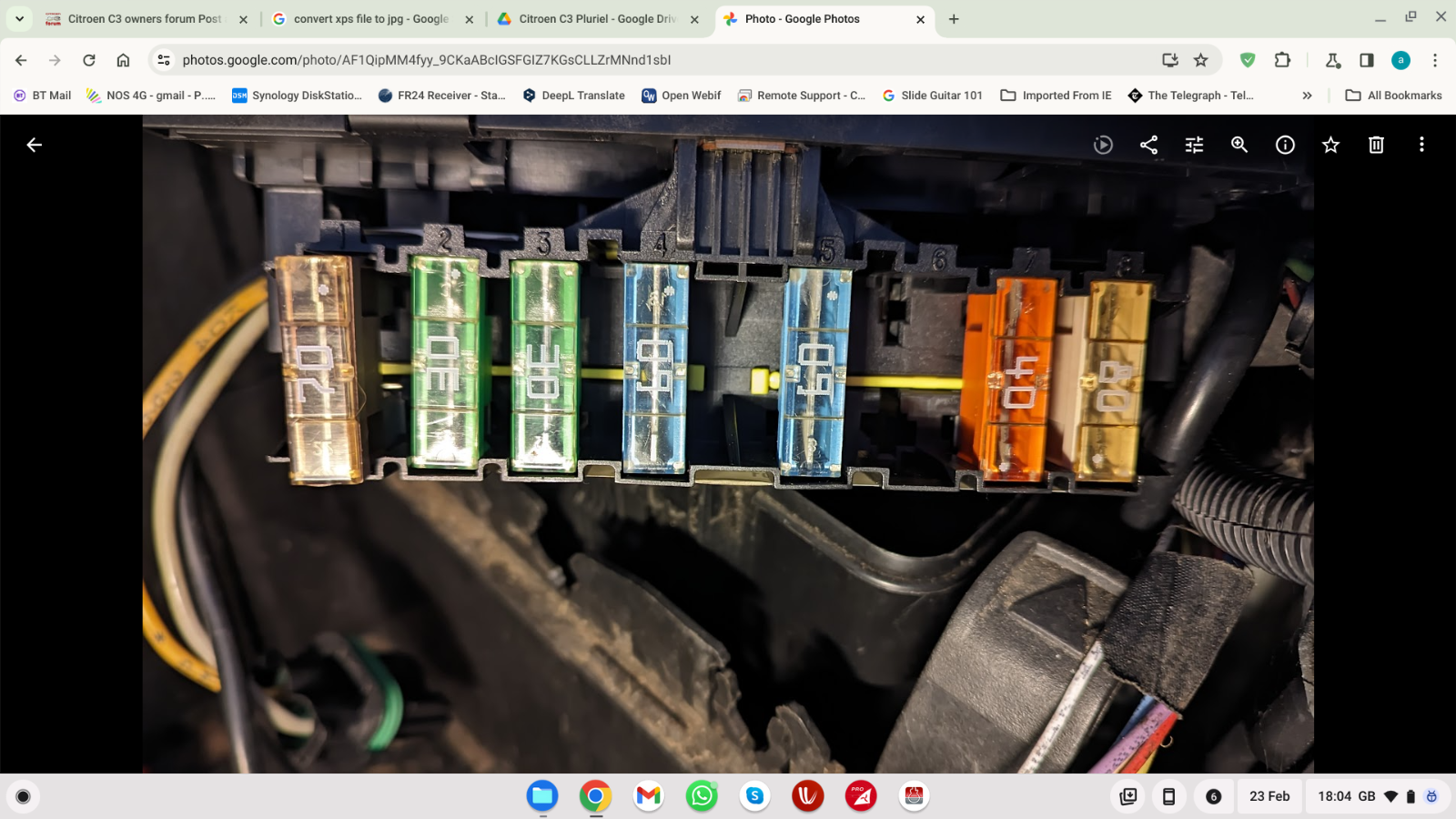

The battery is nearly new and I have pulled, checked and tested all the fuses in the engine bay and the interior fuse holder.
Tomorrow I will do a another bsi reset and try to start the engine. Will then connect Lexia and grab some screen shots to post here.

OK, I pulled every fuse and checked continuity with a multimeter. I also dismantled the engine bay fuse box and checked all Maxi fuses. All ok.

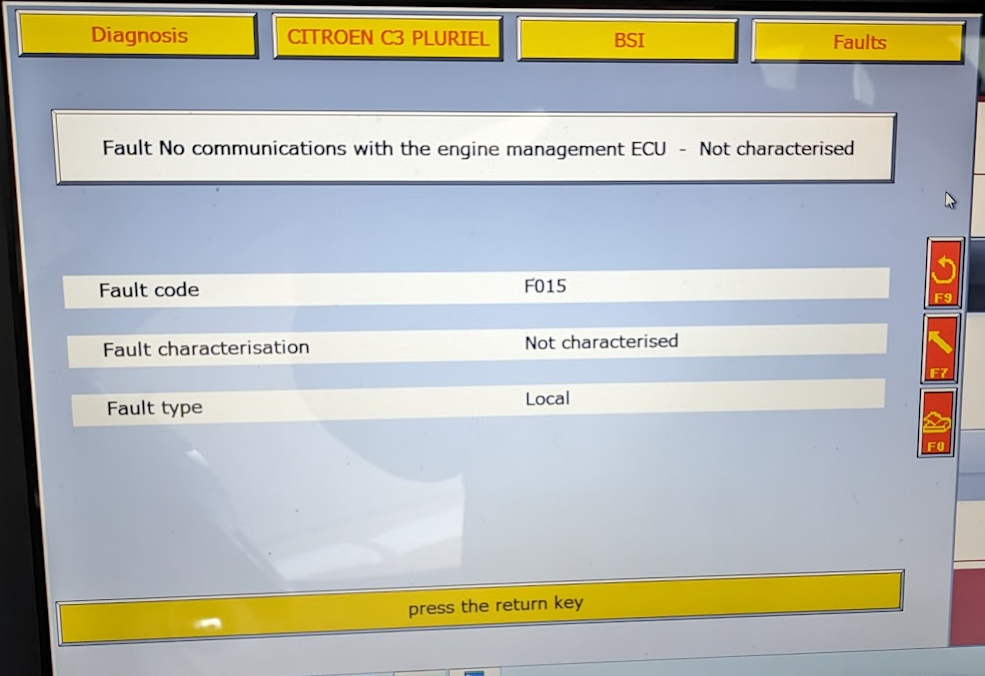

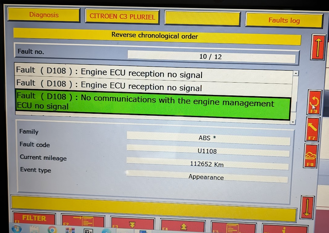

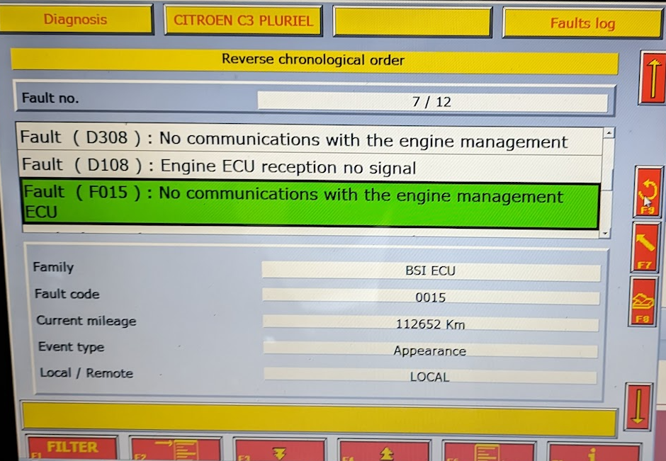

Here are copies of screenshots from Lexia

These are the codes left after erasing all fault codes in Lexia except these that couldn't be erased.
I then tried to start the car but same problem, I turn the ignition key and the engine does not turn over. Battery is fully charged.
Could the immobiliser cause this?

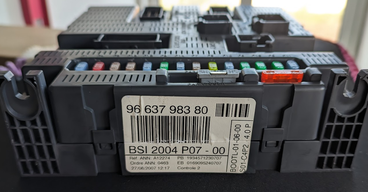

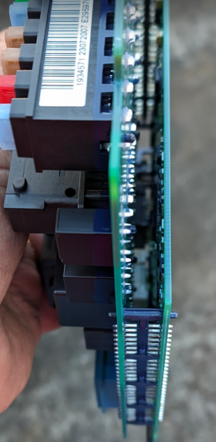

AllanA
- Posts: 42
- Joined: 07 Sep 2022, 11:05
- x 5
Re: C3 Pluriel Electronic nightmare!!

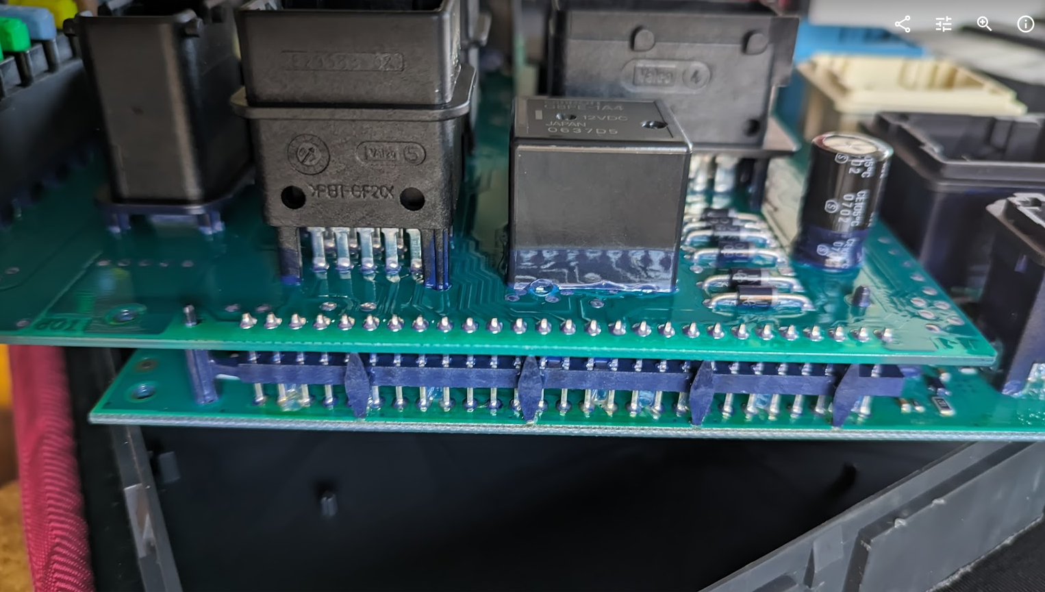

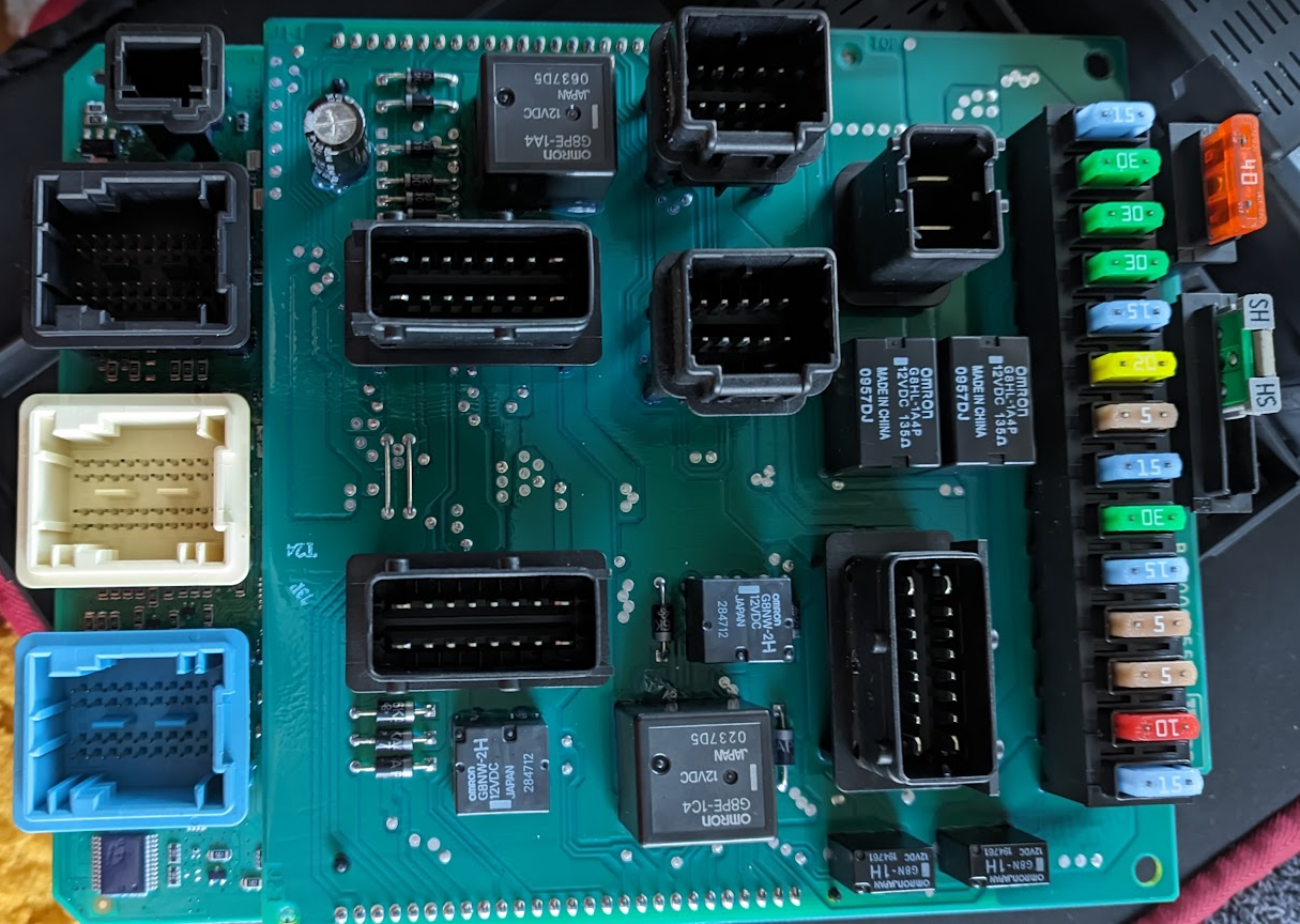

Some BSI pics showing the two boards soldered together not pressed together as in the earlier Pluriel model
Being a 2007 model, your electrics are 'all CAN'. CAN BUS is the protocol that the ECU's use to talk to each other. Previous models had a mixture of CAN and VAN BUS. That's why your BSI is different.
The BSI, ABS and the power steering ECU's are all complaining that the engine ECU is not talking to them.
Until the engine ECU is unlocked the starter wont engage. So that's normal given the circumstance.
Either the engine ECU is not working or the CAN BUS connection is cut.
Typical failure mode is moisture getting into the ABS connector and corroding the contacts. The CAN BUS to the engine ECU "piggy backs" off the ABS connector.
If that all looks ok then you will need to see if the engine ECU is getting power and ground.

Hi ozvtr. Many thanks for your comments above. I refitted the BSI today and once all was connected I was really surprised, the car started and ran perfectly for some minutes. I cleared all the faults in Lexia fault log and did another diagnosis which showed no faults!! BUT then the engine stopped and same old faults flag up as before. No comms with the management ECU.
So it's really interesting that the ECU takes its feed from the ABS connection. That's where I'm going to look now and I'll update you on any findings.

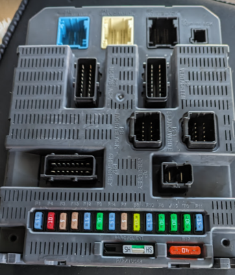

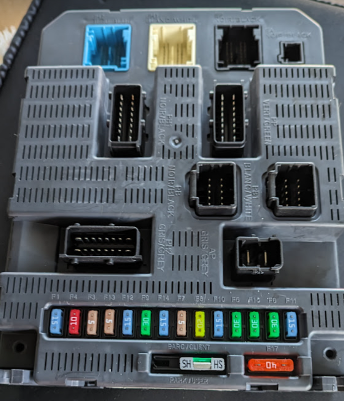

I posted today's findings on the C3 forum but I'll put it here as well in case it is helpful for other people with similar issues.
Today I spent several hours removed the battery, BSM and ECU so I could access and clean the grounding points on the inner wing below the BSM location. Refitted it all and did a BSI reset. Result was same as before. Only side lights come on, no engine turning when I turn the ignition key.
The car is in eco mode.
I checked the ECU and PS modules were grounded. Both ok.
I then pulled each fuse in the BSM, checked it and tested the viltage supply at each fuse. Strange results.
With ignition on:
F1 12.5 volts live side and 7.2 volts the other side but that gradually diminished to 0 volts a bit like a capacitor discharging
F2 0.1 volts live side 0 volts opposite side
F3 12.5 volts live side 0 volts opposite side
F4 5 volts live side 11.35 volts opposite side
F5 5.13 volts live side 0 volts opposite
F6 12.5 volts live side 1.1 volts opposite
F7 12.5 volts live side 0 volts opposite
F8 12.5 volts live side 0 volts opposite
F9 12.5 volts live side 0.9 volts opposite
F10 1.6 volts live side 0 volts opposite
F11 3.5 volts live side 0 volts opposite
F12 12.5 volts live side 0 volts opposite
F13 12,5 volts live side 0 volts opposite
F14 12.5 volts live side 0 volts opposite NO fuse at this location
F15. F16, F17 and F18 0 volts both sides
Pulled the black plug with grey and yellow wires
12.5 volts one terminal and 11.3 volts the other
I'm out tomorrow but will fire up Lexia when I get home and see what info is available.

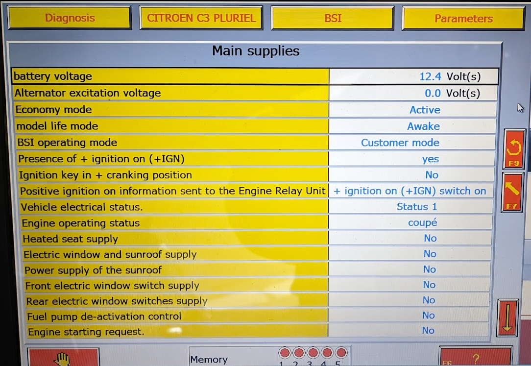

I've checked the fuses again leaving them in place. Checked with ign ON and OFF.
OFF ON
F1 13.1 12.5
F2 0 0.1
F3 13.1 12.5
F4 0 5
F5 0 5.13
F6 0 12.5
F7 0 12.5
F8 13 12.5
F9 0 12.5
F10 0 1.6
F11 0 3.55
F12 13 12.5
F13 0 12.5
F14 NO FUSE
F15 to 10 0v
ECU
Resistance at G4 and H4 Brown connector 0 Ohms
Volts at M2, M3 Brown connector 0 Volts
Volts at C3 Black connector 0 Volts
Volts at A1 Grey (not Green) connector 10.6 Volts
Continuity betweem pin 5 of the black BSM connector and ECU M2 is good, 0 Ohms
Grounded BSM black connector pin 9 and heard relay click, checked at ECU M2 and have 12.5 volts
Tried engine start - same, no turnover.
Connected Lexia and cleared existing codes
Exited Economy mode in BSI
Ran diags again and still have no coms with ECU and no chat between ABS and PS.
