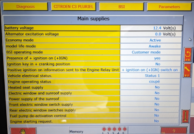

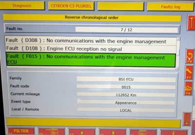

So I connected Lexia, which showed up 157 fault codes including no coms with engine management, absense of +permanent on the display, power steering faults, abs faults, ecu reception no signal and also two unknown faults that showed the odometer reading at 262140km when in fact it 112652km.
I've taken photoes of the Lexia displays but think they may be too large to upload here.

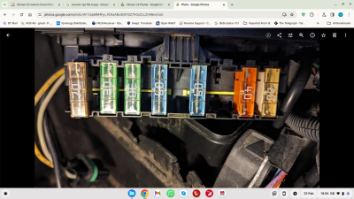

The battery is nearly new and I have pulled, checked and tested all the fuses in the engine bay and the interior fuse holder.
Tomorrow I will do a another bsi reset and try to start the engine. Will then connect Lexia and grab some screen shots to post here.

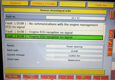

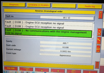

OK, I pulled every fuse and checked continuity with a multimeter. I also dismantled the engine bay fuse box and checked all Maxi fuses. All ok.

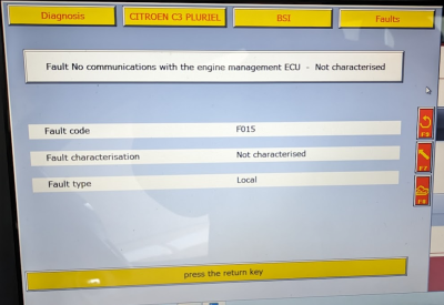

Here are copies of screenshots from Lexia

These are the codes left after erasing all fault codes in Lexia except these that couldn't be erased.
I then tried to start the car but same problem, I turn the ignition key and the engine does not turn over. Battery is fully charged.
Could the immobiliser cause this?

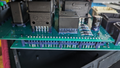

AllanA
- Posts: 42
- Joined: 07 Sep 2022, 11:05
- x 5
Re: C3 Pluriel Electronic nightmare!!

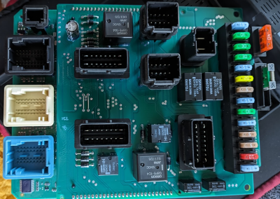

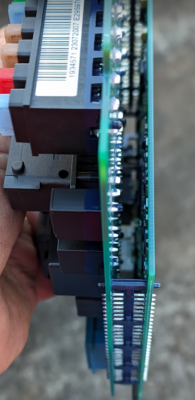

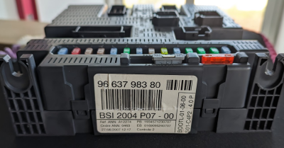

Some BSI pics showing the two boards soldered together not pressed together as in the earlier Pluriel model
Being a 2007 model, your electrics are 'all CAN'. CAN BUS is the protocol that the ECU's use to talk to each other. Previous models had a mixture of CAN and VAN BUS. That's why your BSI is different.
The BSI, ABS and the power steering ECU's are all complaining that the engine ECU is not talking to them.
Until the engine ECU is unlocked the starter wont engage. So that's normal given the circumstance.
Either the engine ECU is not working or the CAN BUS connection is cut.
Typical failure mode is moisture getting into the ABS connector and corroding the contacts. The CAN BUS to the engine ECU "piggy backs" off the ABS connector.
If that all looks ok then you will need to see if the engine ECU is getting power and ground.

Tried engine start - same, no turnover.
Connected Lexia and cleared existing codes
Exited Economy mode in BSI
Ran diags again and still have no coms with ECU and no chat between ABS and PS.
