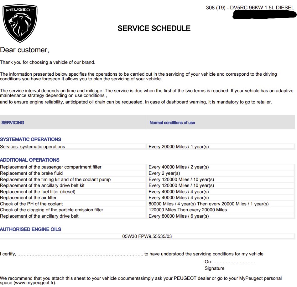

The article says it affects 1.5 hdi engines from December 2019, does this mean our 308 1.5 hdi registered May 2019 is not affected ? The service info provided when the car was new says to use 0W20 or 0W30 oil to the right spec and the dealer has been using 0W30 according to the receipts. I had been thinking of doing my own servicing now it is out of any warranties but may stick with the Peugeot dealer if there is a chance of the engine being damaged.

Here is your service schedule that shows this change Paul (I've blanked out your VIN):New after-sales recommendation
If the Stellantis group made modifications to the engine at the beginning of 2023, no technical measures have been taken for vehicles already in circulation. In order to avoid premature wear and the risk of chain breakage, manufacturers have recommended since January 2024 the use of a 5W30 oil (instead of 0W30) in order to solve the cold lubrication problem. All vehicles produced before February 2023 are affected.
Click Image to Zoom

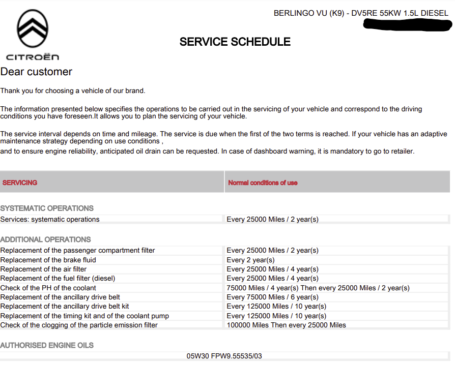

could you supply me with my service schedule for VR7**************[VIN obfuscated, can be read by forum staff] thanks
- x 6957
Re: oil spec
Here you go Walt:
