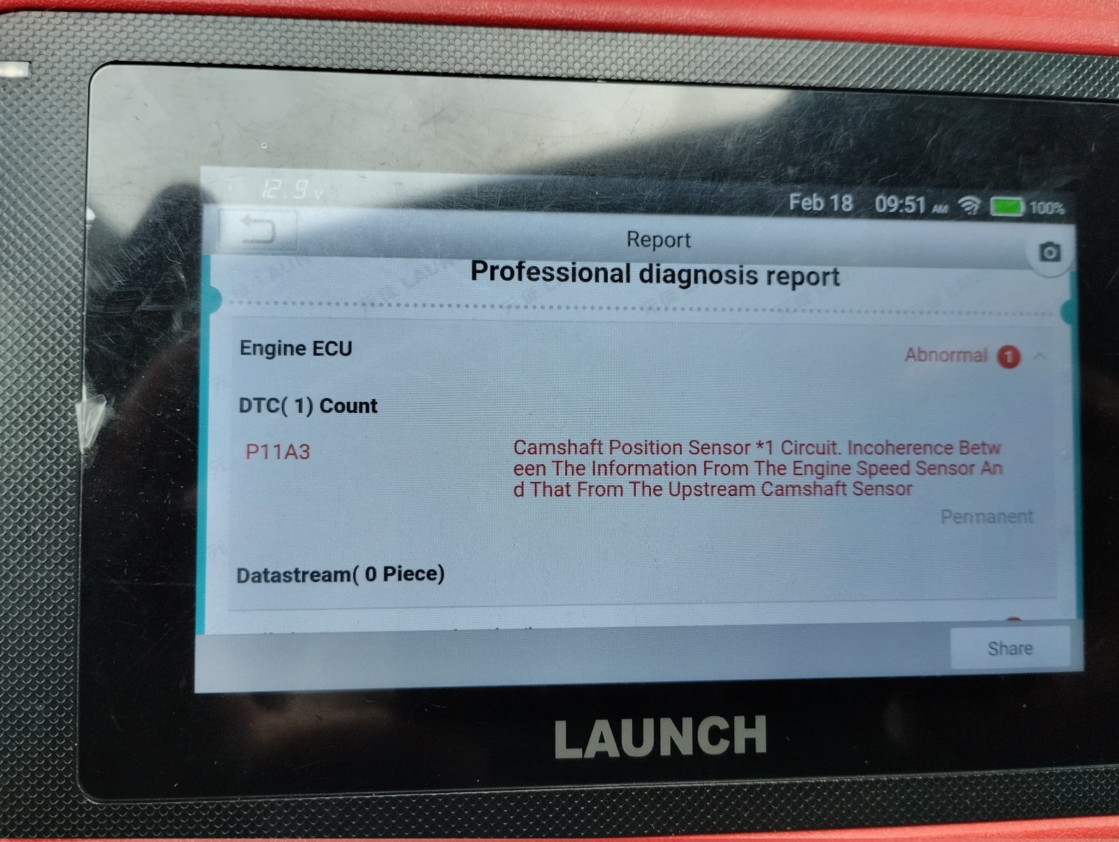

This code and the text in the attached pic popped up this morning, car seems to drive normally.
What should be the protocol for this code?

Fault Code: P11A3
Description of Fault: Fault in the exhaust camshaft dephasing: Incorrect setting of the exhaust camshaft. Discrepancy between the adaptation value initialised in the cycle for the fault appearing and that initialised previously for the exhaust camshaft dephaser higher than a threshold.
Conditions of activation of the diagnostics
- ECU initialisation: The adaptation value for the exhaust camshaft dephaser is read in the ECU. This value used for defining a range that is acceptable in the next adaptation
Conditions for Fault to clear:
  • Delete the fault, using the diagnostic tool
Downgrade Modes whilst Fault is active:
  • Deactivation of the canister purge function
  • Possible deactivation of the hill start assistance
Symptoms:
  • Starting impossible
  • Stalling at idle
  • Lack of power
  • Timing: Restarting impossible
Suspect Areas:
  • Camshaft dephasers stuck
  • Insufficient oil pressure
  • Circuit blocked/frozen
  • Valve timing may be set incorrectly

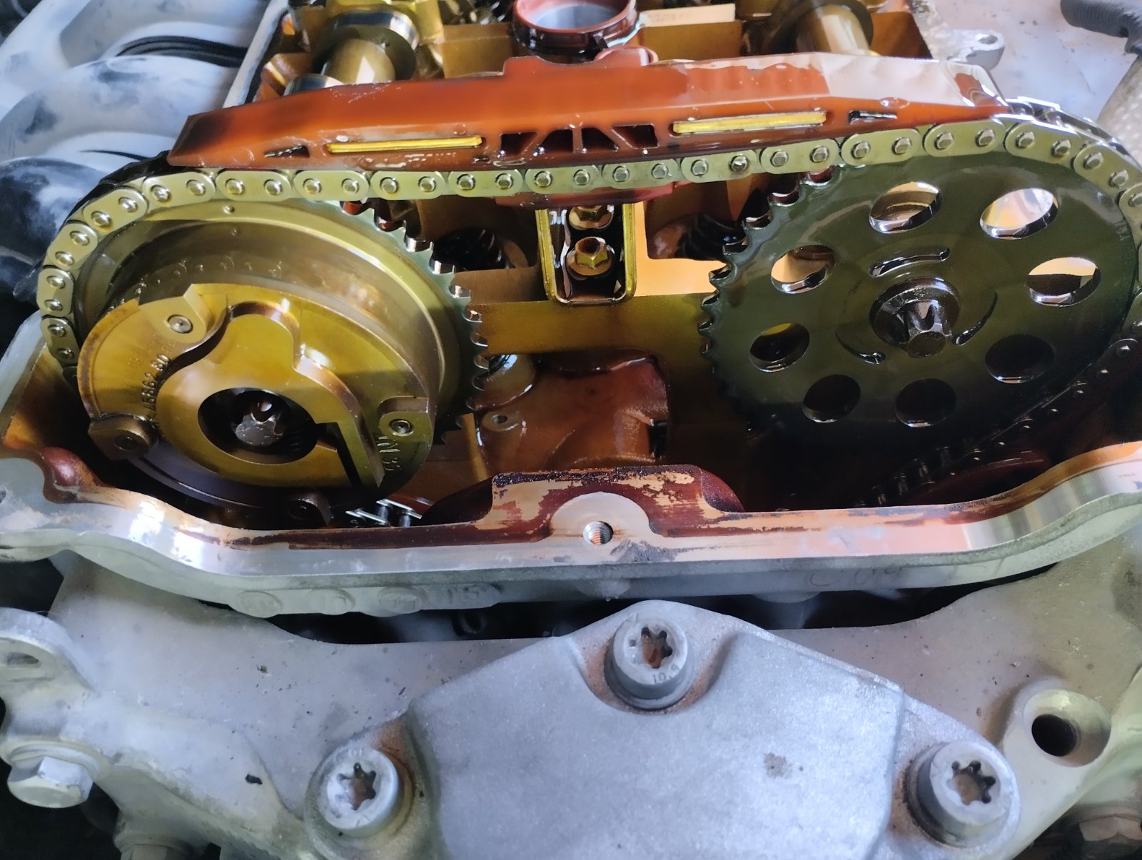

Thank you, actually non of the symptoms is occurring 🤔 and i changed the tensioner (just as maintenance ) a few months ago and it drove about 7k to date.

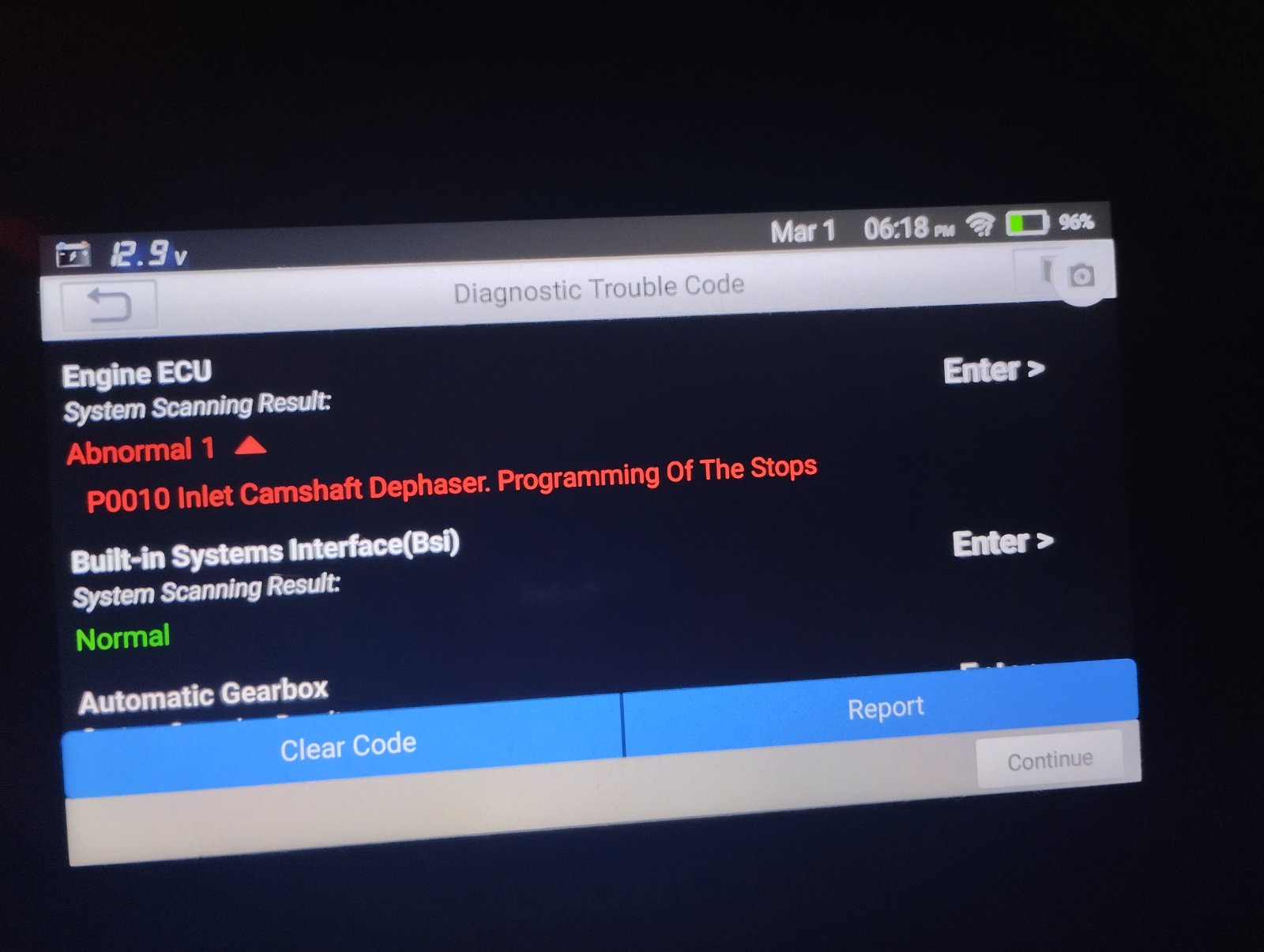

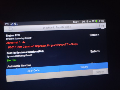

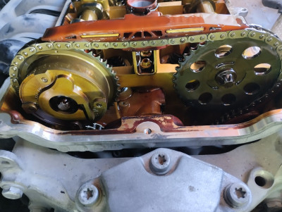

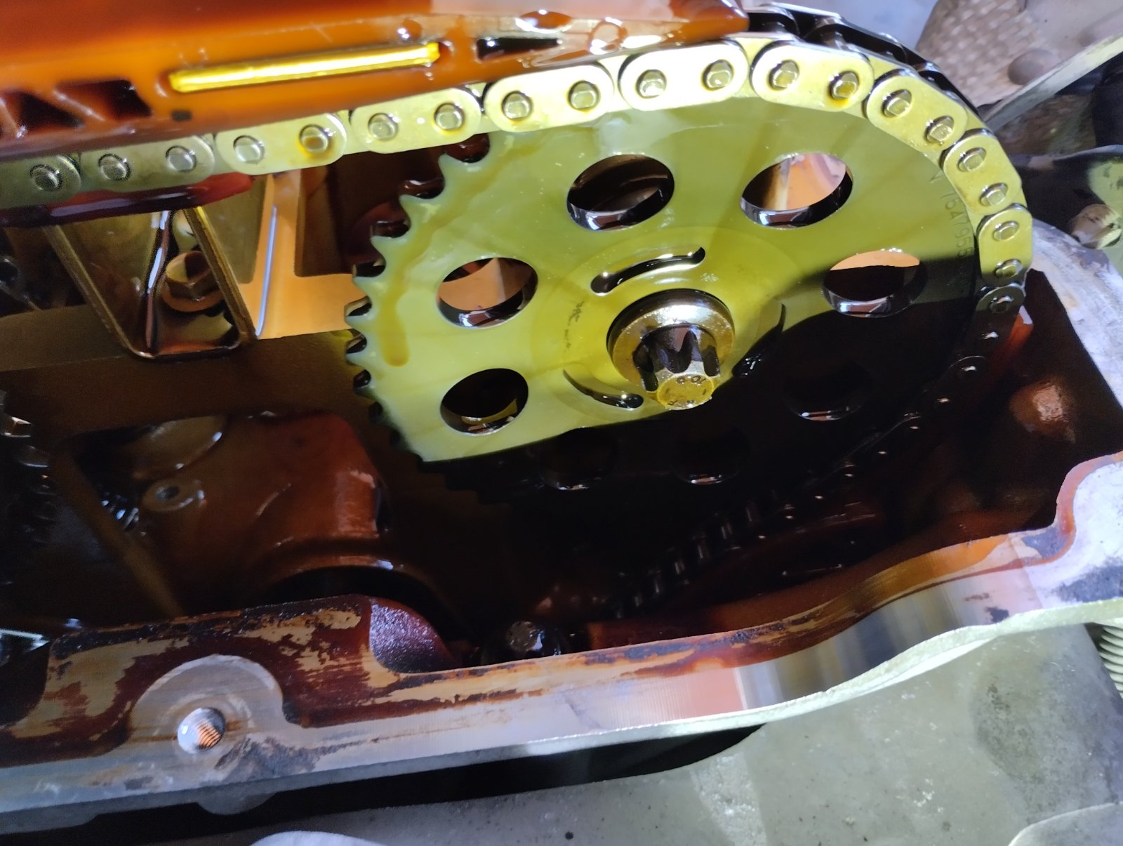

Well, i replaced the vvt solenoid and the code went off as well as the "check engine" light however, a scan picked up a new fault code - P0010 (dephaser somthing...) - again, the "check engine" dash light is off and the ride feels ok.
So, what does the P0010 stand for?

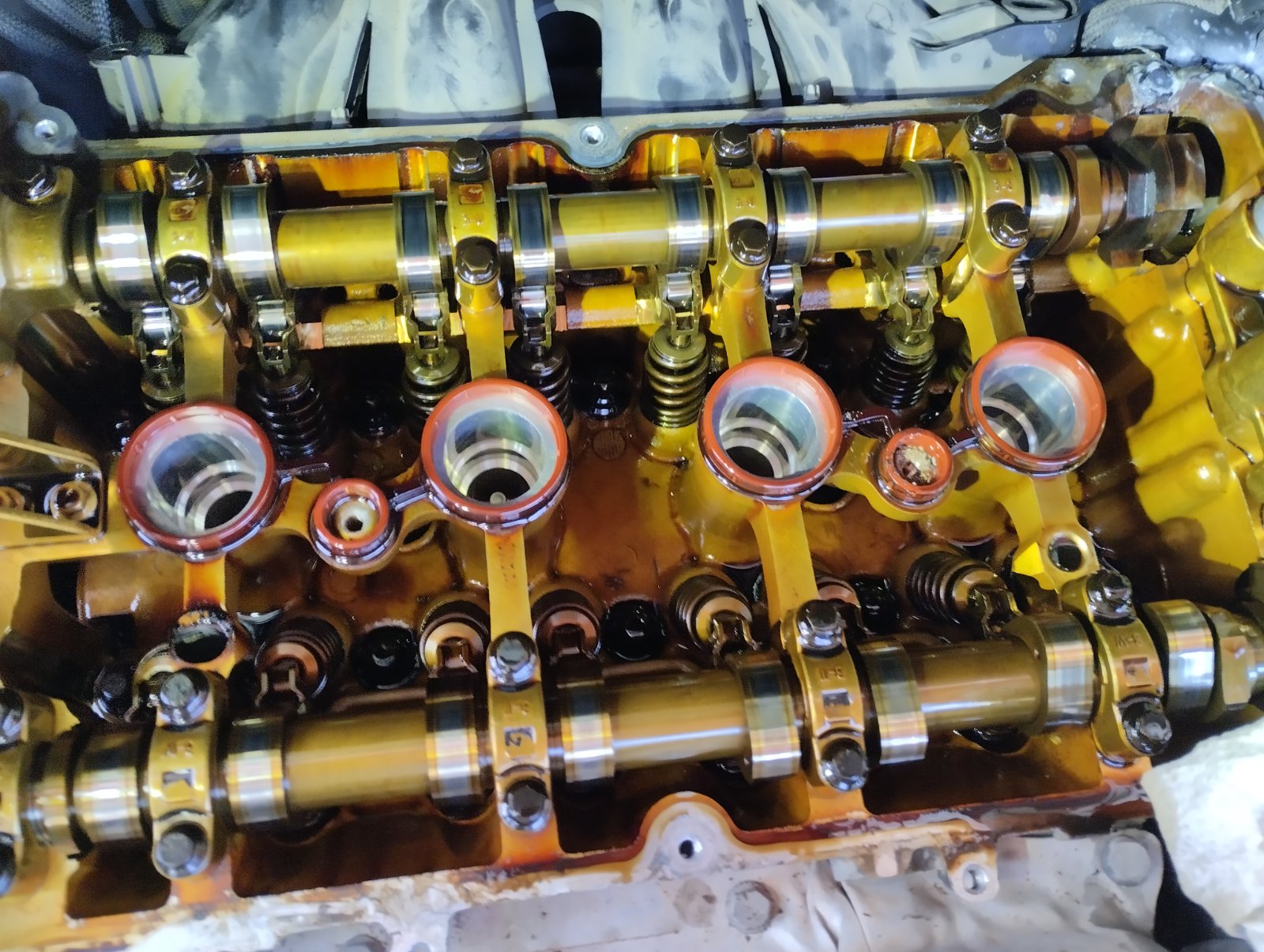

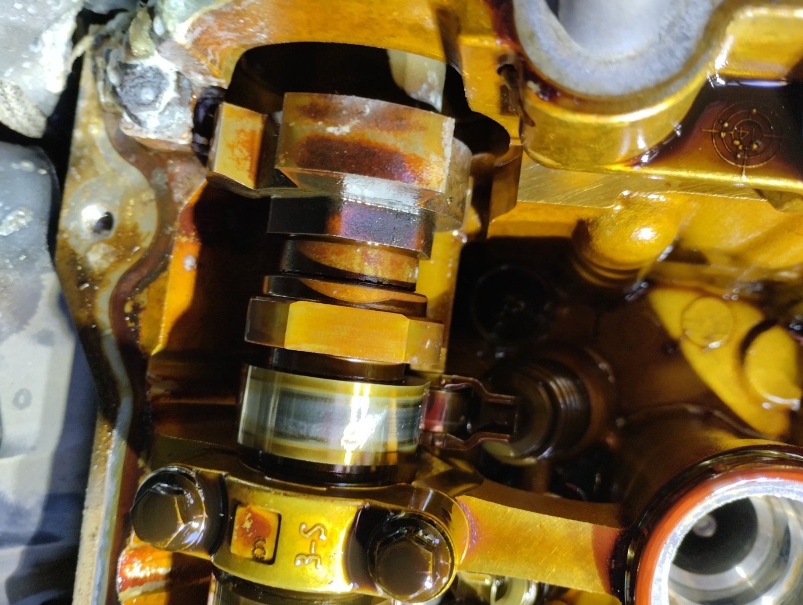

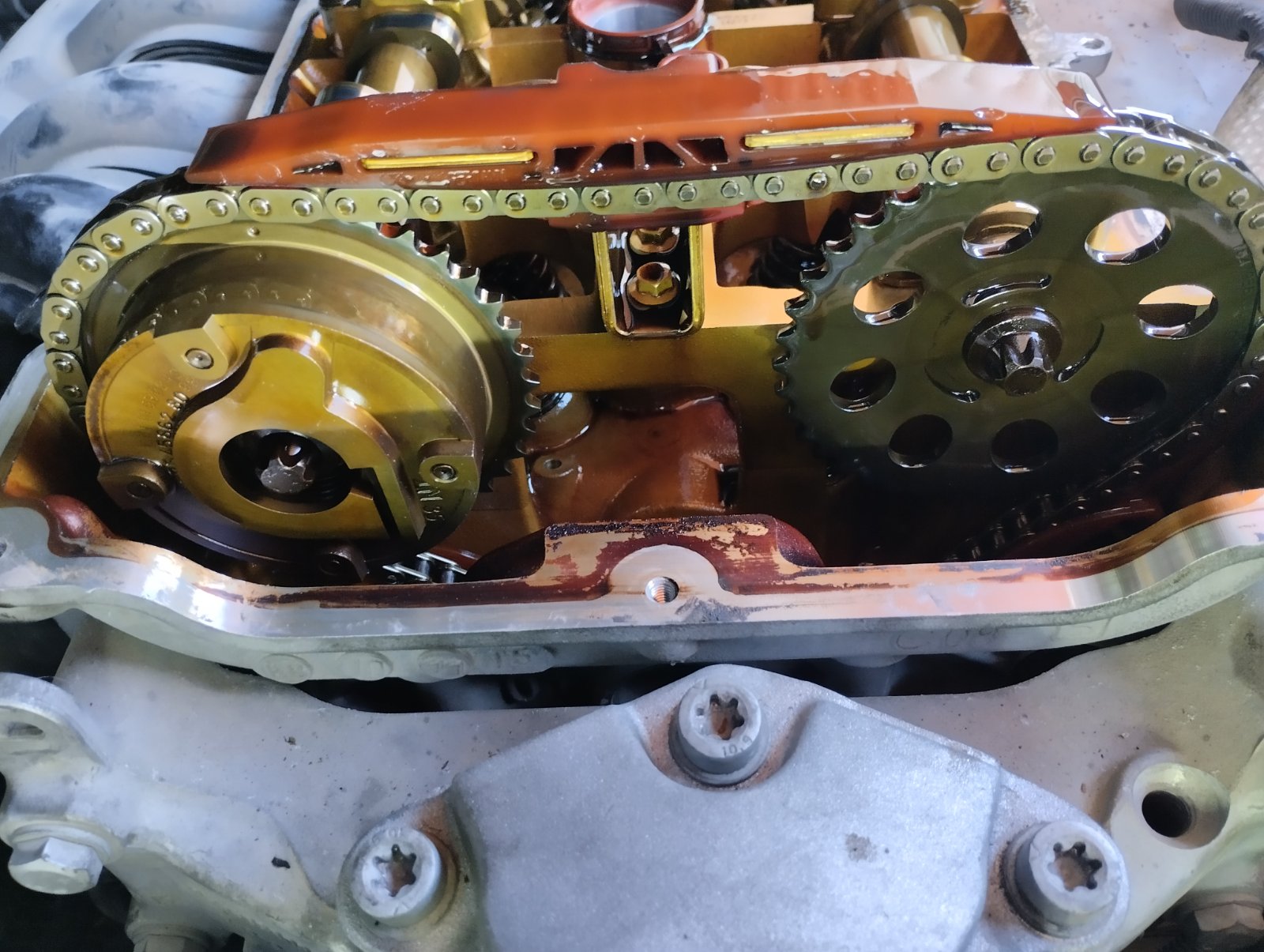

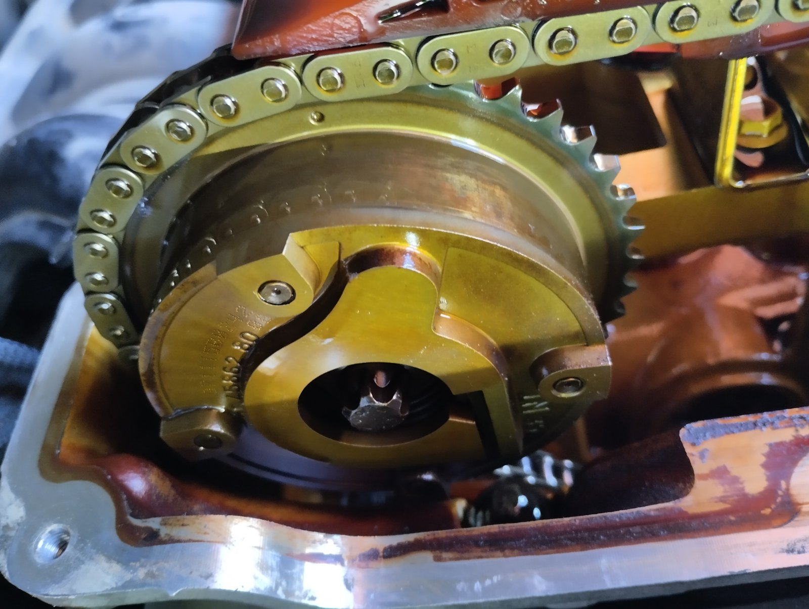

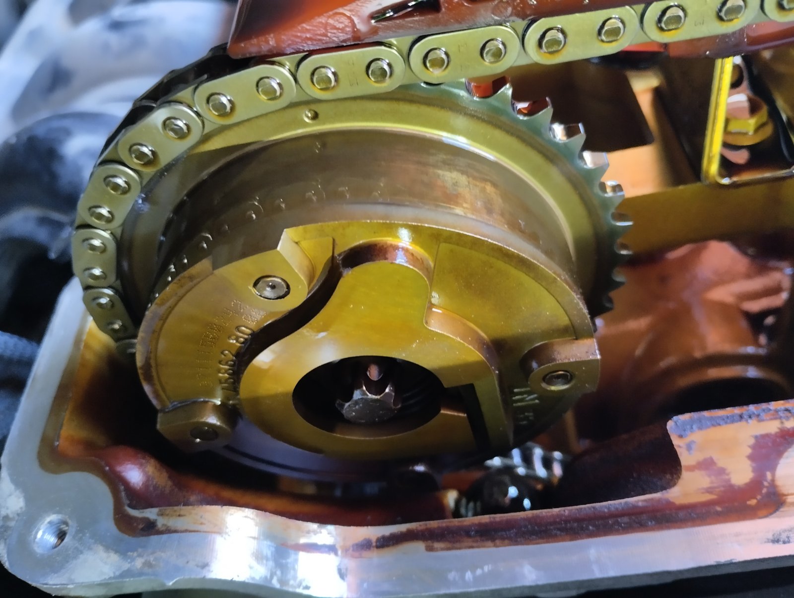

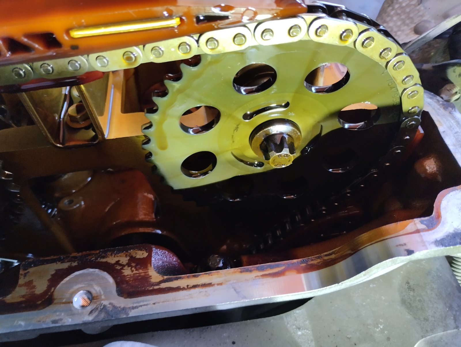

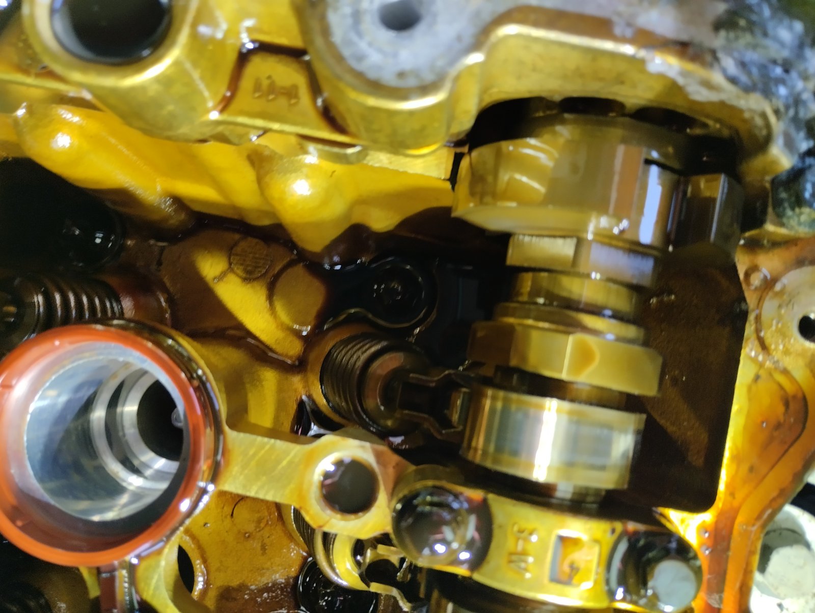

I checked the timing chain, seems solid (see pics) and the tensioner seems ok as well (it drove only 7k km) so do the timing cahin bracketa and the camshafts 8-[

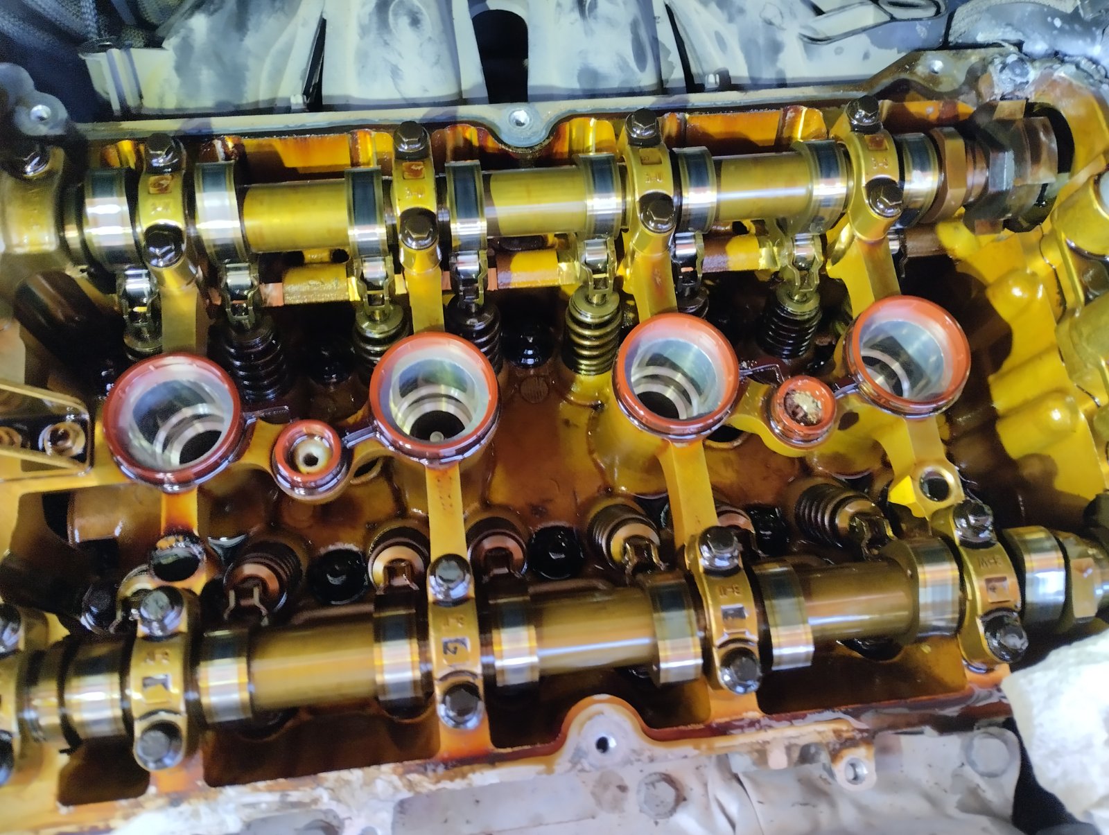

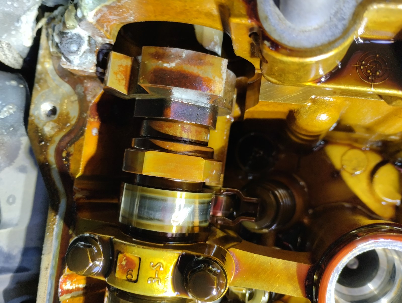

Concurrent with my post on P0010-00, as per now, the VVT replacement seems to be the solution
