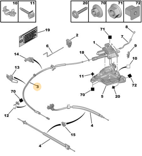

First off is the electronic parking brake. I've read that these can be a problem so how do they actually work please?
I assume that there is some kind of servo motor which winds the caliper on?
Honestly, I have no idea as I've not even looked underneath yet.
It sounds a bit noisy so just thinking I could strip down calipers, clean and lubricate necessary areas. Watched one video on YouTube last night where the brake pads were seized in the caliper which simply got me thinking how do these electronic parking brakes actuate.

On this model you have an electric unit that just retracts and releases the handbrake cables to the rear calipers. The handbrake is automatically applied when you switch the engine off and can be released by either releasing it using the switch or by pulling away.
Before you get too carried away, be aware that before you undertake any work on the brake pads or calipers that the EPB must be put into service mode AND remove the battery negative cable, so that it cannot automatically apply itself and potentially remove some fingers whilst working on it. This needs to be done to ensure that the cables are slack enough to allow any related work to be done. You'll need Diagbox to do this or PP2000.

If I've read the correct posts it would appear that the super expensive motor unit is housed within the internal compartment and is unlikely to give much trouble though it has a service life cycle!!! Some models I read about X7 2008 has around 100000 application / release cycles in it.
If the 3008 has the same system or, at least an iteration of it, I expect that it will need replacement at some point.
My Lexia will be too out of date to read this vehicle so will need to get a full chip one with the gold edges on the PCB I'm thinking.
Read a post where RichardW says the cables are cheap. Is was thinking perhaps replace the cables and clean up calipers to ensure stress on the motor unit is reduced to a minimum but if they simply stop working after so many cycles is it even worth bothering trying to prevent?

Power unit is under the passenger seat, and yes they are a bit noisy. Cables last at least 10 years and don't break the unit, so there's no real need to worry about them if working OK. The switch can break if you're heavy handed with it, but cheap and easy to replace. Smooth auto release on a manual takes a bit of practice - I like to lift the clutch slightly then blip the throttle to get it to release before actually trying to pull away.
