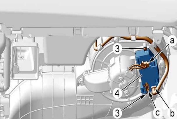

The blower motor control module should be under the dash on the driver side shown at (4):
Thank you for the blower motor diagram, ill get that checked at the weekend. Thank you once again.
