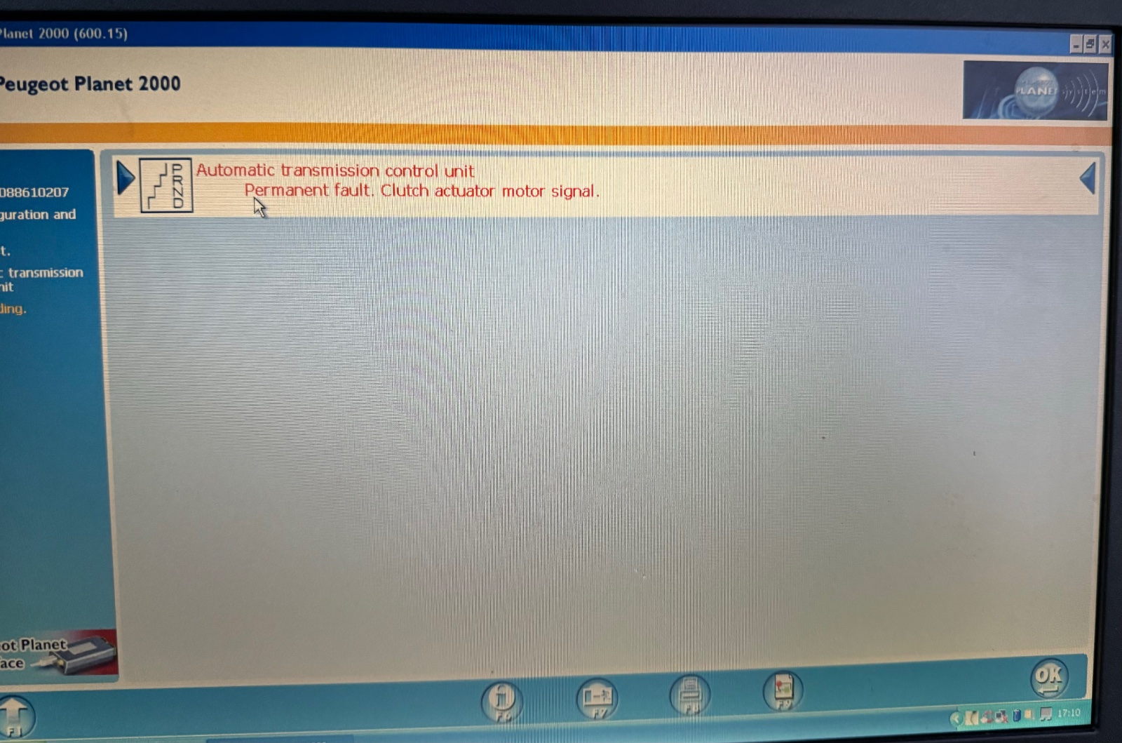

I recently bought a Peugeot 107 2 Tronic with a gearbox issue. I connected it to Peugeot planet and received the following error message:
"Automatic transmission control unit
Permanent fault. Clutch actuator motor signal."
I have already replaced the actuator with a known good one, as well as the gearbox relay and checked all the fuses. However, the same fault persists. Additionally, when I run a gearbox actuator test, it shows as successful but none of the actuators actually move.
I would greatly appreciate any assistance or advice you may have.
Thank you!

No, the car doesn't drive at all. It's unable to select gears. In the past, I have programmed many of these cars without any problems. However, when attempting to put the clutch actuator into service mode, it doesn't respond or move.
