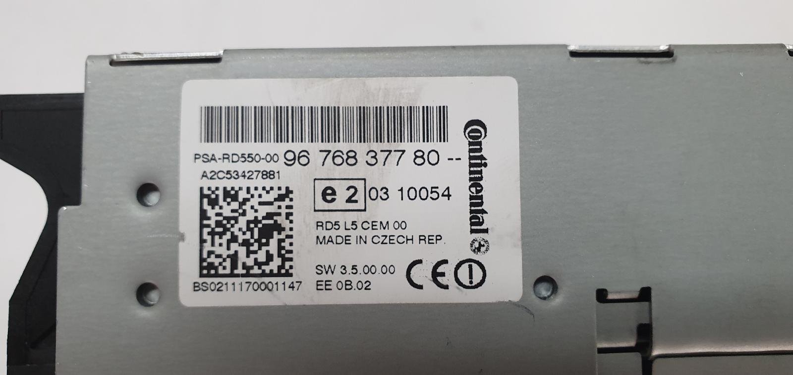

Ok, got it, yes I often forget these as most of them were integrated into the fascia like on the DS5 and 508.
For these, there are no public software updates to these units released, so you will have to source a unit with a later hardware or software version, which you can usually see on the back of the units. Take this one that has obviously been updated at the dealership or after refurbishment.
Although this one is a L3 unit, it has been updated to software 3.8.01 and they have covered up the old software with a label to show this.
Older units were V3.4 or V3.5

Mm, it may not seem like, but that doesn't sound like a completely bad hint :!: (maybe)
Sticker = update. Sticker version = updated = theoretically could be better :idea: // The question is whether it solves the music quality problem over bluetooth.

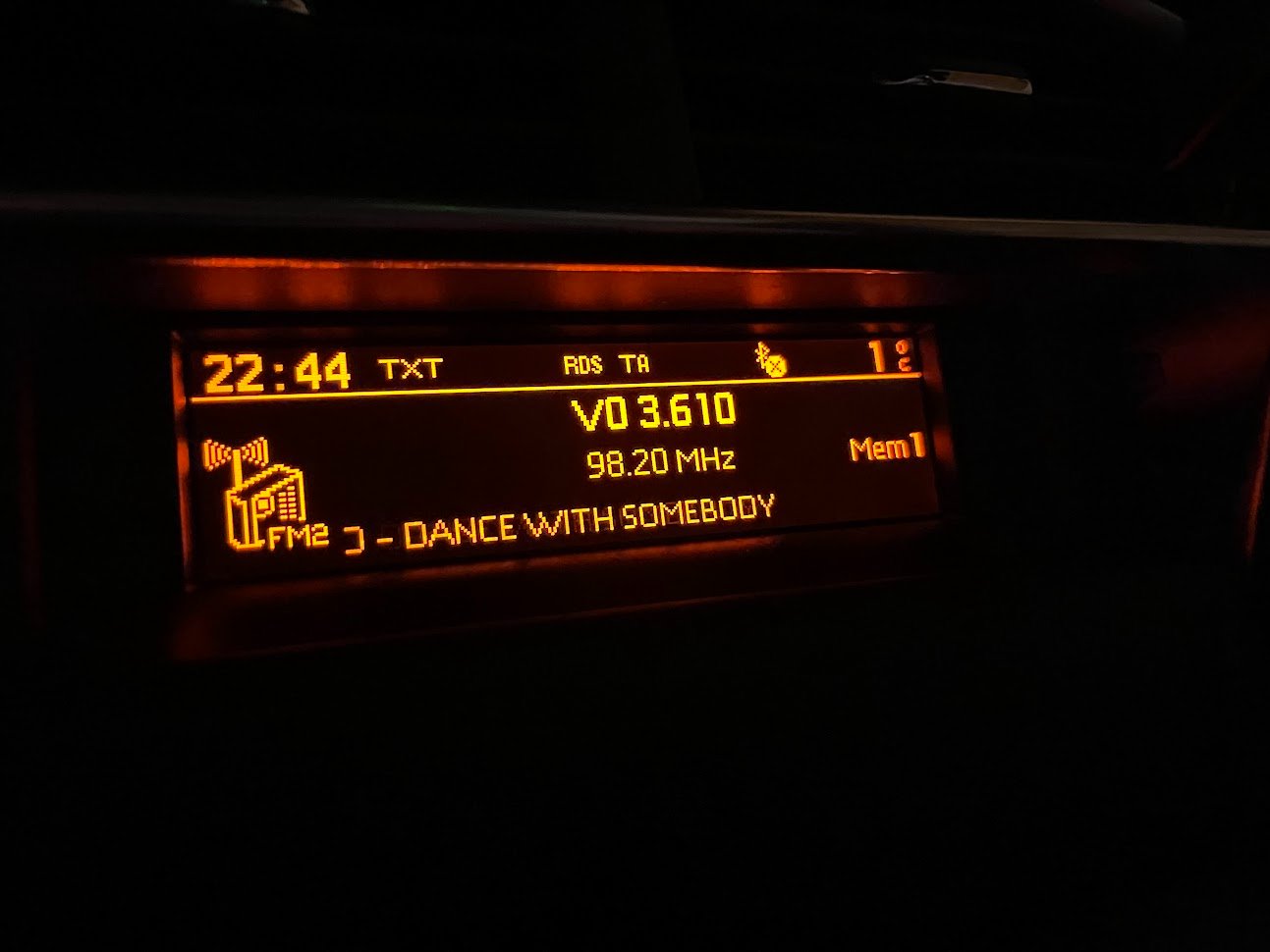

I just found a unit with newer software than I have. Mine has 3.61 on it, I found 3.81 for "a few pennies" (still cheaper than chinese external cable with ugly buttons and blue lights and bleah...) It's worth a try...! Just ordered...

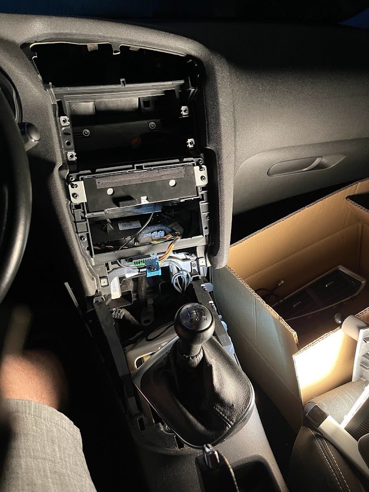

I was curious and excited, so before the DHL brought the package yesterday, I removed everything from the car, including RD5 version 3.6.01 to be prepared.
In the afternoon the RD5 L5 version 3.8.01 arrived, which I installed, recoded, changed the VIN (...and removed CD from it - it came with Liam Gallagher's album inside :-D)
The sound via bluetooth has great sound, perfect bass, mids and highs. But compared to other sound sources, the highs are still a bit fuzzy. So again not good :cry:
Maybe it seems a bit better (objectively) and at the same time I think (and maybe it's the reason why there are not much more angry people) a lot of people who, for example, listen to other genres, won't even notice it, but I think I'll just resign myself #-o to having a little bit less elegant bluetooth-aux solution (I have already prepared something :| )
