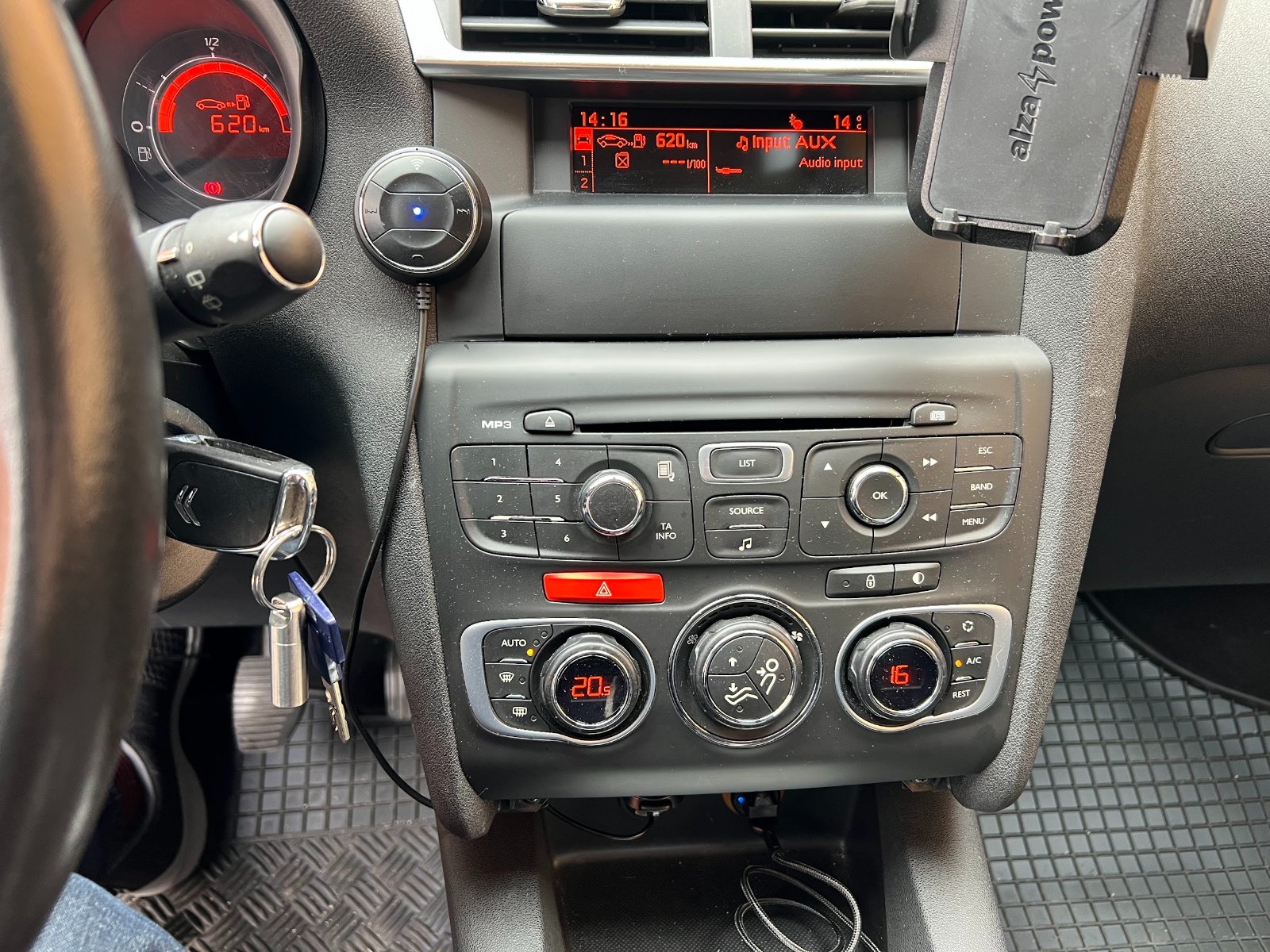

z_ds
Posts: 5
Joined: 10 Jan 2024, 22:57
x 2
Re: C4/DS4 II - RD5 L5 radio - poor music quality via bluetooth
Unread post by z_ds »
Hi, sorry for delayed answer.
In the end I tried two versions od RD5 LD5, I tried searching and fiddling with some parameters related to the radio in the Diagbox, but the quality of the music (in my case electronic) was the same (bad).
I didn't try to play with different bluetooth standards on the phone, but that's something that wouldn't be effective in practical use anyway (tried default settings on iPhone and Samsung). So the only benefit from the upgrade is USB (I am not using).
I didn't go on an adventure with the RT6 RNEG (I'm not sure of the name now, I mean a radio with a touchscreen a class higher), I couldn't find one even for an acceptable price.
The chinese android 2DIN devices is something what is not the way IMO.
So I ended up like in the attached photo. Actually, you can get used to it :) (one cable down and it could be quite acceptably hidden under OBD cover - not present on the photo) But of course it is sad that PSA provided such poor equipment at the time.
