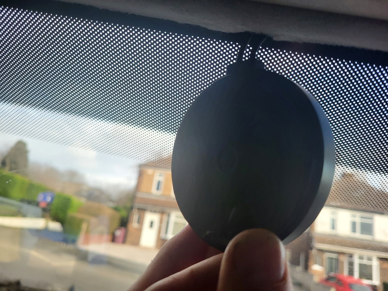

I have the display along with radio I bought from same vehicle just wanted to sure about microphone? in case it affected or interfered with the install
Pic attached of microphone pretty much identical to what is sticking out of A pillar
Thanks
Thanks

I don't think that is a PSA microphone.
There will be a place for a microphone above the panel between the sun visors. There will be a connector floating behind that, but the other end of the cable will be going to a (blue) socket for the earlier hands-free box somewhere behind the dashboard.

While I'm on does anyone know what the round black thing is at top of windscreen
Is that related to mic/bluetooth slipped my mind earlier

It's not shown as fitted Mike - checked VIN and no Microphone part listed for this vehicle, whereas some don't have the kit but include the microphone.xantia_v6 wrote: 31 Jan 2024, 23:08 I don't think that is a PSA microphone.

My understanding was that anything fitted with an RD4 is pre-wired for the hands-free module, which was a dealer upgrade. Maybe I was mistaken?
- x 6956
Re: Bluetooth radio upgrade
I know on loads of models I have checked, the part is shown and importantly listed to show the part number available under the VIN, but in this particular case, it has filtered the microphone out and is not listed with a part shown.
In many vehicles the pre-wiring was there, and the part number was shown, but not in this case, so just wanted to mention it before he tears the module down in case it is not there. This is a B9 Utility vehicle and we know that as these are configurable, so it may be one reason why it's not there.
In any case, it's my experience that they are generally speaking no good in any case, as most have a connection to a ribbon cable that disappears into the depths of the loom behind the dashboard, so can't practically be used, and many end up wiring in an independent microphone into the appropriate pin at back of the RD45 block, which is a lot easier.
@shawstvs: Which is another thing that black disc may be - have a look at the other side and see if you can find any holes which may indicate some body has wired in an aftermarket mic before.
